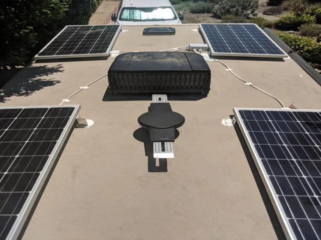

I think like 350-400W would be peak since they wrap a bit like you said. But that design also allows for a good 100+W during most daylight hours. Also has a spot to add more via a SAE connection on the side.
Another problem with flexible panels is they get HOT since there is no air able to travel under them. When they get hot, their voltage goes down so they almost have to be in series to use with an MPPT solar controller.

Thank you everyone for the reply. To clarify, this would be for a 31’ super lite trailer with bifacial Solar panels. I figured I could get 2k of panels on the roof, still confirming this with the company, and then would supplement with a portable fold out array I would store in trailer.
We have 1500W of solar on our travel trailer roof, and we use the excess to level 1 charge our Rivian. In a good month (not too hot or cold, plenty of sunshine, time to manage the charging) we can send 30-60 kWh to the truck. It's not much but it's something.

I think the main thing I see is that there are a lot of electronic pieces between the panels and the truck battery, all of them take energy, and the truck itself is quite inefficient at bringing in level 1 power. We used to have a Chevy Bolt, and charging from the solar panels made a real difference in adding miles. Not so much with the Rivian (and I don't think it's only the difference in driving efficiency). Again, better than nothing.
