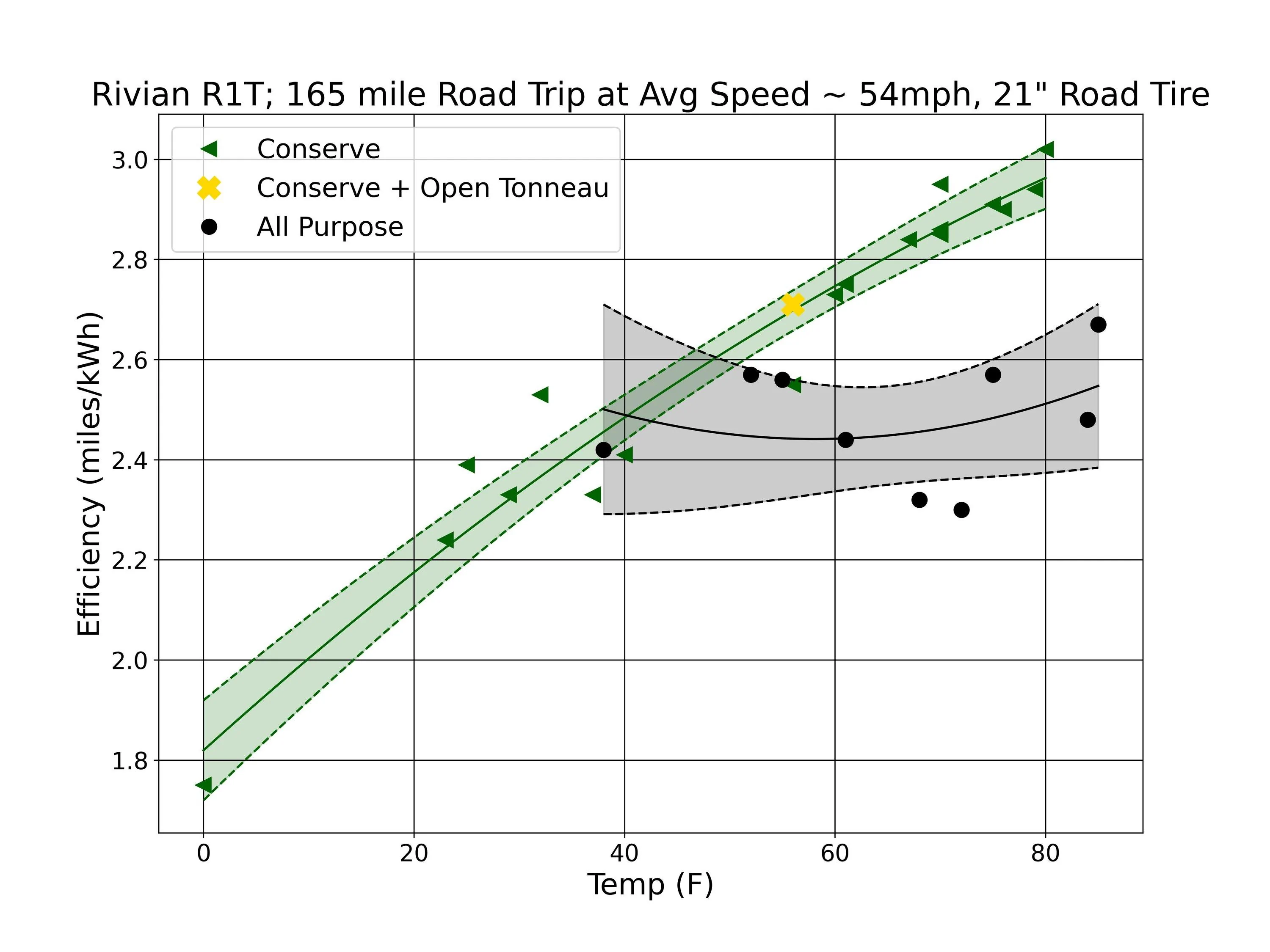

Where we at with this? We leave for Montana tomorrow and I'm debating ride mode and height. @zefram47 has me questioning low, and the temps have me questioning Conserve. We'll leave with a warm battery, headwind looks like 5mph, and temps will be 40°F +/-5.
I'm on 275/60R20 Wildpeaks with Ram 2363. My average has been 2mi/kWh so I'm somewhat concerned.
Hi

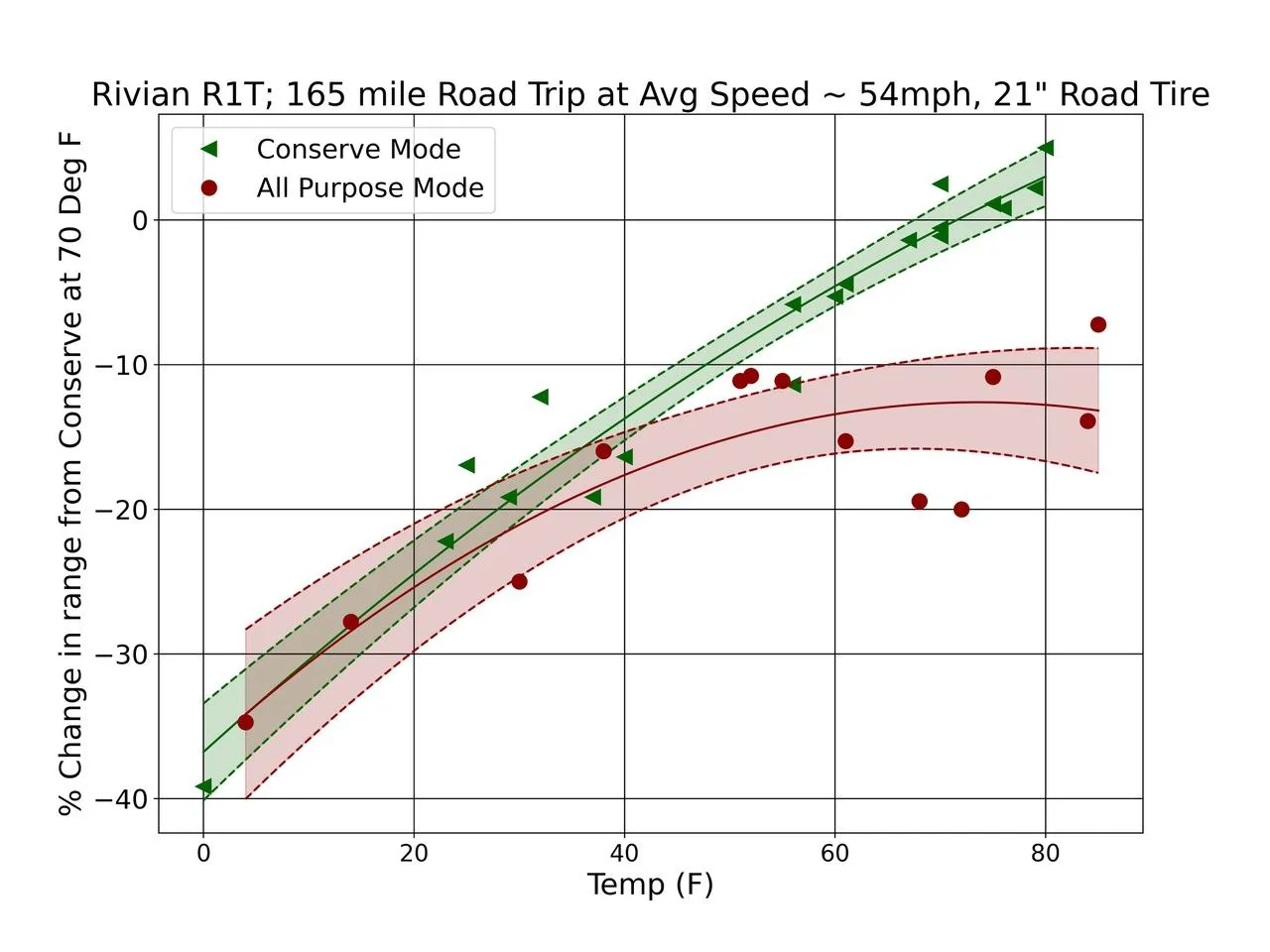

i know you found this update on another thread but I will post the update here for completeness. This chart is a bit different, it shows percent change with temperature. I’m hopeful that this will hold true across different traveling speeds. I personally think ride height has a pretty small impact on efficiency
Rivian R1T R1S Unexpected Conserve vs All Purpose Efficiency Behavior R1T percent change vs tem

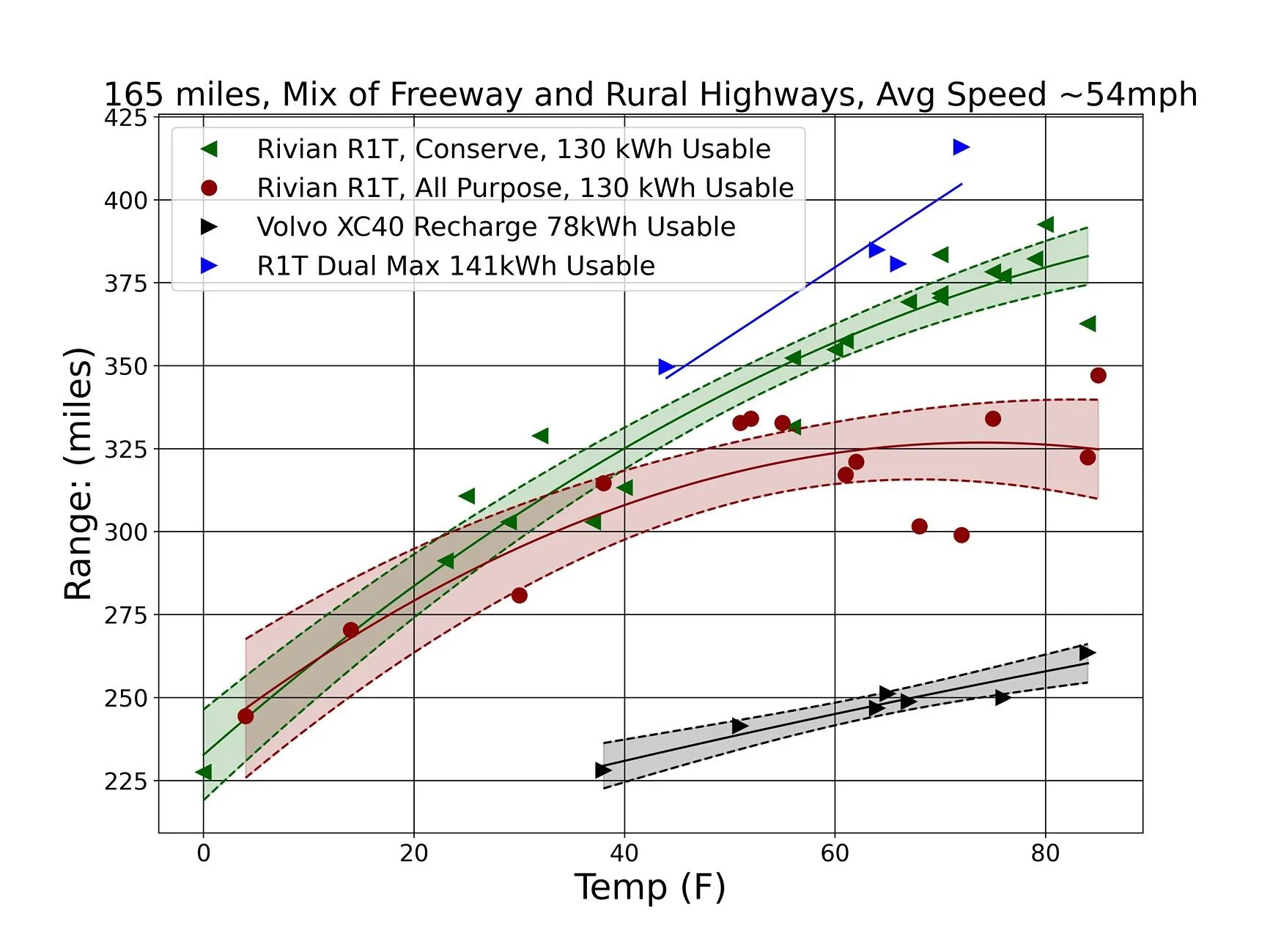

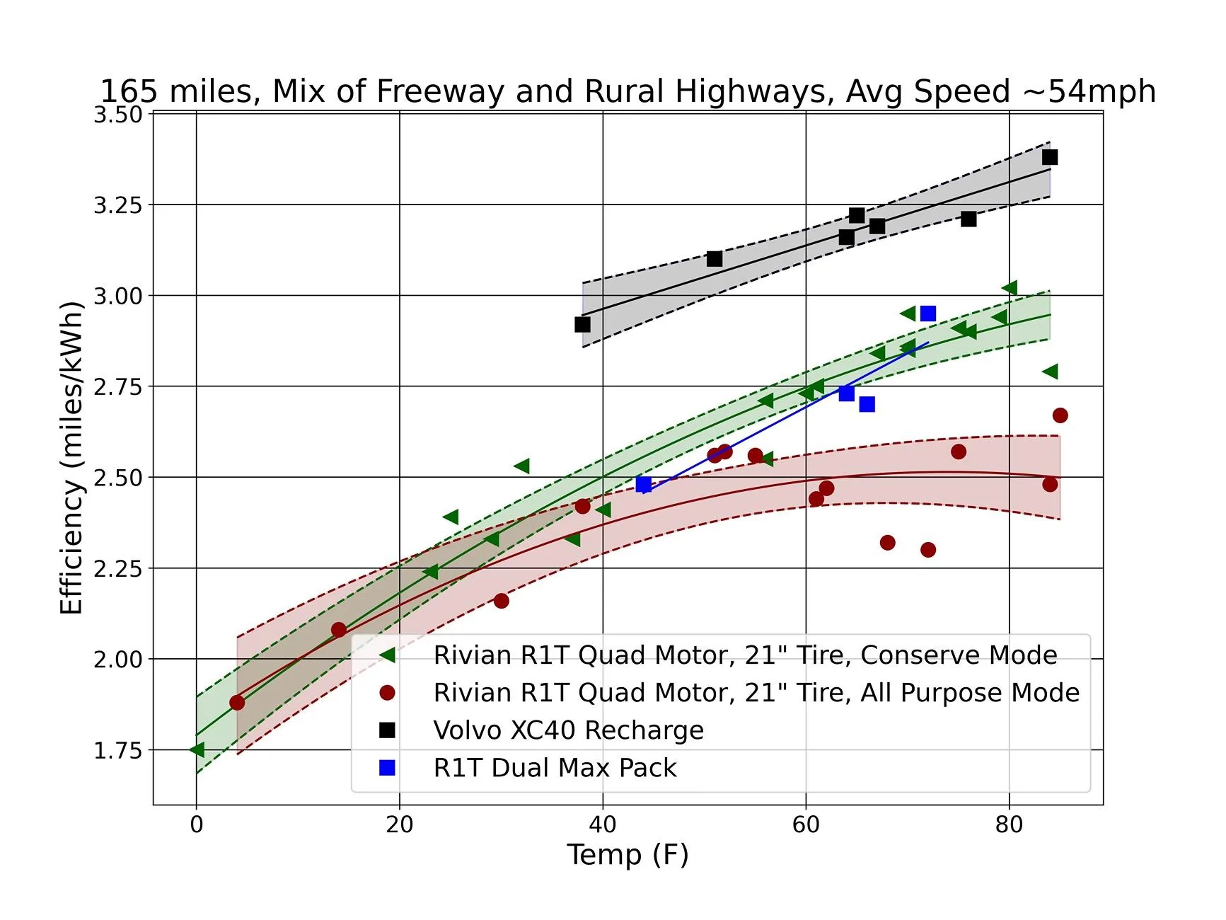

This observation has held up over time. With the Quad motor Rivian the conserve mode really only results in improved efficiency in warmer weather. I now have a dual motor R1T and so far that efficiency is very similar to the Quad motor conserve mode. I'm holding out hope the dual motor will actually have a bit better efficiency because so far I've only been able to collect data on pretty windy days. And on those windy days the efficiency has been pretty good. Maybe better with no wind?
Updated chart attached.
Rivian R1T R1S Unexpected Conserve vs All Purpose Efficiency Behavior R1T range vs tem
Rivian R1T R1S Unexpected Conserve vs All Purpose Efficiency Behavior R1T efficiency vs tem

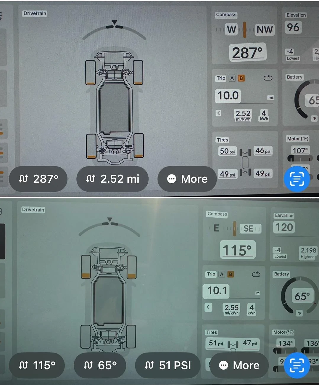

A piece of the puzzle (non-specific/generalized):
Rivian R1T R1S Unexpected Conserve vs All Purpose Efficiency Behavior IMG_0689
