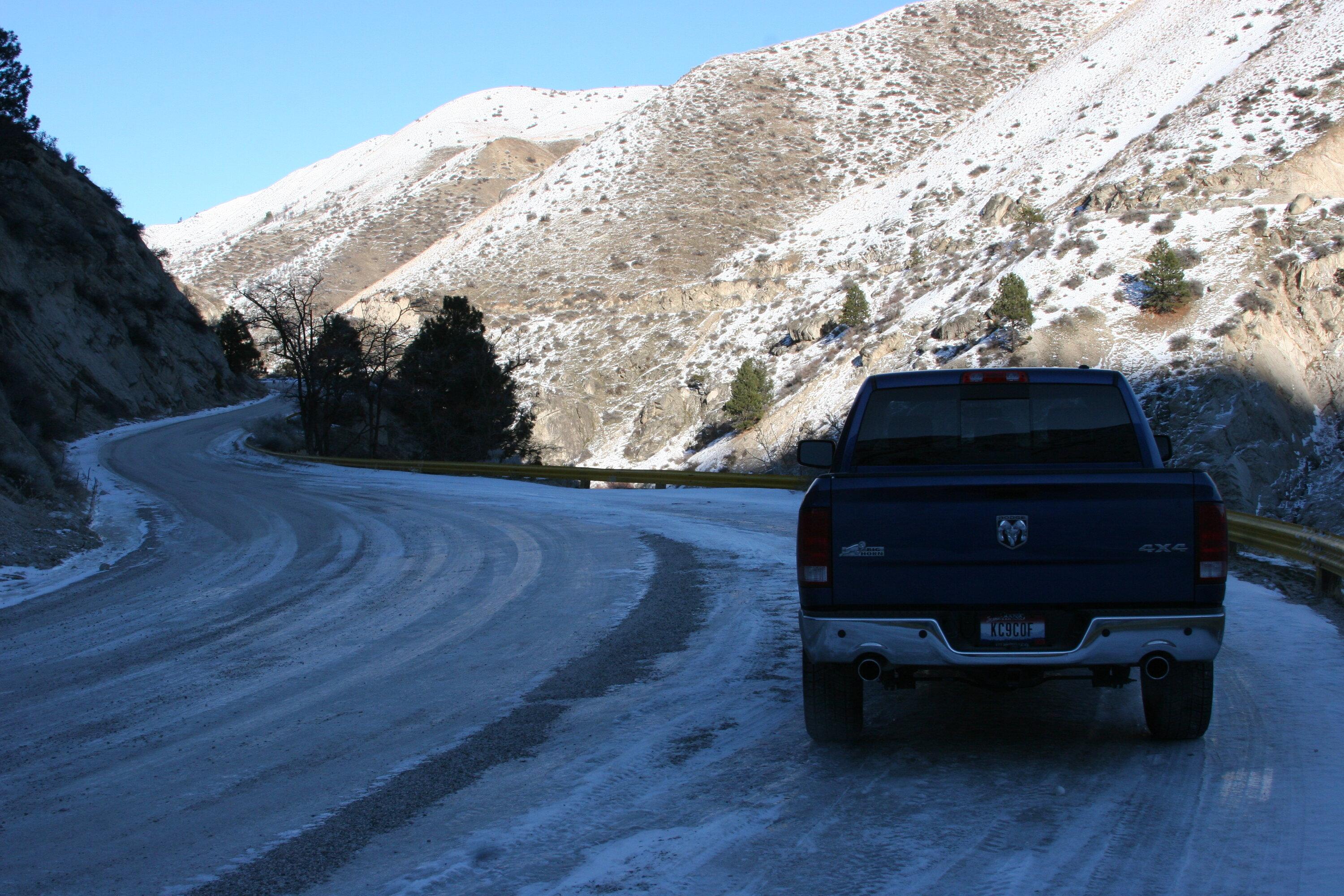

Because when you drive down an icy ass mountain road that's unpaved and has grade like this, you push in the clutch on a stick shift to maintain directional control and either pulse the brakes or usa abs.
Modulating that is hard. There are simply some cases where coasting is best.
