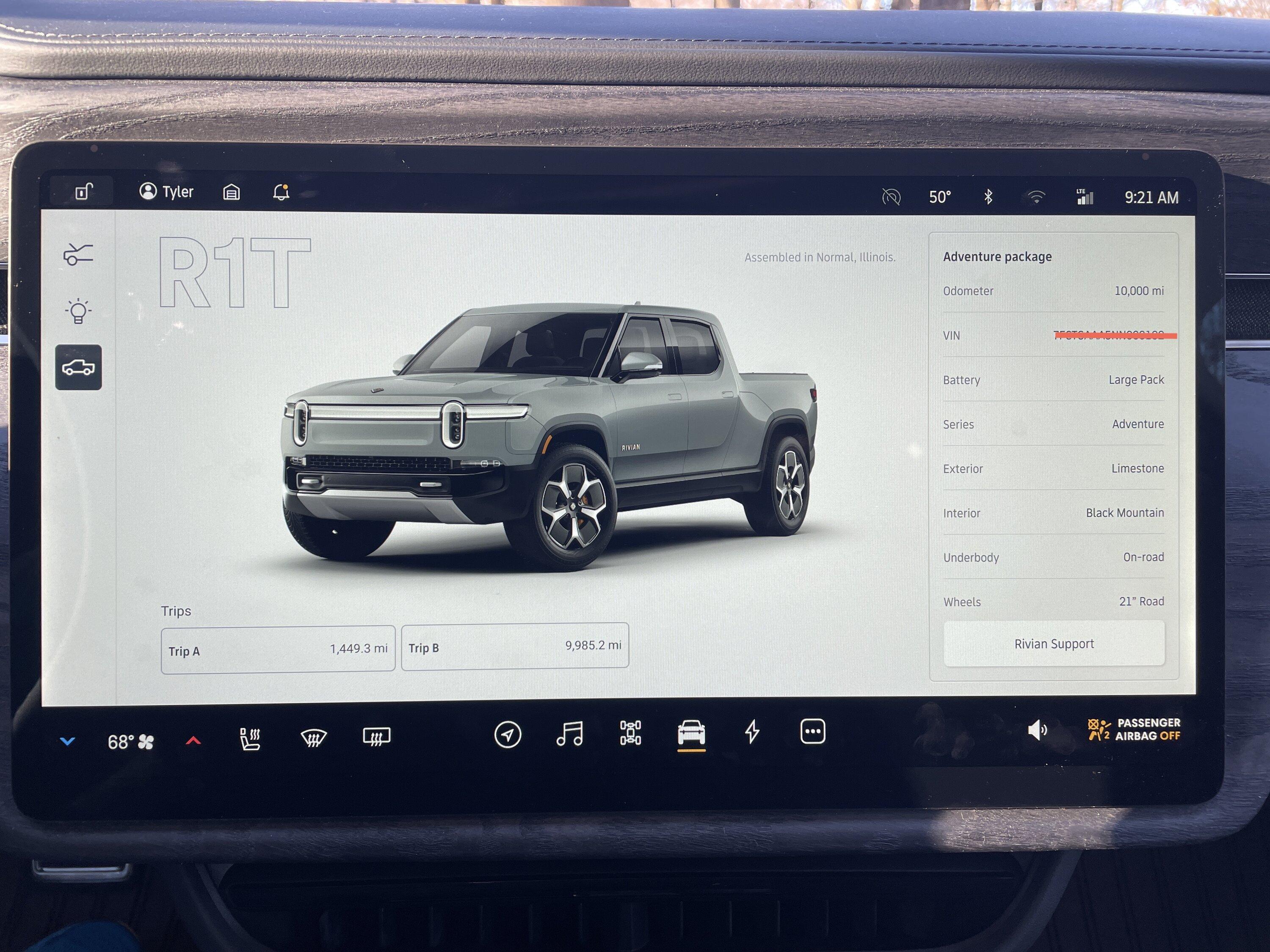

We just crossed 10K Miles in the R1T! We took delivery around Memorial Day, so 6 months. A few service items but, overall, smitten.
I did my first tire rotation this weekend, rotating in the full size spare. These are my measurements with tread/brake pad remaining so far after 10K miles.
21" Road Tires (Pirelli Scorpion Verde)
Spare (brand new, unused): 12/32"
Rear Tires: 10/32"
Rear Brake Pads: 10mm
Front Tires: 9 to 9.5/32"
Front Brake Pads: 9mm
This is 10k miles of casual everyday driving, with a sprinkle of max acceleration here and there (good for the soul). Additionally, about 2,500 miles have been with a light trailer in tow.

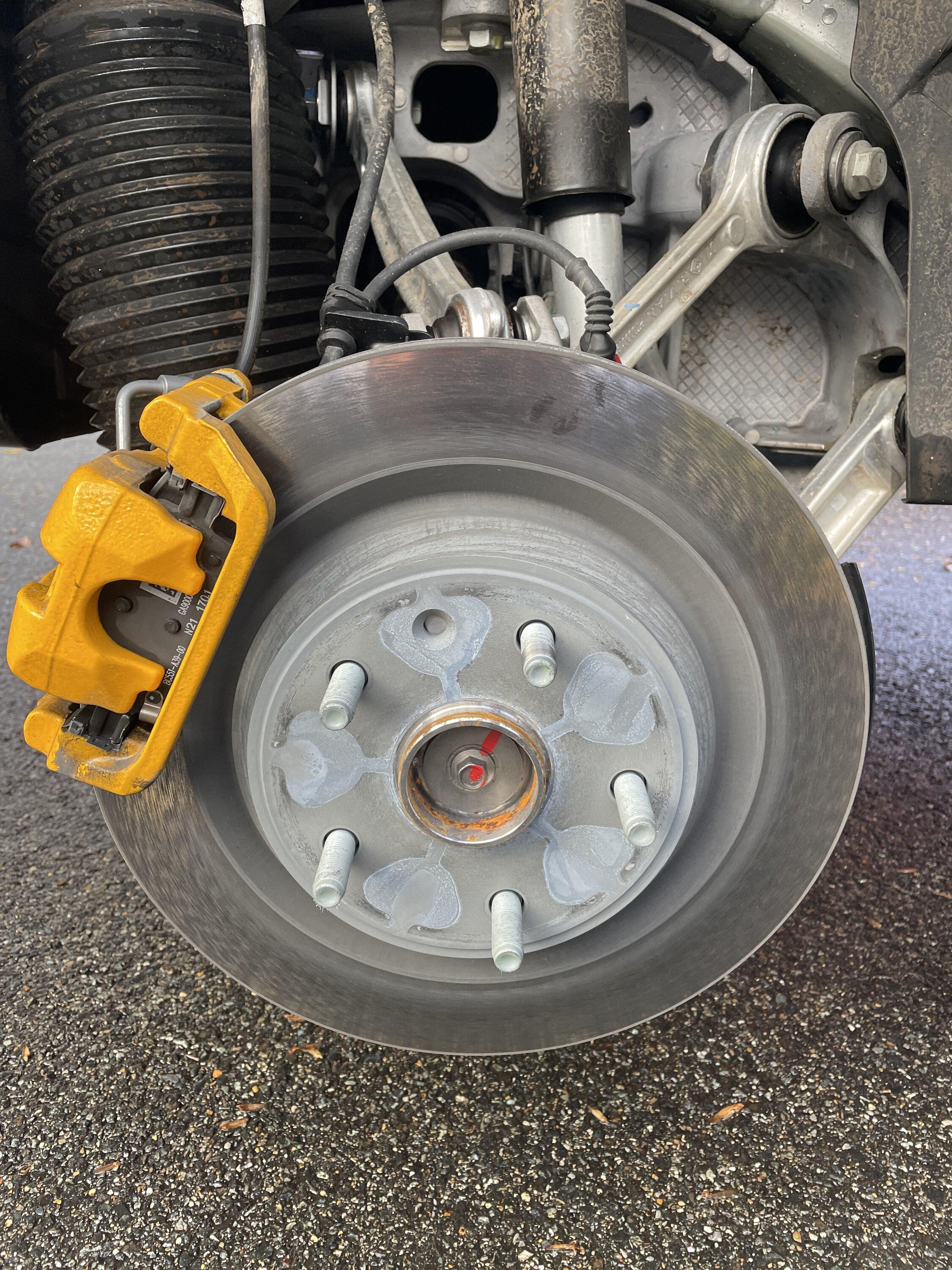

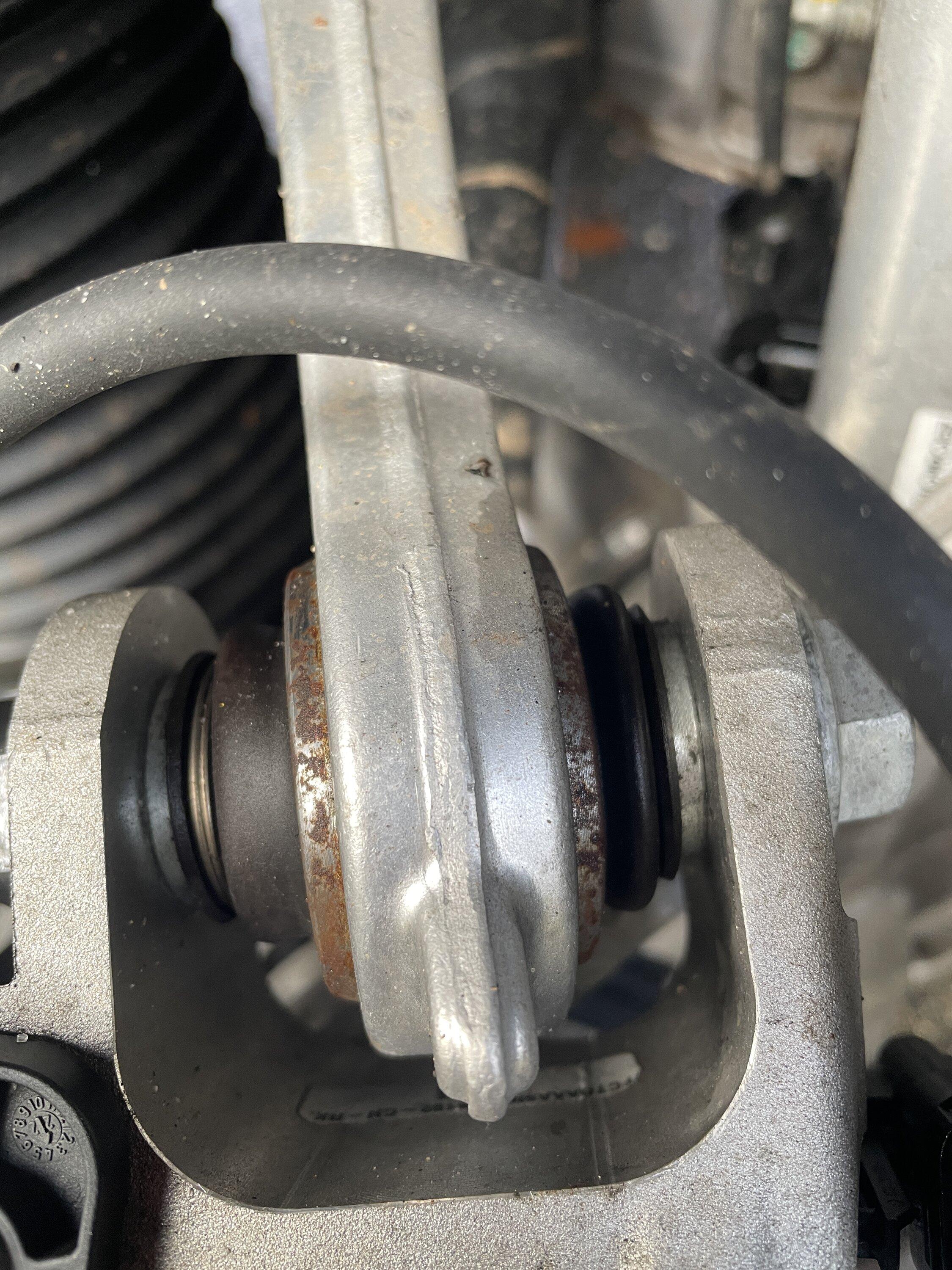

Looks to be getting some rust in parts of the hub already, assuming that's normal? (See Pics).

It is perfectly normal for uncoated steel parts to get surface rust. You better not look under a car that has seen a few winters…..the salt destroys coated and uncoated steel parts.
