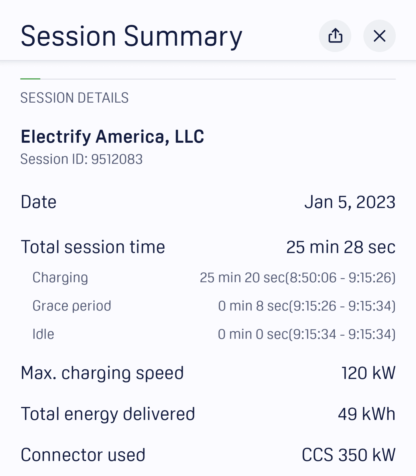

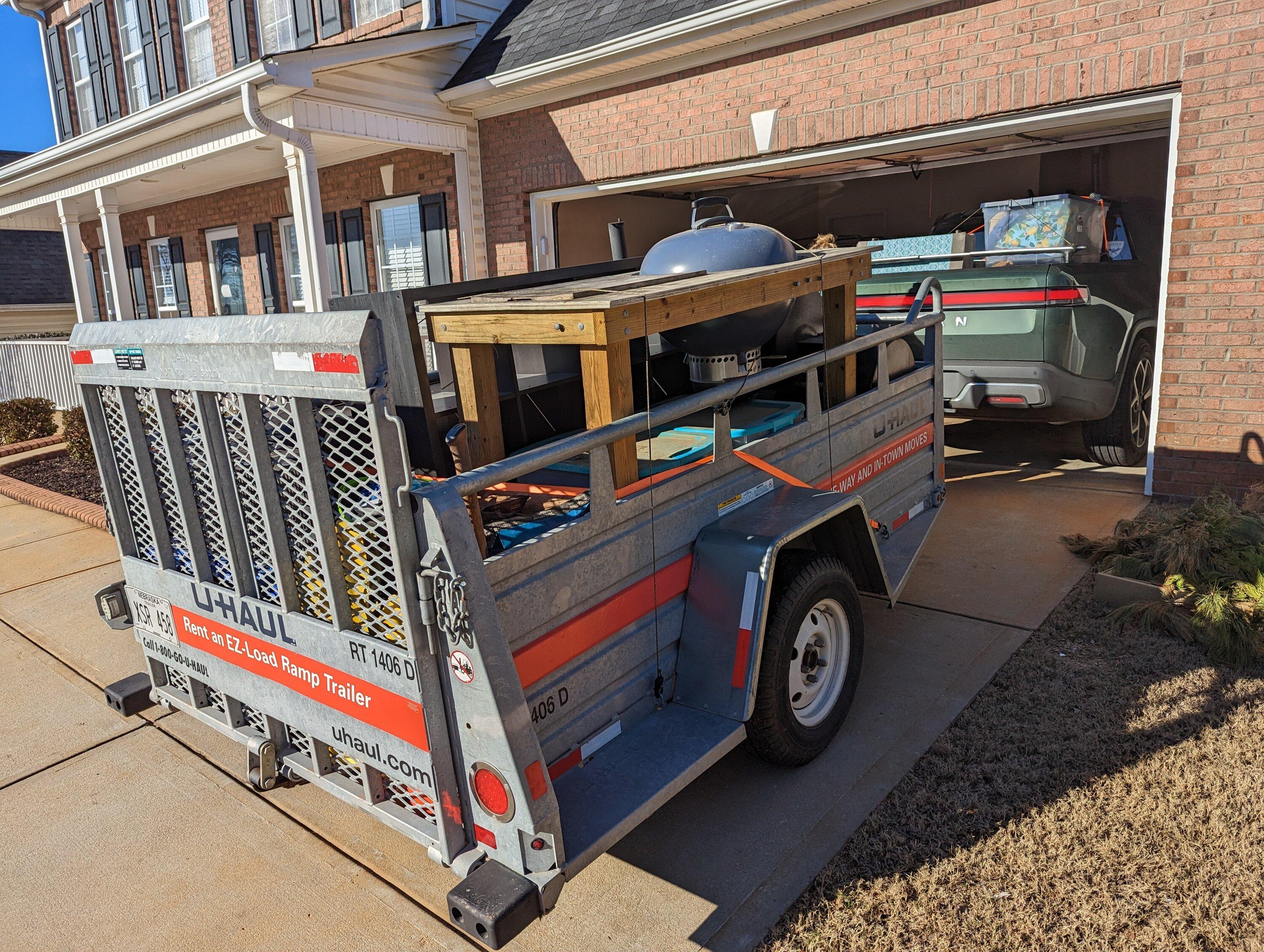

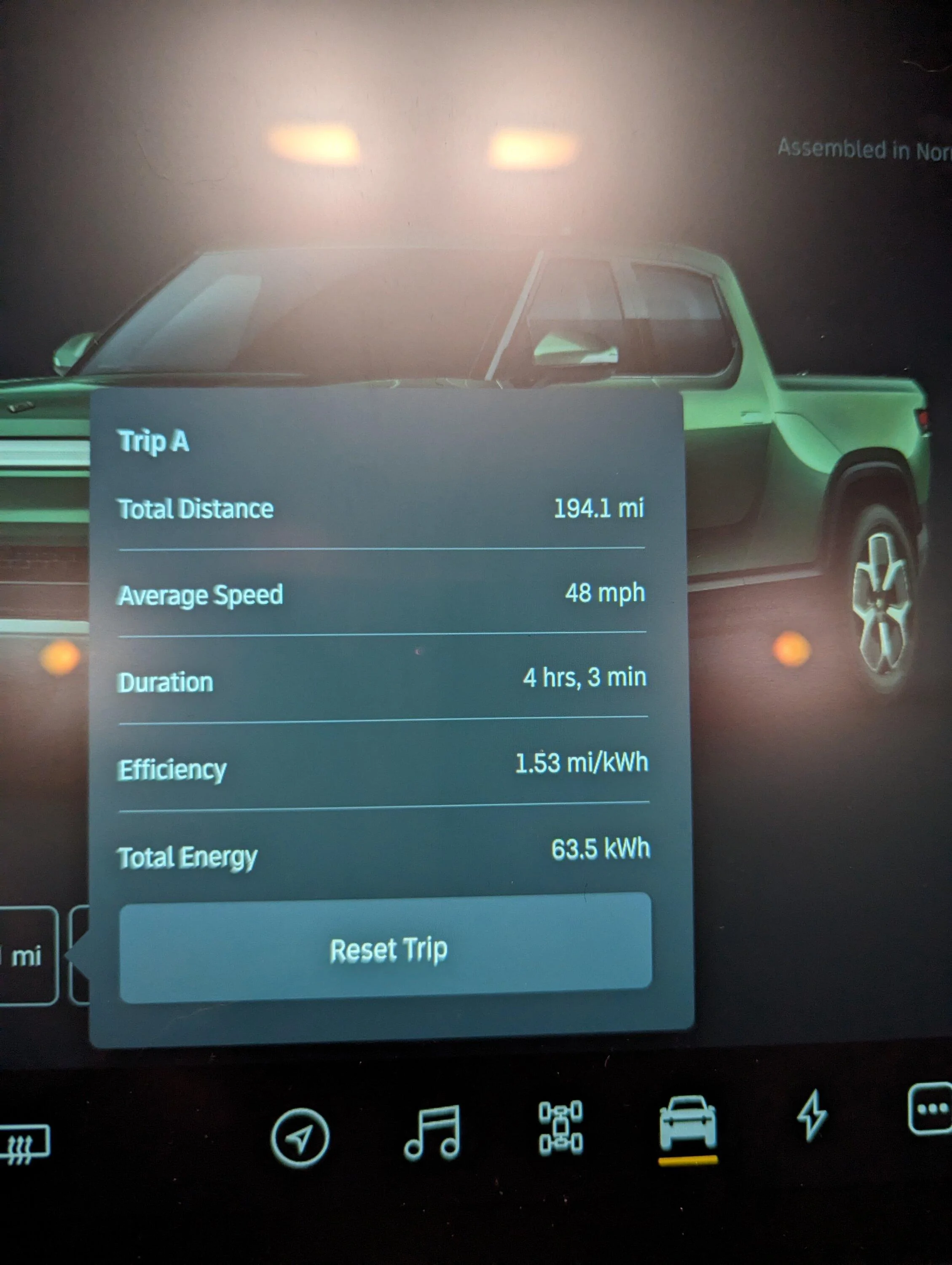

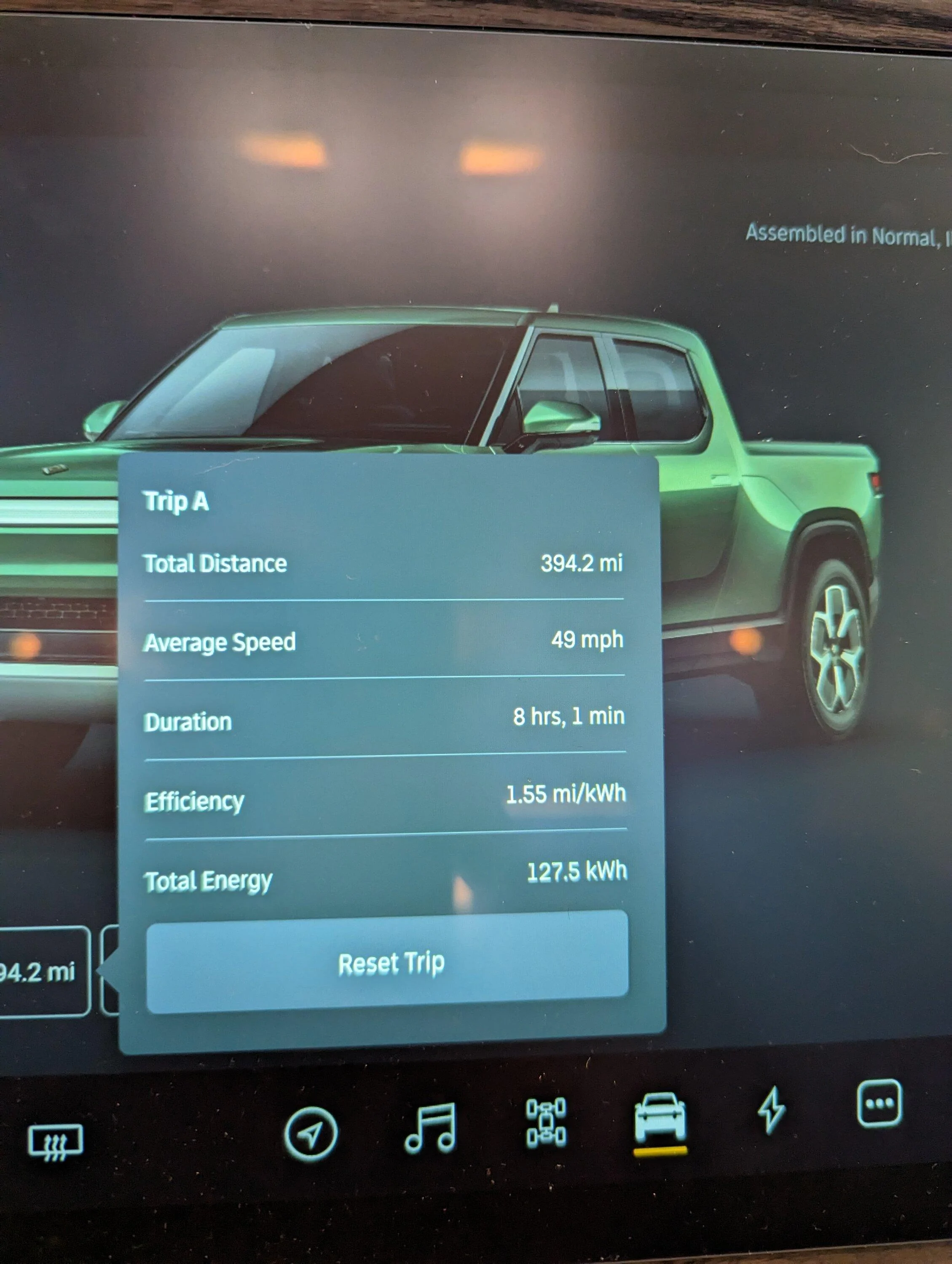

Did a 400 mile Round Trip from Greenville, SC to Charleston and back with an overnight in Charleston. The entire trip was with a U-Haul open 5x9 trailer, empty on the way down and full on the way back.
Driving down with the empty trailer I managed 1.53 mi/kwh (compared to 2.2 or so with no trailer on a similar route) with cruise set at 60mph although I did hit a significant slow down north of Columbia. Stopped at the EA station in Columbia because it's literally the only DCFC on the route and it's roughly halfway.

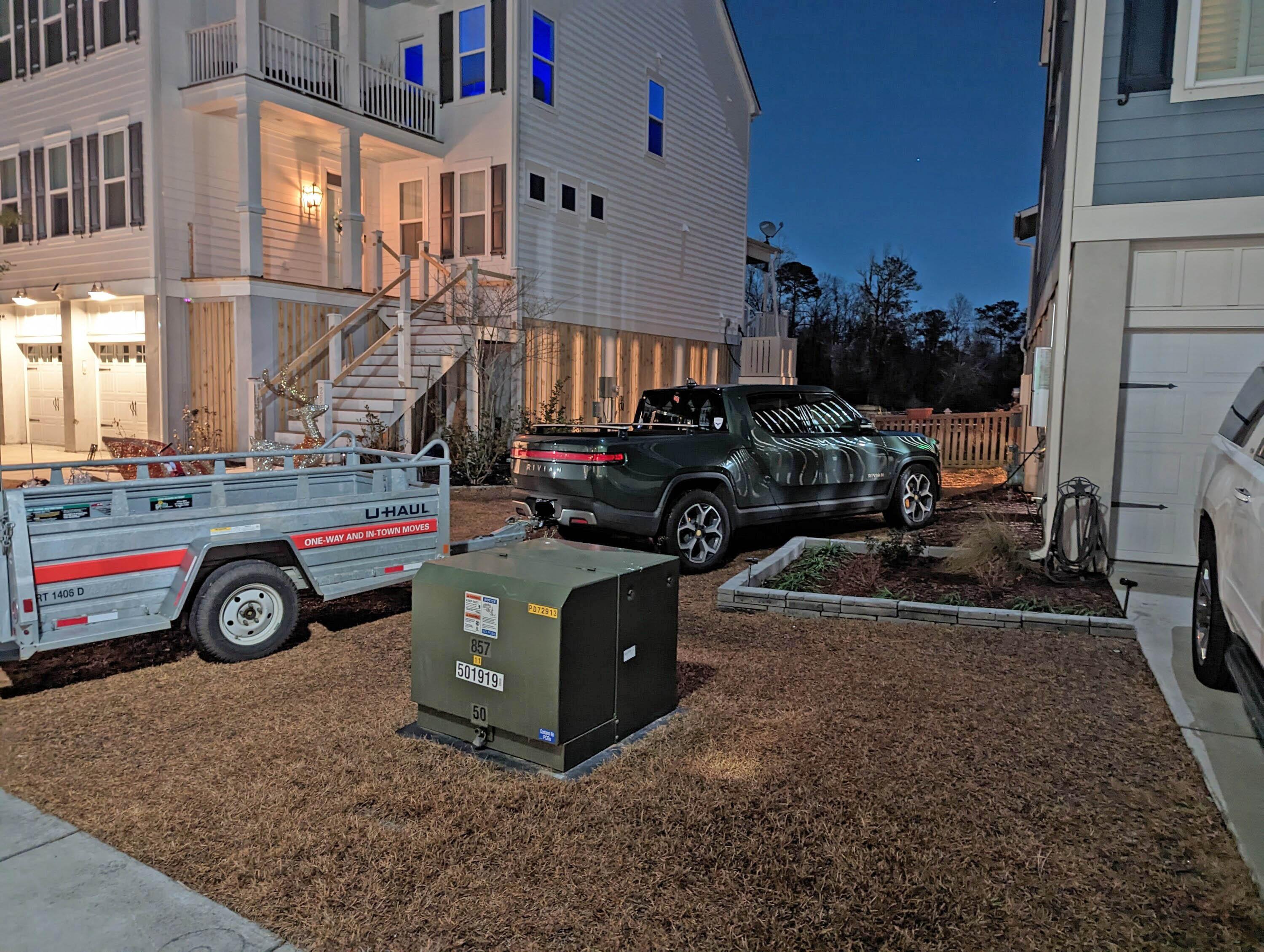

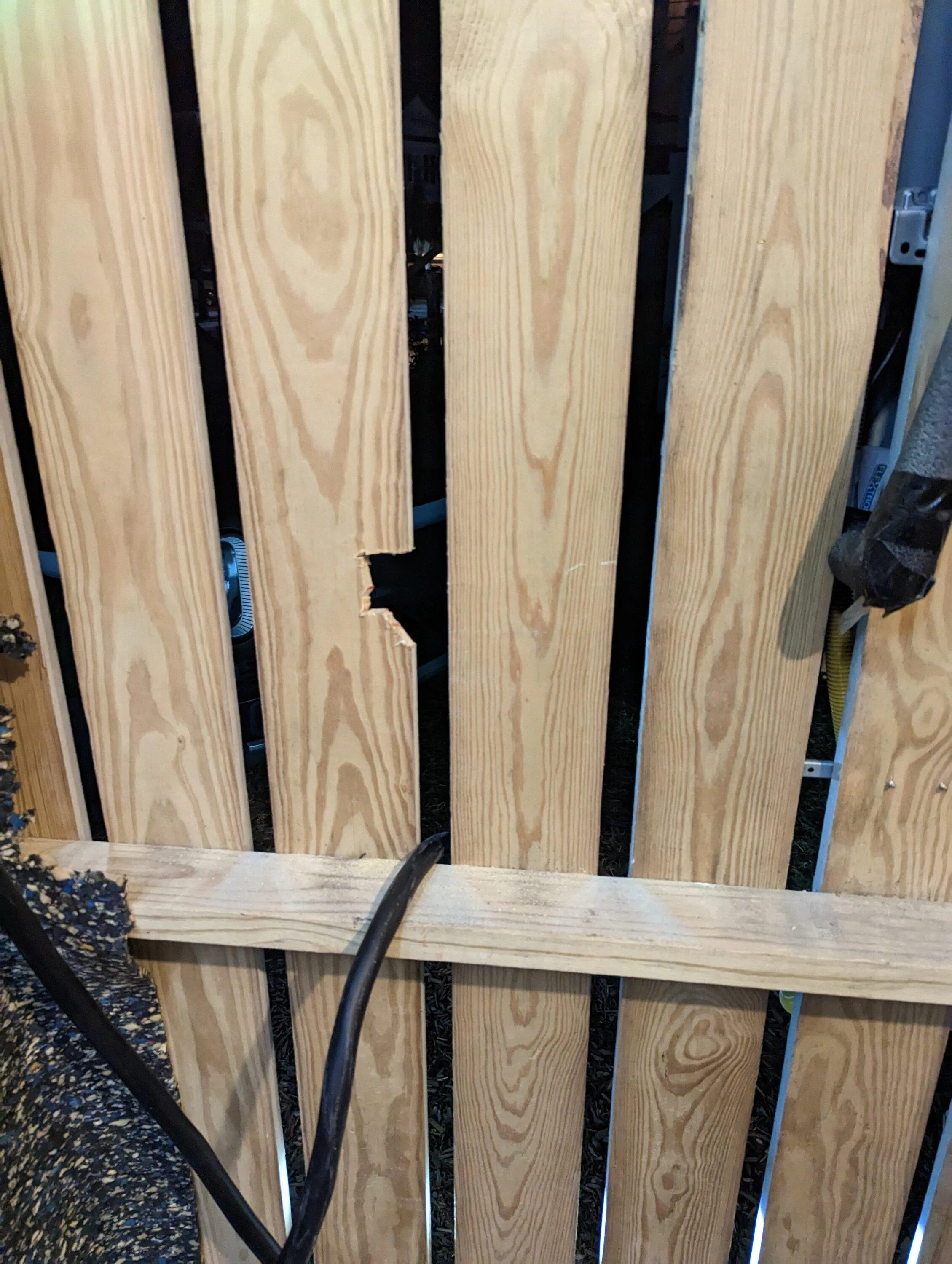

Got to the house with about 14% SoC and my neighbors had unintentionally ICEd me. Was not a happy camper. Desperate times call for creative solutions.
Rivian R1T R1S 400 Mile Round Trip (GSP to CHS to GSP) with Trailer Towed by R1T PXL_20230106_043624116.MP
Had to cut a notch out of the slats to fit the charger through. If anyone wants to complain about me rocking the sawzall at 11:30 pm they can come at me.

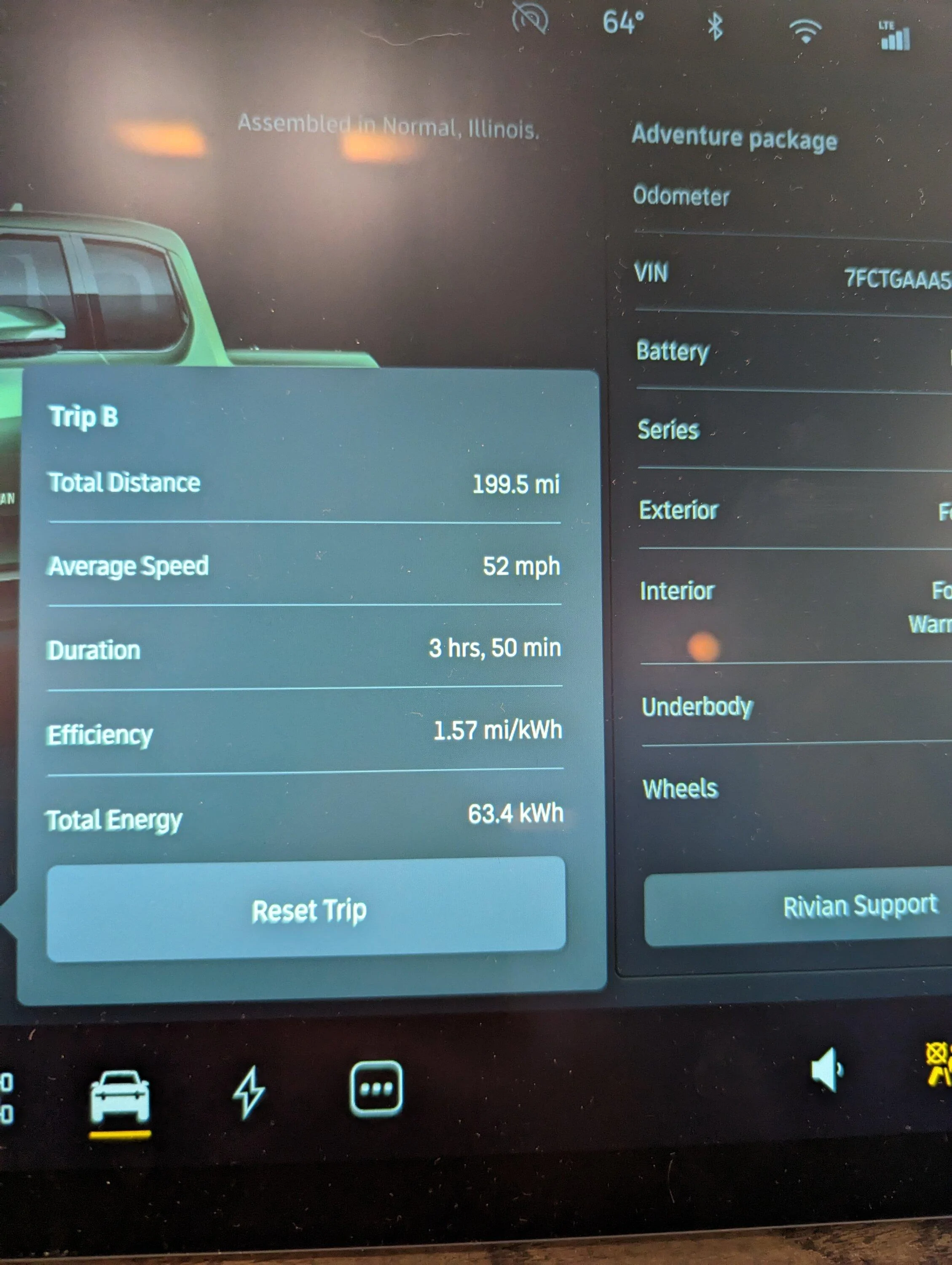

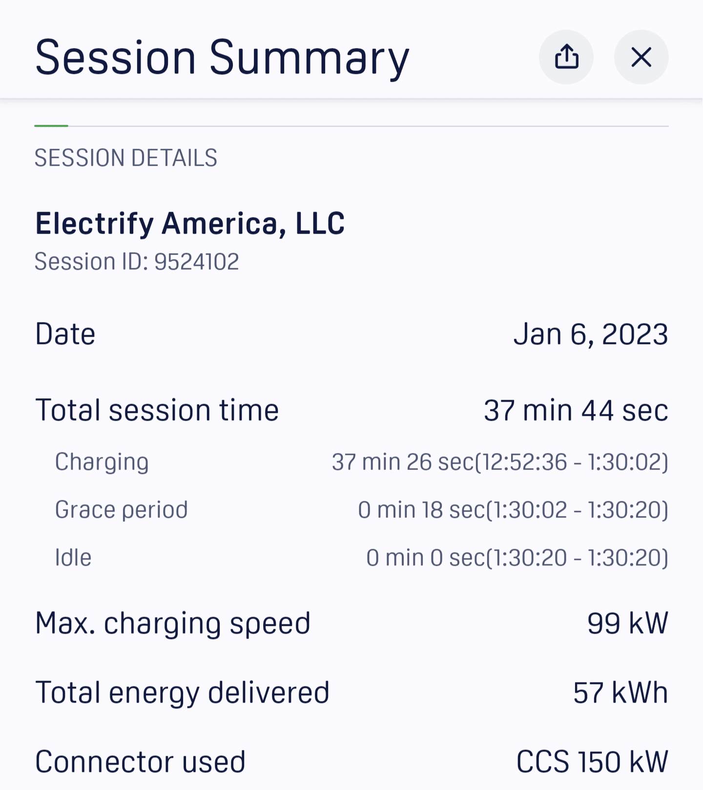

Loaded the trailer and left the house with a mostly full battery (94% SoC) this morning and stopped at the same EA station in Columbia with about 40% SoC running at a sleepy 55mph. Was getting about 1.6mi/kwh average most of the way so I probably could have been doing 60 or 65 mph but this was my first time pulling a trailer and I had no idea what to expect in terms of efficiency.
Rivian R1T R1S 400 Mile Round Trip (GSP to CHS to GSP) with Trailer Towed by R1T Screenshot_20230106-195211
Left the charger with 80% SoC and went back to 55mph, again the lack of DCFC on this route and not knowing what to expect with the elevation gain pulling a trailer so I went super conservative. Made it to the house with about 40% SoC so I definitely could have pushed it more. Even so, not a bad efficiency on the return trip with a full trailer.

Total efficiency for the trip was 1.5 mi/kwh. It's a good reference point for me. I would not want to do this trip again until there are more DCFC along the route so I'd feel comfortable going faster.

Consider a J1772 extension cable in case of future ICE-ing. I think they come in lengths between 10ft and 40 ft.

This was a real isolated incident involving terrible timing. Neighbors are getting work done and the contractor is using their driveway and we aren't at that house so we told them they could park in our driveway if needed. Just didn't expect the entire driveway to be blocked because my charger can reach either side. I do plan on getting an extension cable though for public ICEing. I also rolled in at 11:15 and they were already asleep and I wasn't going to go wake them up.

Yeah now that I have some data points I feel more comfortable. I'd probably feel ok doing 60-65 now which would make the drive easier, but I'd still like having DCFC options every 50 miles instead of every 100.
