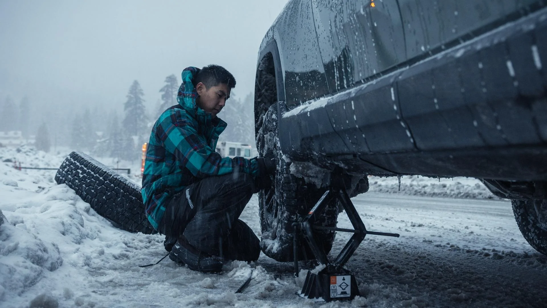

PSA, The tester in the photo above is using the supplied screw jack incorrectly. The arms need to be parallel (not perpendicular) to the truck frame or as you lift the jack will bend on an angle and probably fail at some point.
Thank you for the helpful PSA from someone who has never used one of these screw jacks...

On my first winter trip (with less than a few hundred miles on the car) I took a nail in an R1S tire on a mountain pass. Changing a tire on a frozen incline was impossible, so I had to limp 30 miles to a town, refilling air every five miles. I found the jack to be undersized and very slippery. Even on flat surfaces, the car was prone to slipping when jacked up on snow and only one tire is providing traction.
