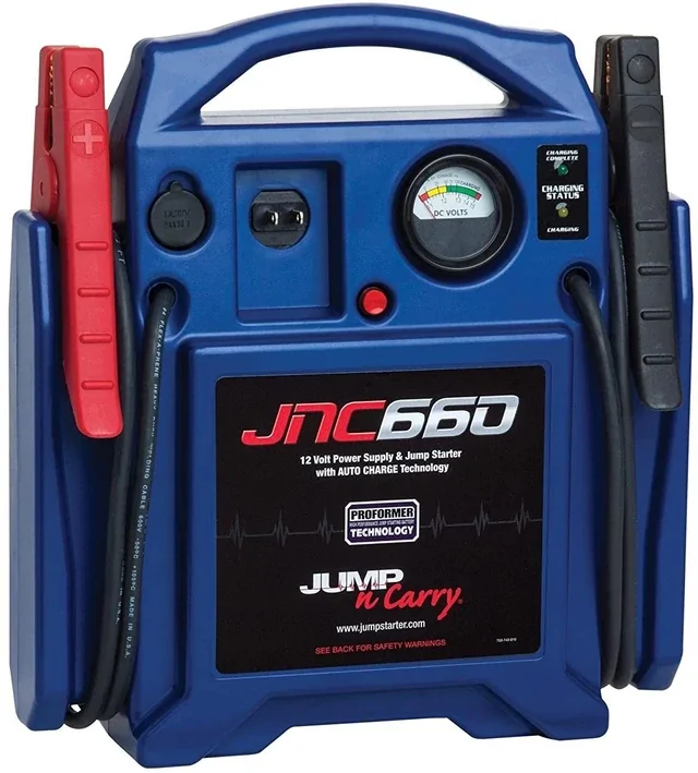

This may or may not be helpful since my G1 has the single 12v + capacitor. When my 12v died in the garage we were able to get it going again by accessing the frunk via the emergency release and hooking up the tow truck's jump pack directly to the 12v. We had previously tried it on the rear hitch leads with no success. From there, I was able to drive it out of my garage (with the hood still up) and get it in a good spot for the tow truck to hook up.

nice, that is exactly what I am looking to do. too bad the jump on the battery by the rear hitch didn't work and you had to manually release the frunk. but at least you were able to get it moving.
