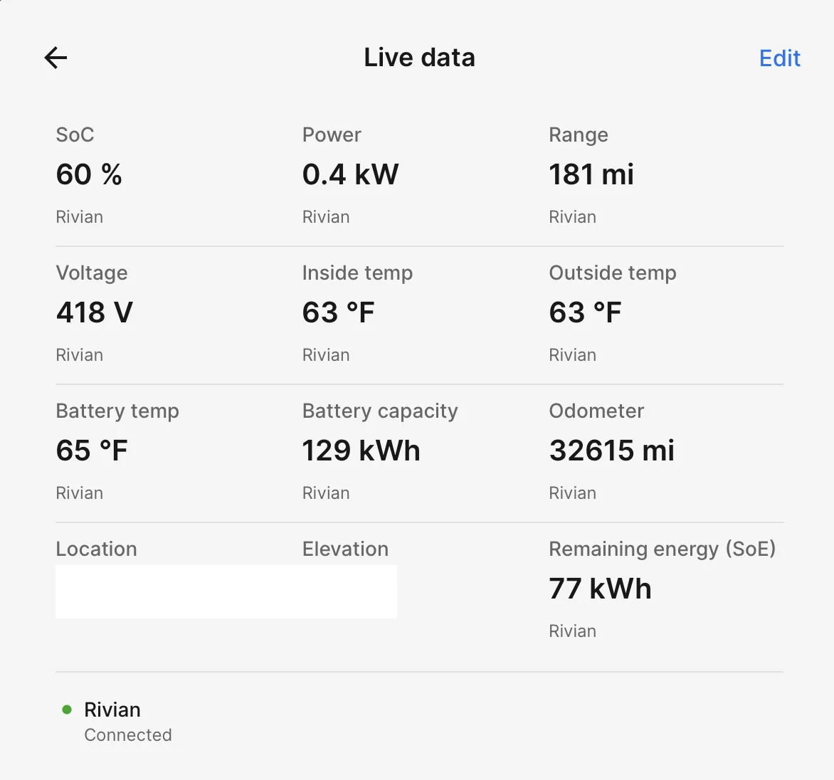

Why use this chart and not just check your battery capacity on ABRP?​
Edit: Never mind, found it!

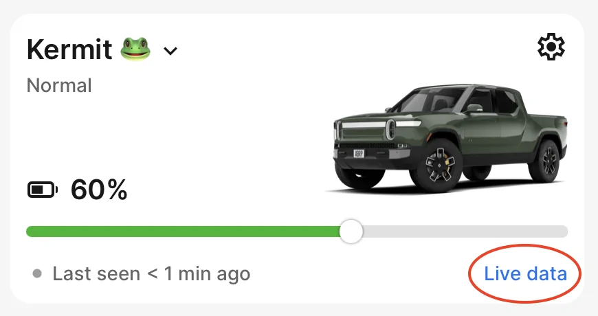

Edit: For those who - like I - didn't know where to find it: First you have to enable Live Data Connection between ABRP and your Rivian account. Then click the "Live Data" link:
Rivian R1T R1S Battery Report after 3 years / 50K miles (R1S Launch Edition) Screenshot 2026-05-20 at 07.24.48
Rivian R1T R1S Battery Report after 3 years / 50K miles (R1S Launch Edition) Screenshot 2026-05-20 at 07.24.52
(Gen 1 Large pack - only 2% degradation in ~4 years, 32k miles. Not bad!)

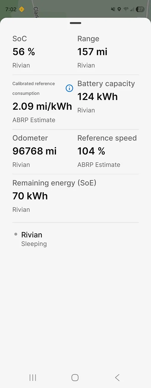

SolartoEV
Dec 30, 2021
587
1,163
Western NY
R1T VIN 269*, 2019 RAV4 Hybrid, 1999 Ford F-250
96,768.
124 showing now.
Live in western ny, aka cooler climate

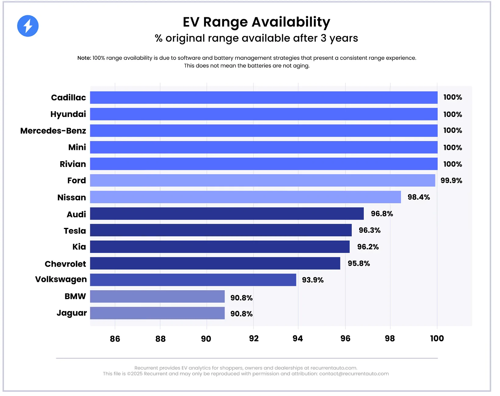

Nearly everything I read seems to indicate that the loss of battery capacity over time is effectively a non-issue, and perhaps as importantly, at least some of any capacity loss has been countered by other improvements in EV technology, Anecdotal evidence, like that of the OP - and my own - seems to provide some confirmation of that.
The general view is that EV battery capacity declines relatively steeply initially and relatively slowly later in the vehicle's life. In a 2023 study from Recurrent they stated that "most EVs experience a five- to 10-percent loss in capacity in their first 40,000 miles, then level off and maintain around 80 to 90 percent of their original capacity to 100,000 miles and beyond."
It may be that those numbers are still accurate, but it appears that EV manufacturers have been able to introduce other improvements that mitigate, and even effectively eliminate, the impact on range from any loss of battery capacity. Here's the graph from a 2025 Recurrent study that seems to indicate that:
Rivian R1T R1S Battery Report after 3 years / 50K miles (R1S Launch Edition) 1779373682010-al
Given the above, I'm a bit puzzled by the 97 Range Score that I see on Recurrent for my 2024 R1T with just over 16,000 miles on the clock. More confusingly, Recurrent projects the range for my PDM Large with 20" wheels and AS tires to be 334-335 miles, vs an "Original EPA Range" (the Recurrent EPA figure) of 328 miles. The final range figure on the Recurrent site is the "Est. Range in 3 Years" given as 318 miles. It's not clear if the three years means from new (2027 in that case) or from now, which would be 2029. If the former, that means a loss of 6 or 7 miles over the next year (about a 2% drop) but if the latter, that 2% would be over three years, so under 1% per year.
Either way, the loss of battery capacity over time is not something owners of newer EV's really need to worry much about.
