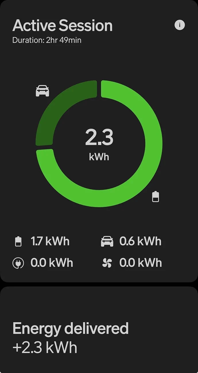

I’m out of town and am plugged into an exterior 110v outlet at a friend’s house. This is the first time I’m using the Rivian adapter with a 110v outlet. I set the amps to 8 and my 2026 R1S is getting less than 1 kWh
Can I turn the car to Camp mode and turn off display, etc to get the most out of the trickle charge?
Can I boost amps to 10 without blowing a fuse/tripping a breaker?

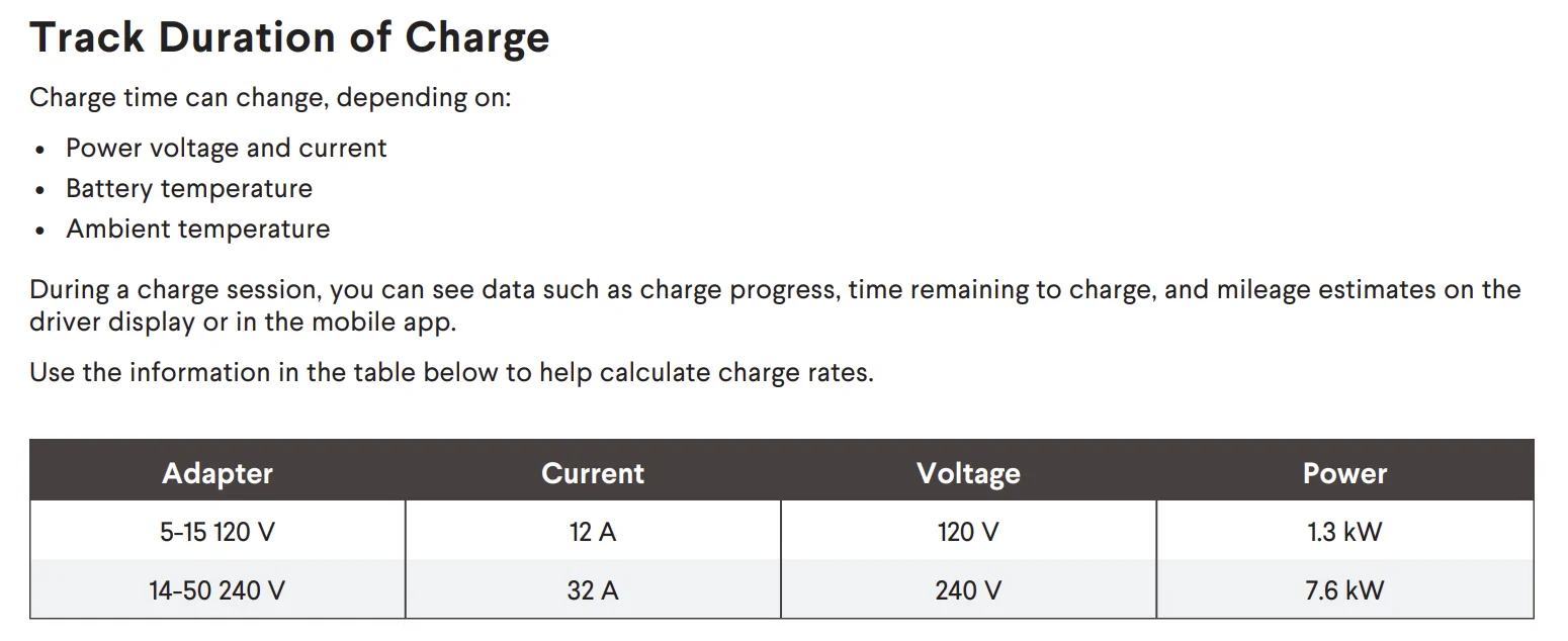

It's in the manual. It will draw 12A max on a 120 volt circuit. As long as you are plugged directly into the outlet, or using a not too long 14 gauge extension cord, you don't have to set the Rivian to anything. It can't draw more current than the charger permits. If for some reason you used a 100 foot 16 gauge extension cord, you should drop it back a bit. But at 120 volts, you want to be charging at 12A, so don't do that.

I had looked through the manual and only saw *how* to set the amps, not *what level* to set the amps, so thanks so much!! What section is this chart in, or what page number?

1. It's in the manual for the portable charger, not the vehicle itself - not sure if Zoidz mentioned that or not.

Oh!! It never occurred to me that the Rivian *charger* itself has a manual! Having had an EV before, I simply pulled out the cable and the adapter I needed. Many thanks for your clarification!
