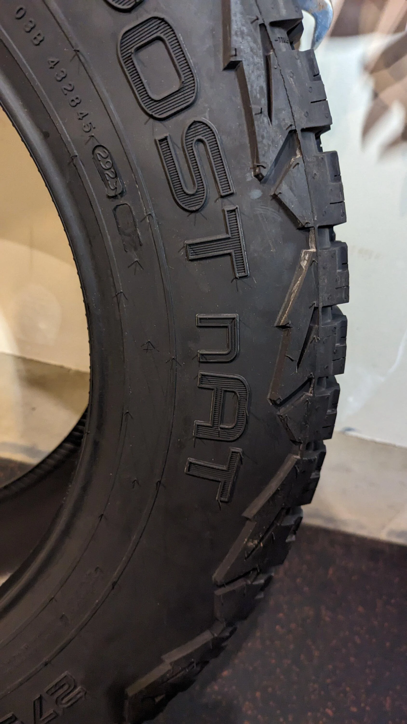

I don't think they'll be MAXIMAL efficiency, but I wanted something I could offroad as well as rely on 3-peak snow rating for winter driving, so I went with the Nokian Outpost nAT (Nokian designed these with EVs in mind, according to their website). I have 5 sitting in my garage waiting for my AW10s :)
Looked for the nATs. Haven't found them at discount tire or tirerack? Where did you find them and what size?
https://www.amazon.com/gp/product/B0C3WRCWR6/ref=ppx_yo_dt_b_asin_title_o07_s00?ie=UTF8&psc=1
275/60R20
They are hard to find as I understand it, due to the war between Russia and Ukraine having interrupted parts of Nokian's supply chain. That amazon link is exactly where I got mine, and it looks like they're actually cheaper than when I bought mine (they were 261/each when I purchased).

I stand corrected then!
