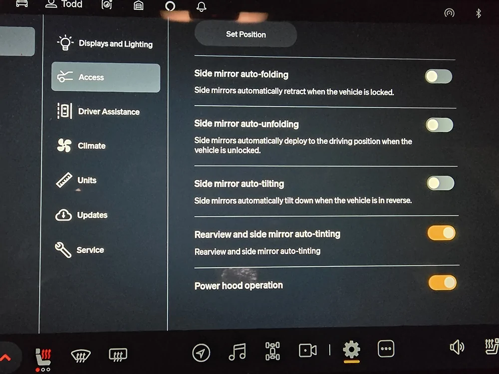

Probably a dumb question, but just to be sure, is there any chance the power hood operation got turned off?

Correct, hood does not close when the power hood operation is turned on. The way I get it to close now is after opening it automatically, I turn off the power hood then close it manually. I think I read somewhere that its bad for the mechanicals to close it manually while the power hood operation is on.
