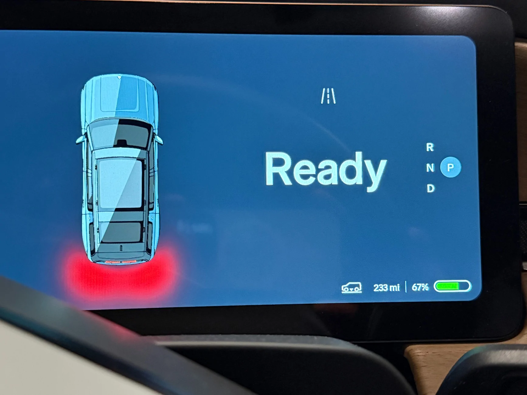

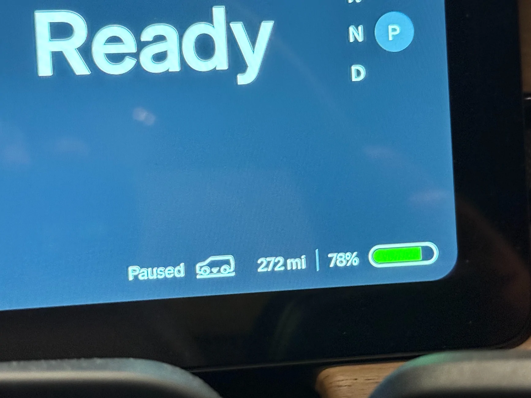

Went on holiday 13Dec parking my Gen2 R1S TM @ DFW airport at 0530 with 78% SOC. Family & I returned 26Dec @1500 with vehicle at 67% SOC.
Rivian R1T R1S 30-day no-use // how much battery drain? Depart
Rivian R1T R1S 30-day no-use // how much battery drain? Return
The avg. temp in DFW during this period was 59 degrees. Granted, it wasn't as cold as other parts of the country. Nevertheless, I was pleasantly surprised to have lost <1% SOC per day with GG on(& pre v.46.0 update). First time ever parking my TM outside overnight.

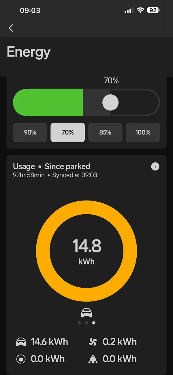

Parked in my own garage for past 4 days with nothing on, no motion or live cams. Where’s almost 15 kWh gone?
Rivian R1T R1S 30-day no-use // how much battery drain? IMG_8897
Rivian R1T R1S 30-day no-use // how much battery drain? IMG_8898
