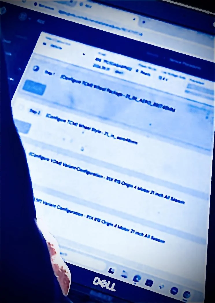

Rivian R1T R1S Tire size recalibration successful by mobile service cat-driving-cat
goldburger
Feb 5, 2022
1,732
2,038
Good news!
Took mobile tech about 5 minutes to change the setting, speed/odo now recalibrated!
