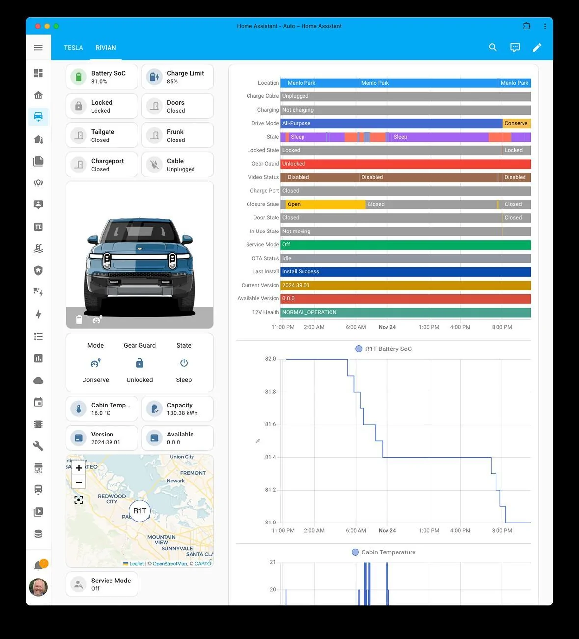

As I am doing final preparations to ship our R1T Quad to Europe in Q1 2025 I have finally setup a detailed dashboard for the R1T with our Home Assistant instance, similar to what I have been using for our Tesla's. The unofficial Rivian API is still a bit limited but does provide a wealth of information that can be tracked over time.
The plan is to do a 5-6 weeks unplugged storage test over the holidays. I plan to post regular updates along the way and compare them to best in class measurements of other vehicles. In addition to the dashboard I have a history view that shows all these metrics over weeks and possible months.
Take a look and let me know what you think.
If you are interested on how to get HomeAssistant up and running for yourself I have posted a thread about it here: Installing HomeAssistant to capture Rivian API data
Rivian R1T R1S Rivian Dashboard for Upcoming Longterm Phantom Drain Test Screenshot 2024-11-24 at 1.46.49 PM

I would tend to use kWh for state of charge instead of percentage. That way, I get to feel the pain of losing 2 kWh per day (~0.75 mWh/year!) at $0.36/kWh off peak for phantom drain.

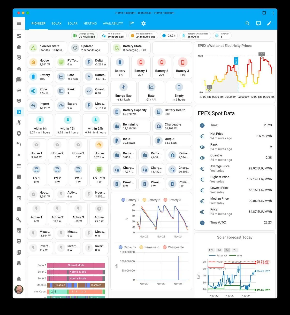

I hear you. The Rivian dashboard is only a summary of the data the Rivian API provides by itself.
Here is a sneak peak on how detailed this system tracks and calculates energy usage, storage, pricing, ...
Rivian R1T R1S Rivian Dashboard for Upcoming Longterm Phantom Drain Test Screenshot 2024-11-24 at 2.23.58 PM

Looks good please share the code
Here we go. You need the unofficial Rivian API integration for HA from HACS and replace all the_crazy_one_r1t with the name of your vehicle (given when setting up the integration - can be different from the vehicle name in the Rivian App)

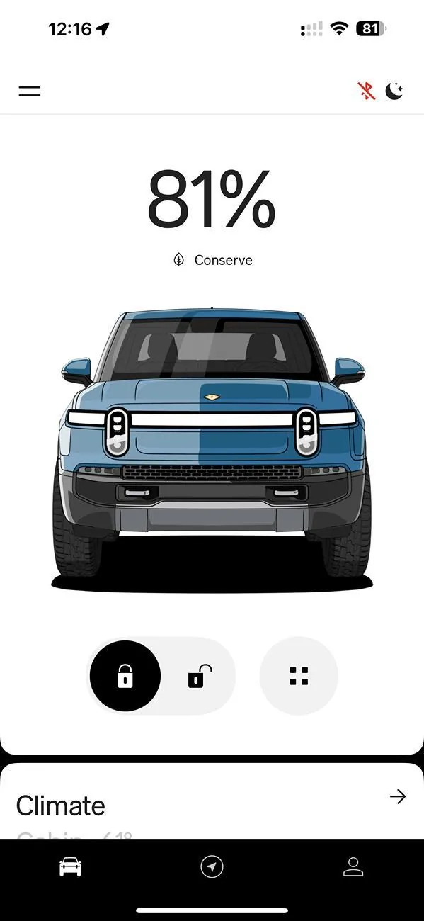

Nice HA setup but wouldn’t it be better to put it in shipping mode and walk away? All the Rivian API hits must have some contribution to the phantom drain and in this test live data is your enemy and not your friend.
Setting shipping mode and measuring a one week sleep, a two week sleep, and a three week sleep takes the same six weeks but probably gives a better estimate of actual loss during shipping.
Yes wouldn’t that be nice. The car as-is is sitting in shipping mode, with proximity and AC turned off, software updates turned off, API is setup read only and will not wake the truck. Just like when the app shows the truck sleeping. The API is whatever Rivian has on the truck, not calling the truck directly.
All windows and doors closed and locked. Nothing on the seats, all belts unbuckled.
Rivian R1T R1S Rivian Dashboard for Upcoming Longterm Phantom Drain Test IMG_7049
Even like that andthe truck sitting in a garage at a balmy 50-60F, the operating system will come out of sleep 2-3 times per day for as much a 90 min each, loosing about 1% of charge per day.
This is a 2023 R1T with single 12V battery and capacitor, comprehensive serviced last week including the factory recall to a brand new 12V battery.
After thanksgiving I will do a 6 weeks test and share progress every few days.
