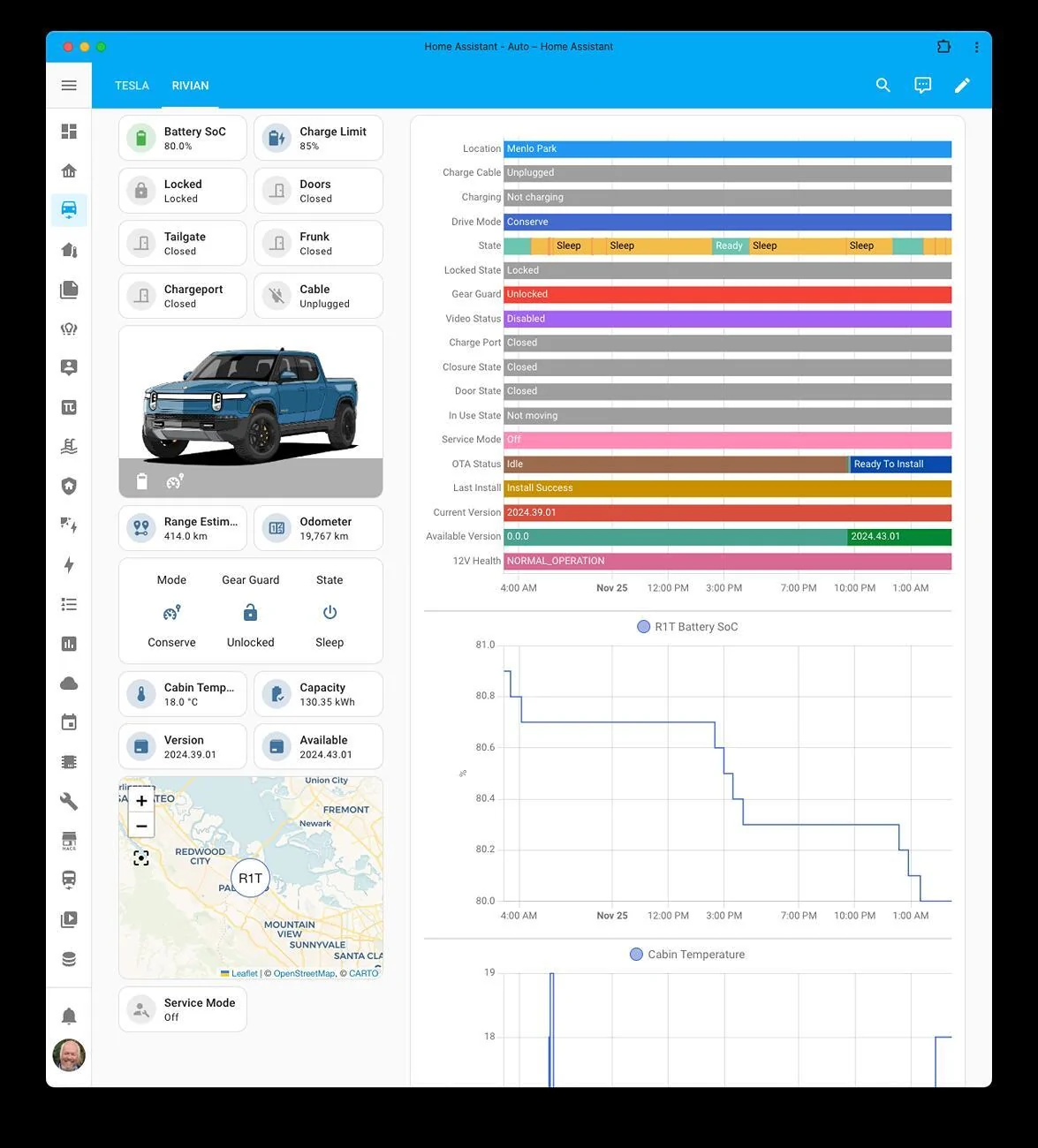

As I am doing final preparations to ship our R1T Quad to Europe in Q1 2025 I have finally setup a detailed dashboard for the R1T with our Home Assistant instance, similar to what I have been using for our Tesla's. The unofficial Rivian API is still a bit limited but does provide a wealth of information that can be tracked over time.
The plan is to do a 5-6 weeks unplugged storage test over the holidays. I plan to post regular updates along the way and compare them to best in class measurements of other vehicles. In addition to the dashboard I have a history view that shows all these metrics over weeks and possible months.
Take a look and let me know what you think.

Today was a good test for the dashboard as a software update became available. Even though disabled in the cars settings, the car downloaded the new update (~3 min) and prepared for the update (~7 min) all while in "Sleep" state. Did not wakeup the car overall. But as with any day prior the car continues to wake up 3x per day for 90 min or more each - relatively evenly spaced out. As many have seen before approx 1% or about 1.3kWh per day. For reference that is more than 10x worse than a Tesla Model Y parked at almost freezing temperatures.

Yes read them all and reached out to multiple European Rivian owners before I started. As you say it depends on the shipping company. They all require and offer different things.
If there is an option to disconnect I will do that. My 2023 has the single battery and supercap setup. Disconnecting the HV relay is a single cable, so is the battery disconnect. I can do that in less than 10 min.
The drain test is my fallback. Just about to post a one week update into a 6+ week storage test. Running at 5-6% per week now that everything is setup correctly. That is 50-60% discharge over 10 weeks.
It also seems Rivian has a safety feature built in: once the HV battery drops to a low state of charge it will gracefully brick itself by stopping to charge the 12V battery and letting that small battery deep discharge and eventually kill itself. At the same time it basically stops the drain on the HV battery and can go for months beyond that point. In that case you might need a new 12V battery and a reset in the service menu.
