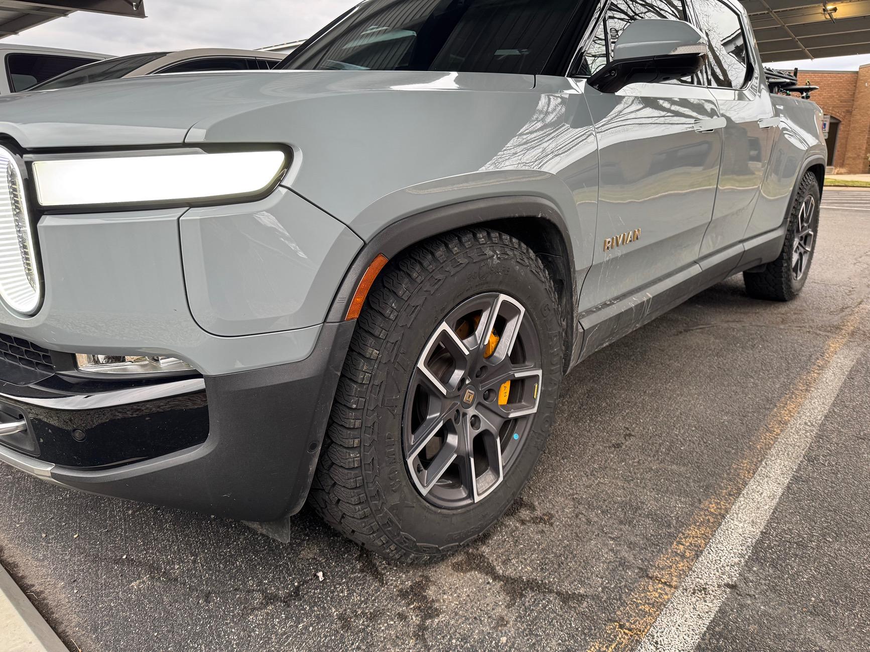

Can you add a pic of them on your truck?

Any first thoughts/pictures?

Following up here after a little over 1,000 miles— the tires feel good. They’re quiet, with pretty decent response. About 800 of the miles have been on interstates between 75-80 mph in temps between 10 and 30 degrees Fahrenheit, which are both not great for efficiency. So far I’m sitting at 1.57 on efficiency, which is about what my worn stock Pirellis were at. More city driving should give a more accurate representation for me- I don’t typically drive interstates as much as I have been the last couple weeks. For the folks that asked for a picture…
Rivian R1T R1S Gladiator X-COMP A/T Tire Experience IMG_2867
