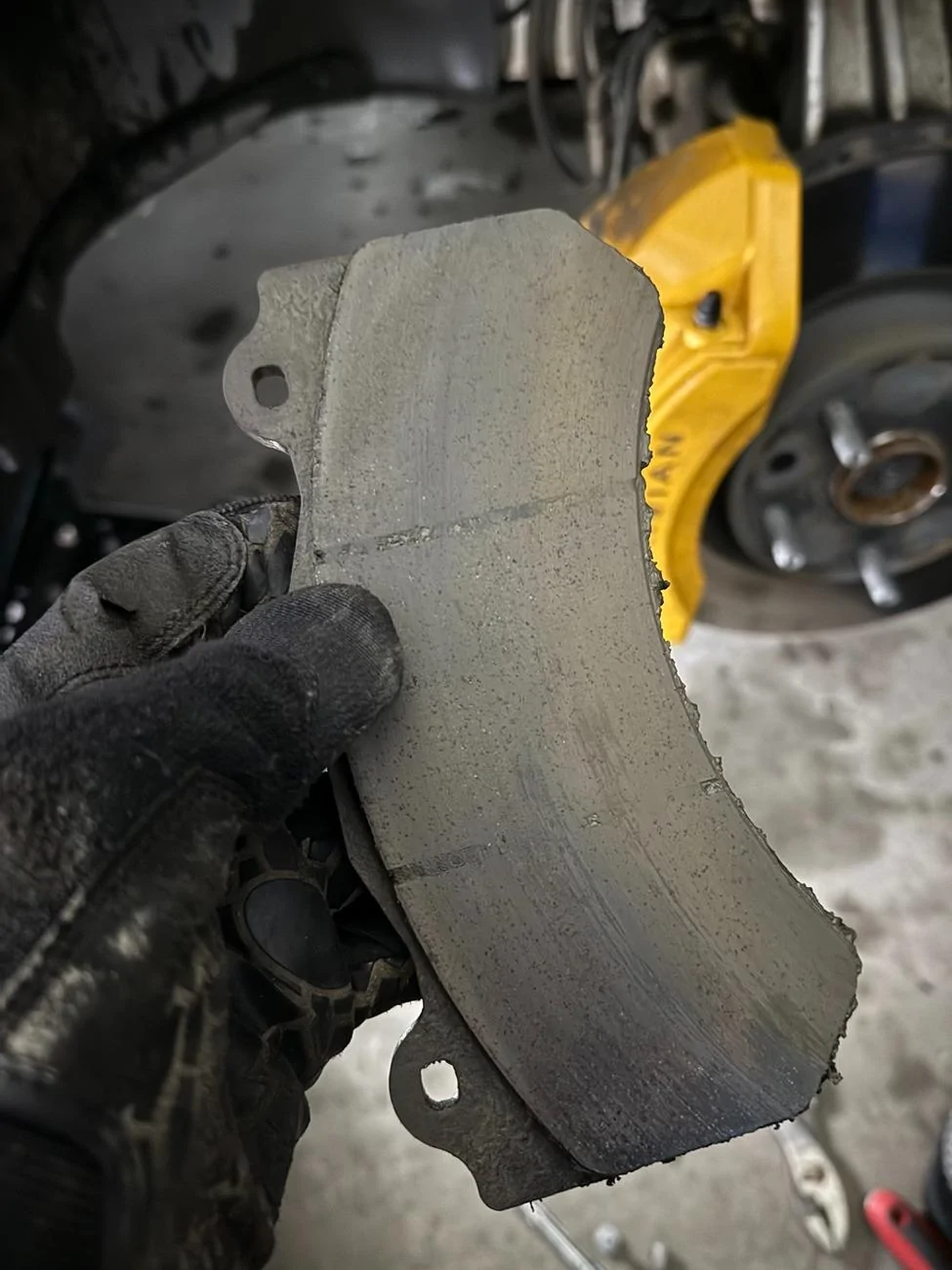

Here's the inner pad from the front-right wheel. Not terrible, but there was a lot of gunk build-up, right into the grooves (which is why it might look worn down badly). Weird.

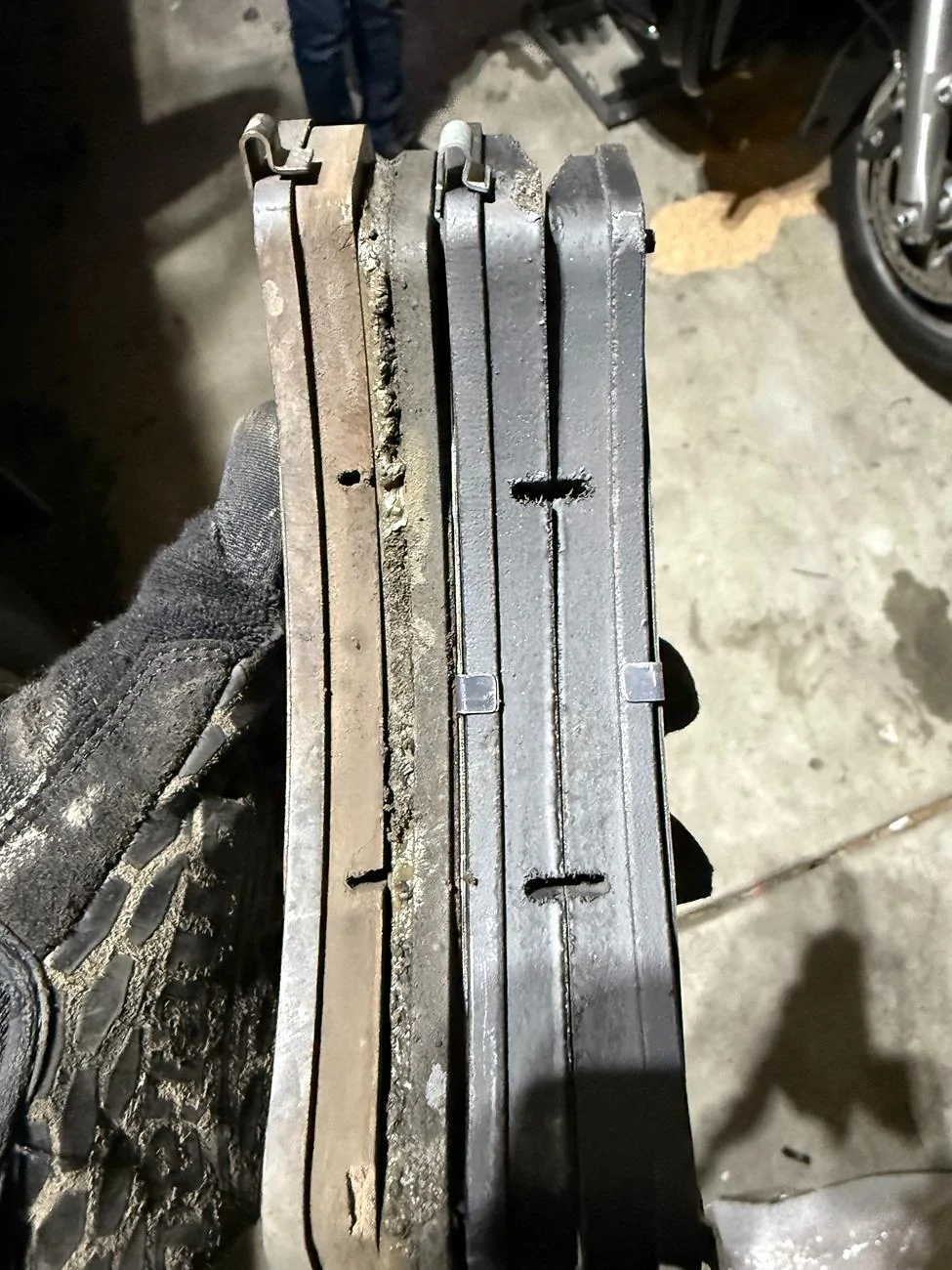

Old pad set (left) vs new pad set (right). Inner pad had definitely worn down quite a bit (vs outer pad). No gunk on the outers, their grooves were clear, and lots of material left.

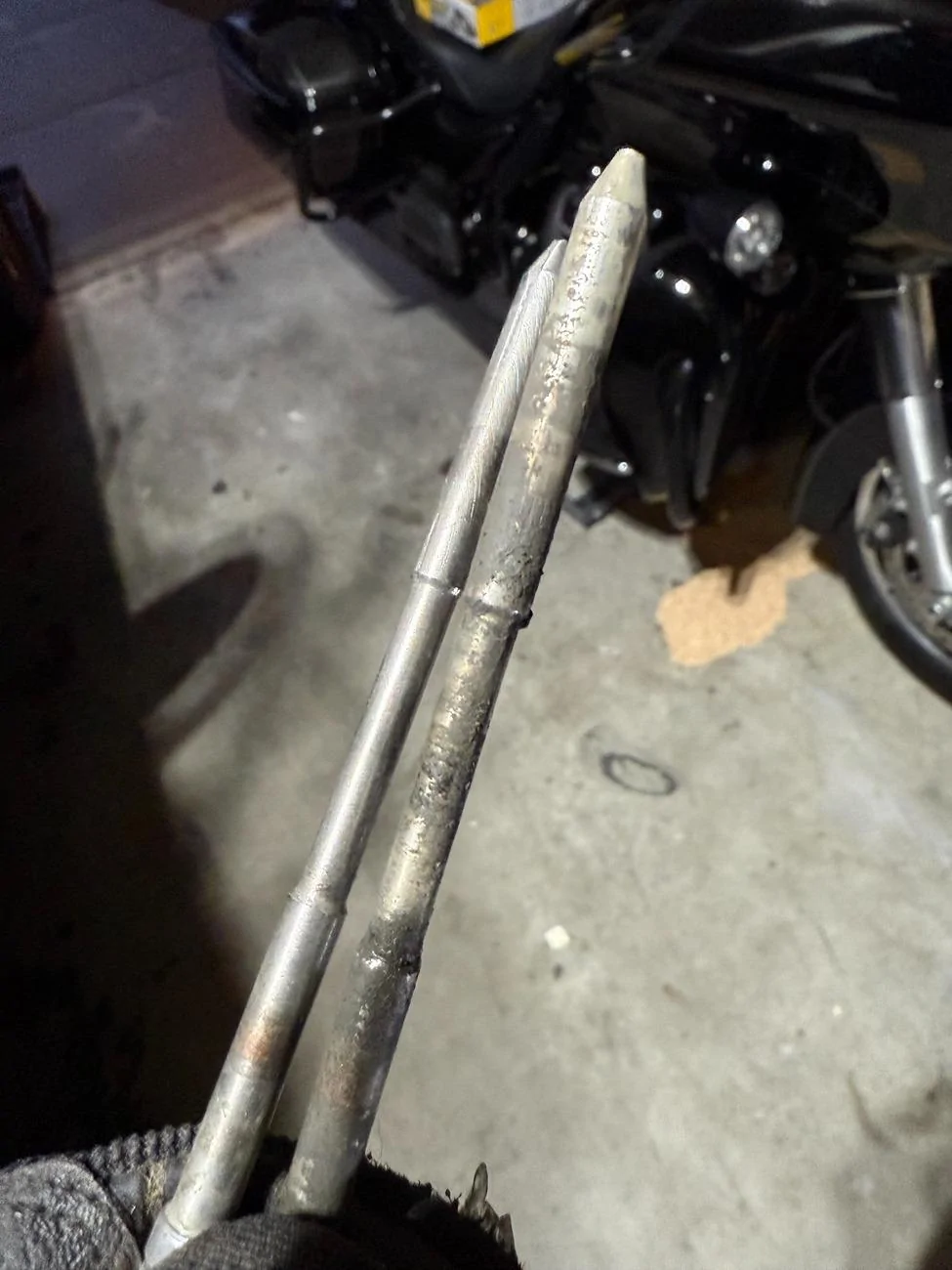

Cleaned up the pins with a wire wheel. Cleaned-one on left, yet-to-clean on right.

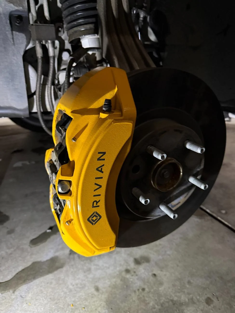

This is the first time the wheel's coming off in my garage, so might as well clean up the calipers.

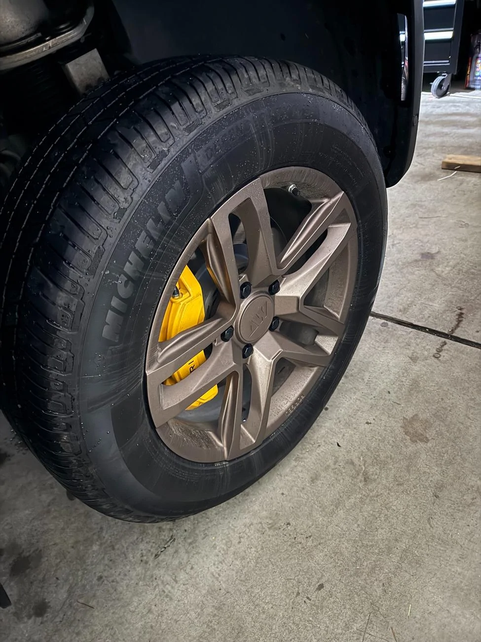

Wheel back on. Shoutout to AW. Love the wheels...they could do with some cleaning though...whatever...ok...i digressed...

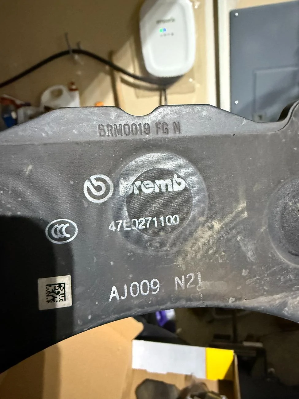

I figured someone might want to know the OEM Brembo Pad Part Number:

  • This one is important - Inner pads didnt have the wear indicators, but outer ones did. Thought this was weird. All replacement pads had wear indicators, but i quickly figured out why the original inners didnt have them - the pads dont fit with the wear indicators on. You face an issue while trying to slide the pins back on. So i had to snip the wear indicators off the new ones as well. Lesson here is - keep an eye on your pads, otherwise you'll destroy the rotors, and will therefore need to replace those as well
  • Based on the point above, i might just replace the rear pads over the next few weeks as well (even though the tire shop said they're still decent). Who knows - there might also be some gunk buildup on the inners as well.

So, you didn't mention but:
1- I assume you greased those pins before reinserting, yes? They shouldn't go in clean. In fact, most of the (hopeful) hypothesizing around why there's uneven wear (because uneven brake wear is NOT normal on a floating caliper system) is due to the pins not being greased properly during assembly.

Nice write up. I’ll add to the comment above that you should grease at least the pins with caliper grease. I’d also like to add torque specs to this write up as I had a hard time finding that too. I don’t like to mess around with GNT for something as critical as brakes!
I took my pads out a couple of months ago to clean them since I had some brake squeaks. Just did the fronts and just under 40k miles on them. Pads had plenty of meat, just needed cleaned and greased. I always grease all the touch points including the back of pads and piston surfaces.
