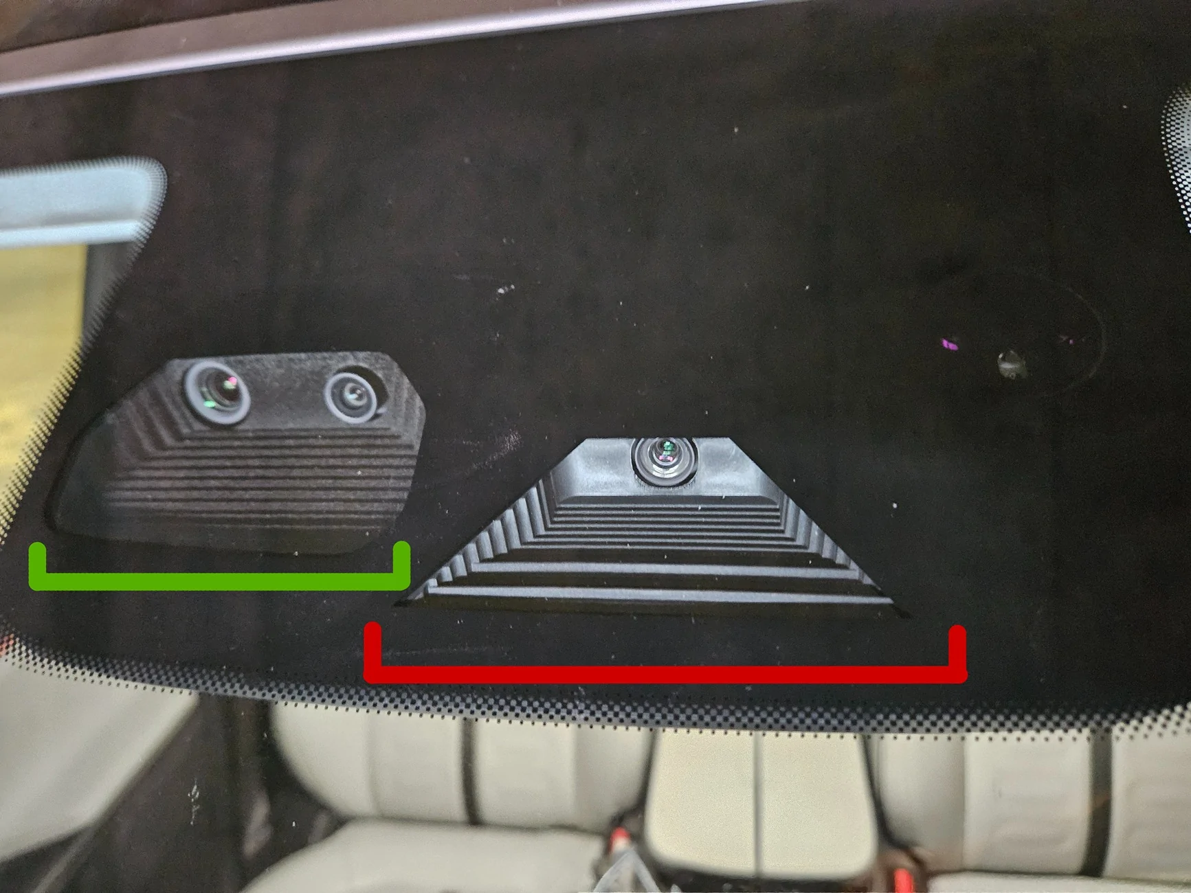

If you look at the windshield on a Gen 2 R1 you can see two separate camera arrays, with different kinds of lenses, different materials, clearly made by different vendors. The single camera unit (The camera marked in red) is likely a mobileye unit. It's similar unit to the one found in Gen 1, though slightly higher end. The cameras in the other housing (marked in green) are presumably then the custom made Rivian cameras they were bragging about at Gen 2 launch.
In my previous testing, I found that ONLY the mobileye camera was used for driver assistance. I found this by using masking tape to cover the cameras. If the mobileye camera was covered, it would immediately pop up a warning on the dash saying that the camera was blocked and driver assistance features were unavailable. So then I tried the opposite. I covered every single camera on the vehicle (mirrors, bumpers... everything), and left ONLY the mobileye unit uncovered. In this scenario there was no warning on the dash, and highway assist worked perfectly, including lane changes. The only thing that was impacted was the driver's screen visualizations. They were pretty inaccurate, with only a bit of mobile eye data and some radar data to go off of.

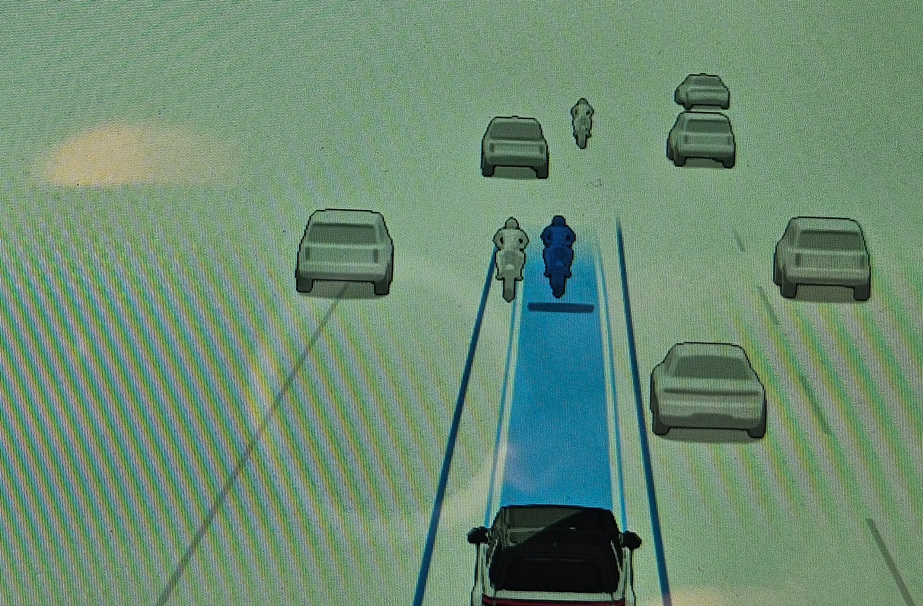

The conclusion that I drew was that the visualizations were (mostly) being driven by Rivan's system, but the actual driving was done by mobileye. Sometimes I was actually able to see artifacts of the two systems operating simultaneously on the screen.
Rivian R1T R1S Why 2025.26.30 update is a HUGE deal for Rivian Autonomy (Mobileye is dead) 20250627_201032
In this photo there was only 1 motorcycle directly front of me. On occasion a lead vehicle would be duplicated, where one was highlighted in blue (indicating this is data coming from the highway assist system showin the vehicle it's following) and the other was not highlighted (probably coming from the Rivian system)

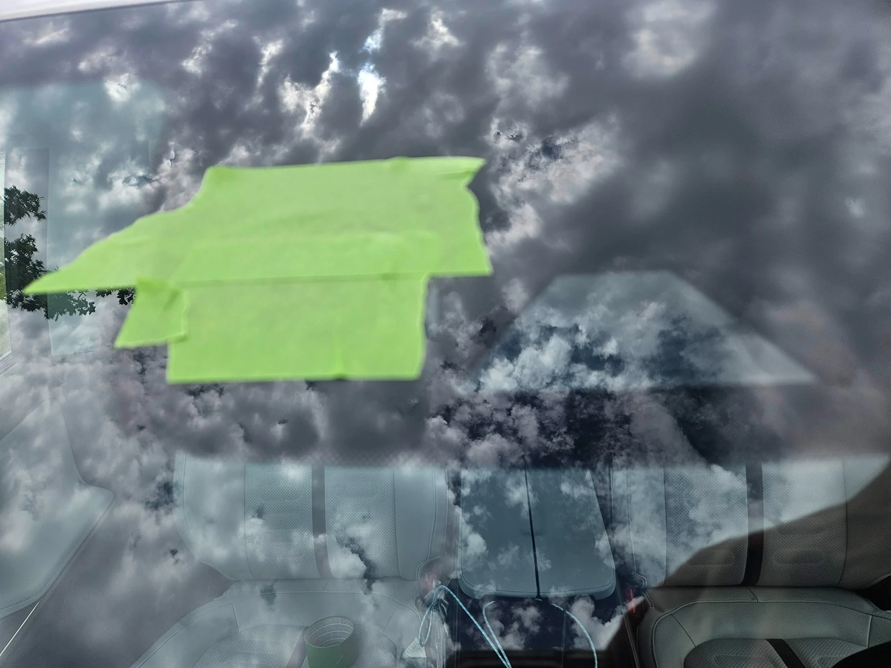

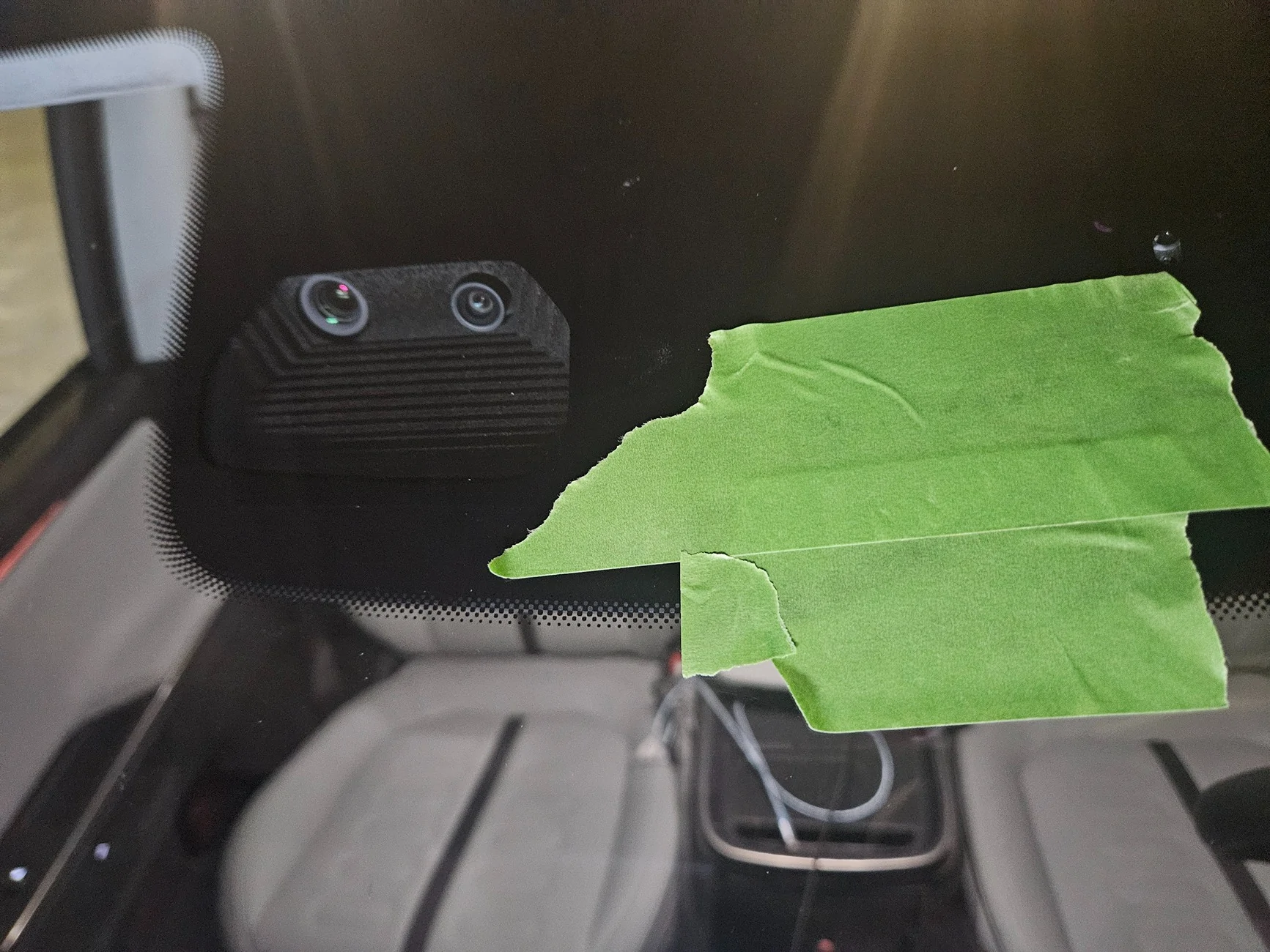

Rivian R1T R1S Why 2025.26.30 update is a HUGE deal for Rivian Autonomy (Mobileye is dead) 20250821_124759
Mobile Eye Camera Covered Up
Rivian R1T R1S Why 2025.26.30 update is a HUGE deal for Rivian Autonomy (Mobileye is dead) 20250821_123528
Rivian Cameras Covered Up (And a REALLLLLY CRAPPY photo of it!)
So I redid the tape test. And this time the results confirmed my suspicion that the underlying highway assist system changed completely under our noses on this update with no mention in the release notes. It was completely opposite behavior from before. Covering the Rivian cameras resulted in an immediate dash warning saying driver assistance was unavailable. Covering the mobileye camera resulted in no warnings. Additionally, highway assist worked perfectly, without complaint.
