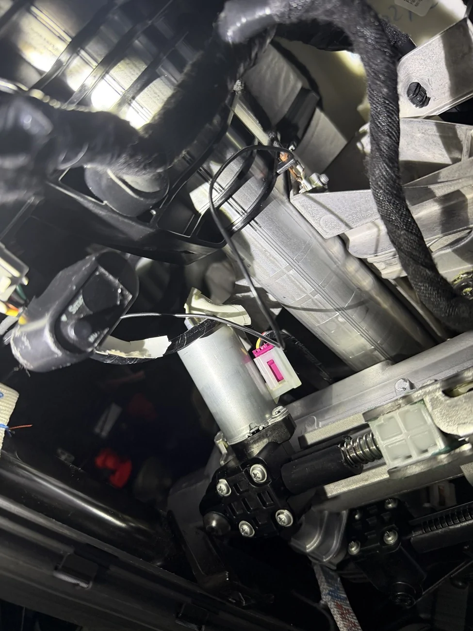

I saw this question asked elsewhere but couldn’t find it again. Confirming there’s no wire or connector in the vicinity of where the under-dash 12V outlet used to be. Nothing left to tap there.

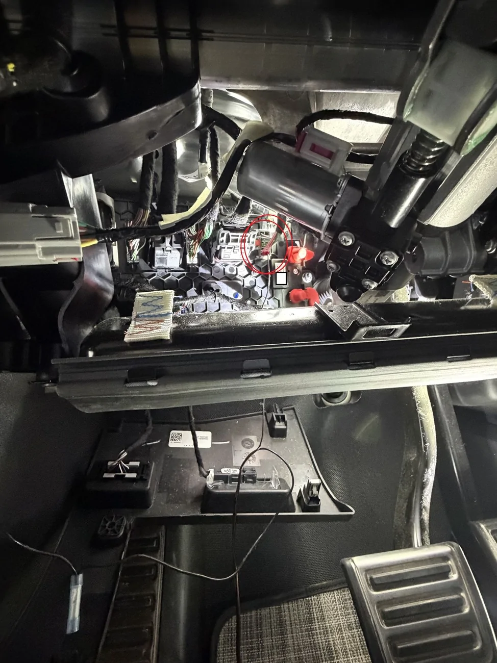

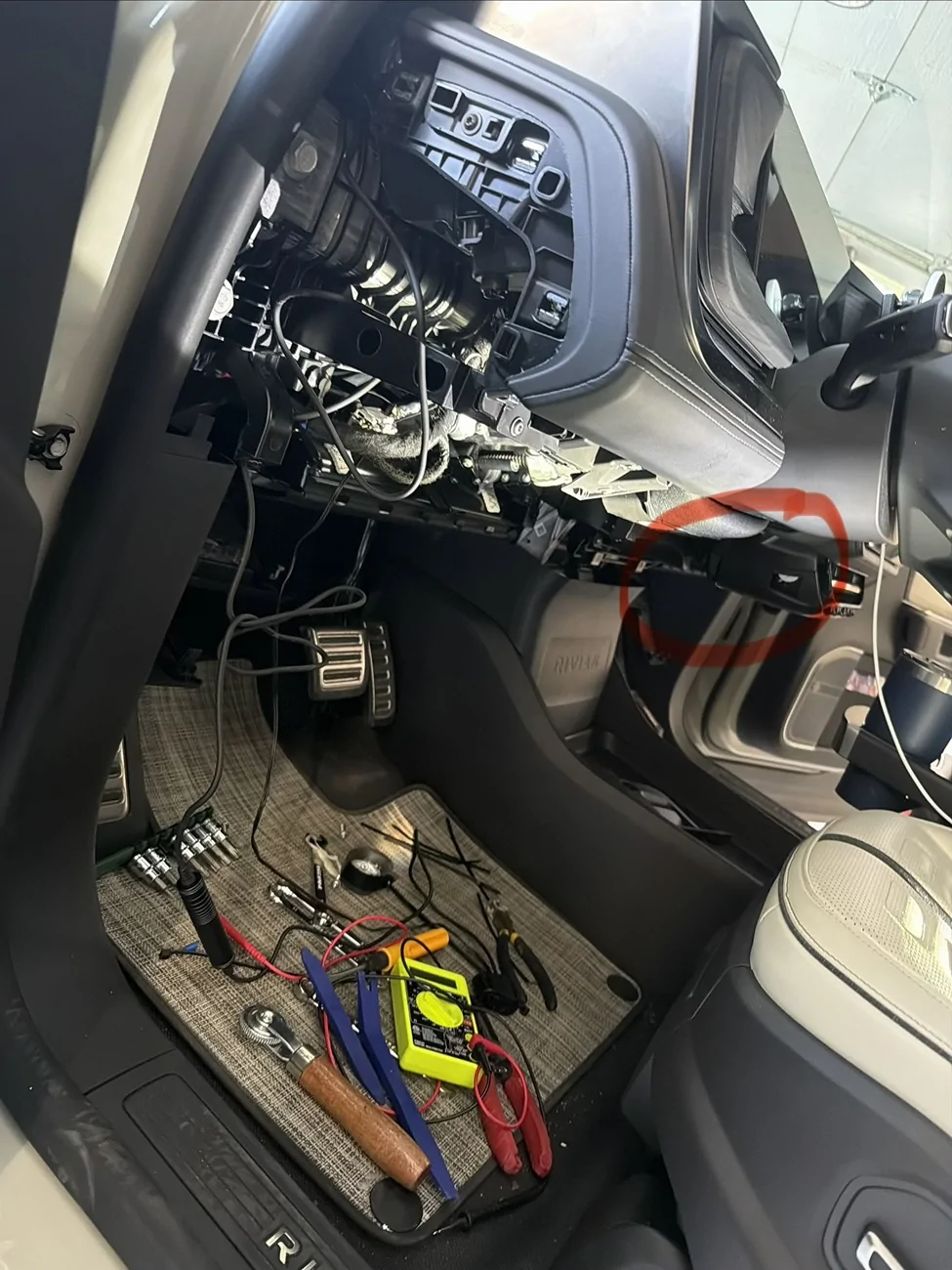

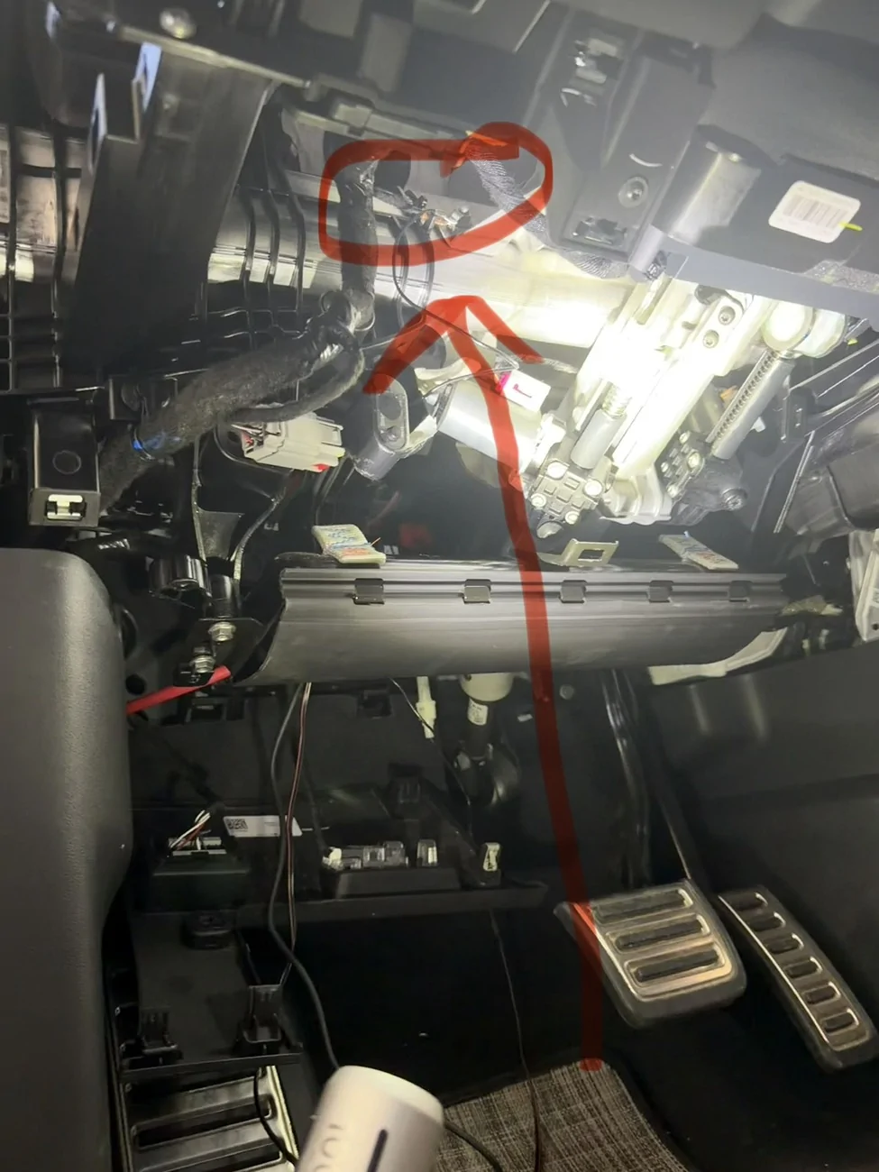

I’m currently tapping into the board behind the driver’s kick panel.
  • It is switched — turns off fairly quickly after locking the vehicle and walking away.
  • Seems to power cycle with the vehicle’s screen (but not always).
  • As of now, it doesn’t appear to be tied to Gear Guard.
  • No phantom drain noticed after 3 days of use.
I’ve tested by walking up to the truck both with and without my phone. With auto unlock off @ Home, it stays powered down until the vehicle is “woken up” (unlock or door handle pull). When out - it seems to walk with the door handles popping out.

[*]No 12V Outlet or Wires:
Rivian R1T R1S Tapping a Switched 12V Source – Info for Those Still Searching (25 Gen 2 Tri Max) No Outlet - or wires

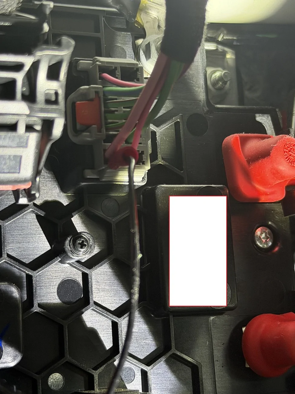

[*]12V Tap:
Rivian R1T R1S Tapping a Switched 12V Source – Info for Those Still Searching (25 Gen 2 Tri Max) 12V Tap Zoomed
Rivian R1T R1S Tapping a Switched 12V Source – Info for Those Still Searching (25 Gen 2 Tri Max) 12v Ta
[*]Ground Tap:
Rivian R1T R1S Tapping a Switched 12V Source – Info for Those Still Searching (25 Gen 2 Tri Max) Ground Ta
Rivian R1T R1S Tapping a Switched 12V Source – Info for Those Still Searching (25 Gen 2 Tri Max) Ground Zoomed

Can't quite make out from your photo - what did you use to make the tap connection? Doesn't look like a clamp / "t" tap?

Used one of these connectors and just shoved it in place. was a tight fit and made descent contact shoved against existing wire - tugged on it a bit and it didnt seem to move at all so im happy with it - also more comfortable than tapping an existing wire

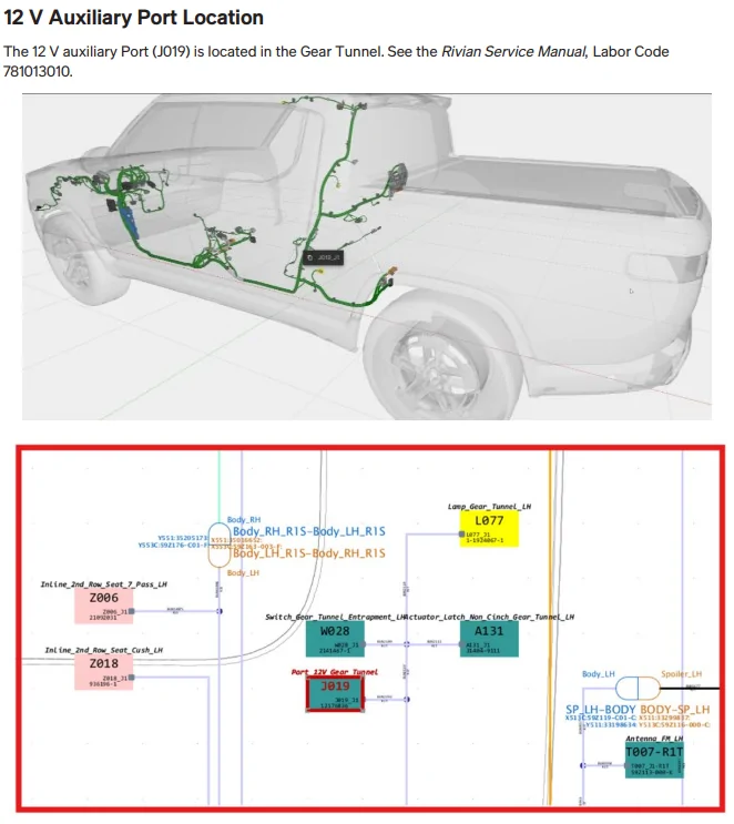

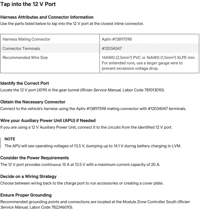

a pickup without a cigarette lighter socket is not a pickup...
Rivian's upfitting recommendations on the R1T is to use the "cigarette lighter socket" that's present in the gear tunnel.
Rivian R1T R1S Tapping a Switched 12V Source – Info for Those Still Searching (25 Gen 2 Tri Max) 1760104960256-js
Rivian R1T R1S Tapping a Switched 12V Source – Info for Those Still Searching (25 Gen 2 Tri Max) 1760105032156-8d

Reposting the upfitting guide that was previously shared.
