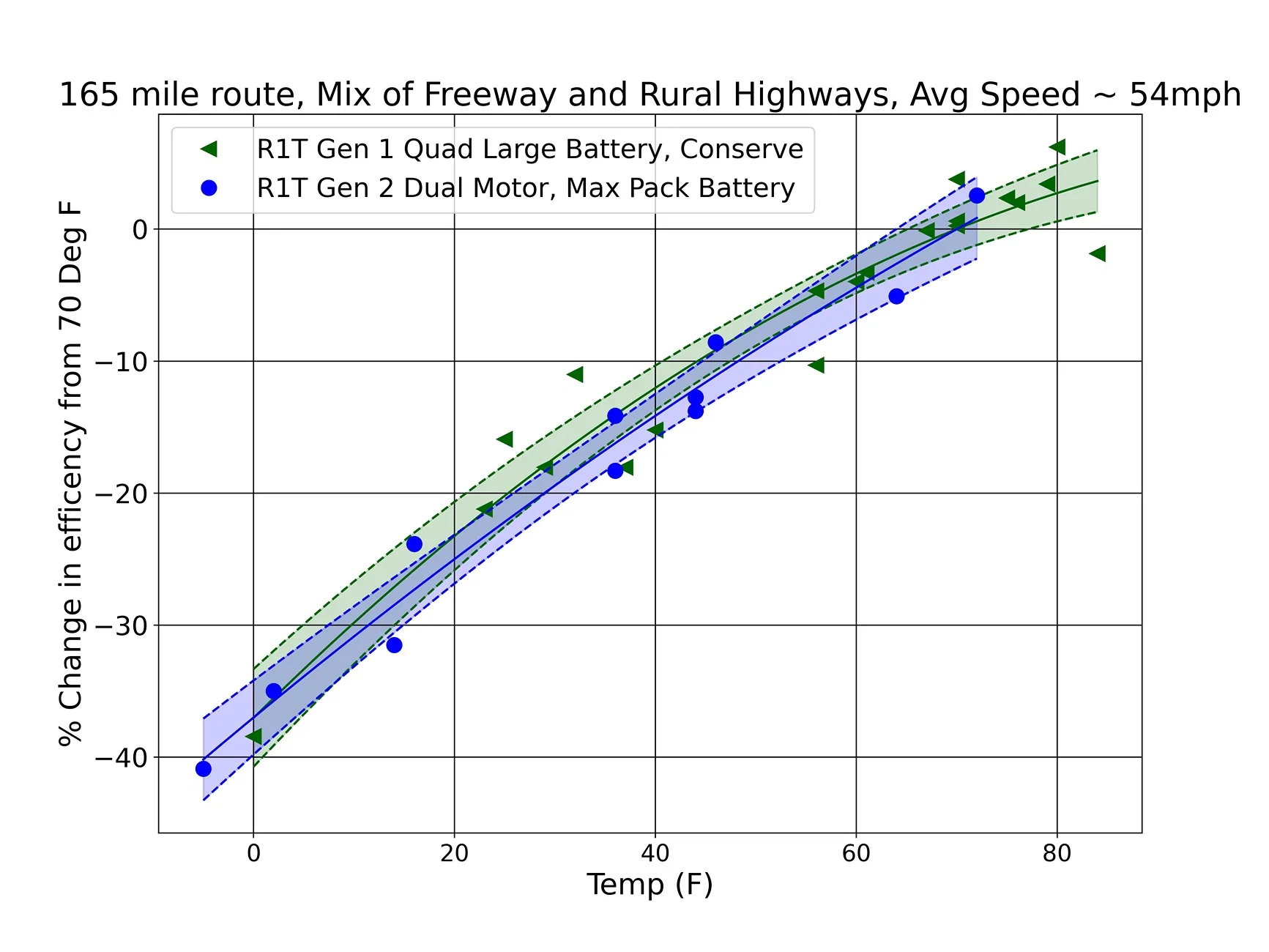

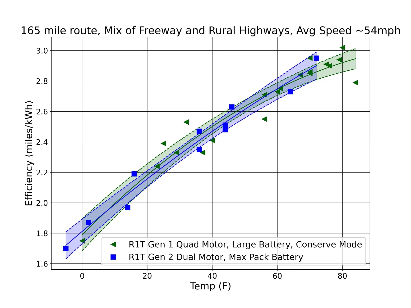

Just understand the loss in efficiency vs temperature and plan accordingly.
I’ve been keeping track for 3 years, my observed percent loss in efficiency vs temperature is shown below. This is for a long trip. Short trips will be worse.

149
13,652
27,689
I drive faster so more of the loss is attributed to aerodynamic inefficiencies than cold temperatures.
This man brought charts. I love folks like you. End thread (just playing, I like the discussion).
