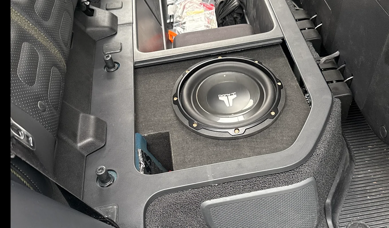

We like to call this "The Tubthumper."
As car guys who like nice sounding audio, even the Meridian systems in our launch edition R1Ts felt... lacking. As it turned out, the anemic OEM subwoofer comes installed in a plastic box, and sorely lacks wattage.
After some finagling, we've come up with this MDF Felted box that makes a WORLD of difference to your truck's audio.
IMPORTANT NOTE: Your truck MUST have a subwoofer for this kit to work. This means "Meridian" or "Rivian Premium Audio". If you have just the stock audio system, it lacks the needed outputs and wiring for this kit to be installed.

Any thoughts about just upgrading the speaker with a slightly larger speaker? Without all the other stuff? 😆
Can't fit anything else into the stock cavity. Let alone the OEM amp wouldn't be specced for it. This isn't a crazy install. Some people may think its a crazy install but its really quite straight forward, and not crazy in anyway.

For anyone that looked right away and looked up the subwoofer that was recommended, there was a typo. You probably saw a $900 price and just went away.... They updated the listing to show the correct one now. Please come back .....
What about the step up, JL Audio 8W3v3-4 at $349? Does that fit?

US
Awaiting R1T
Yup that should work. Perfect size for the box we designed.
Thanks. What’s the volume of the (presumably sealed) sub box?
