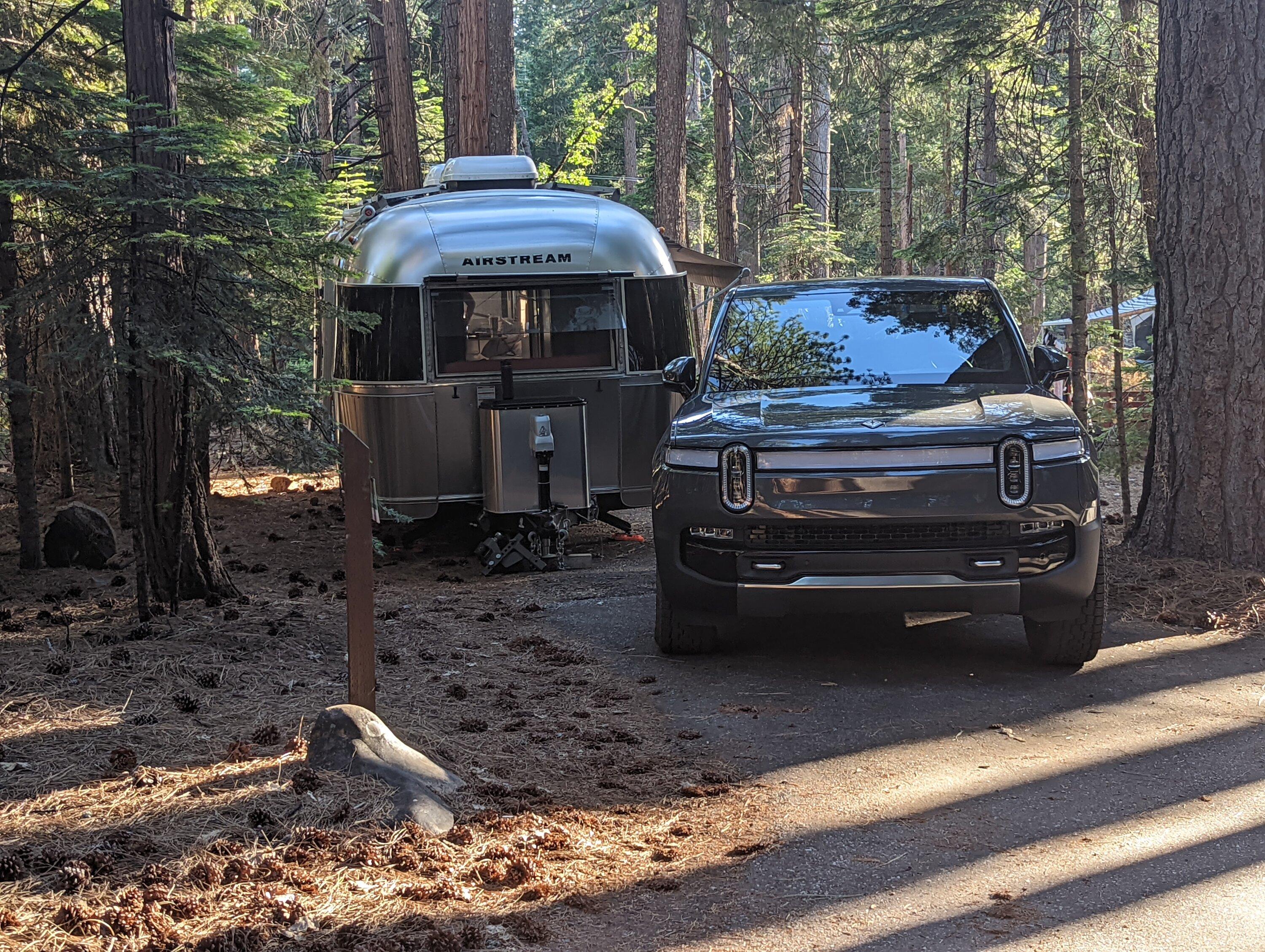

I thought I would share some details of a quick trip we took this weekend. I got my Rivian delivered Friday, 6/24, so of course I have to go give it a good run.
Rivian R1T R1S Trip Report - towing 6000 lbs 25' Airstream trailer from NV over Donner Pass to Grass Valley, CA PXL_20220625_012009734

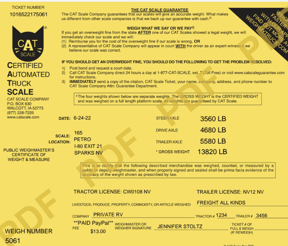

Reno is at 4500 feet, Donner Pass is 7000 ft and then back down to the campground (White Cloud) at 4200 feet, 86 miles one-way. Trailer is a 25 ft Airstream with a full tank of water (40 gallons).

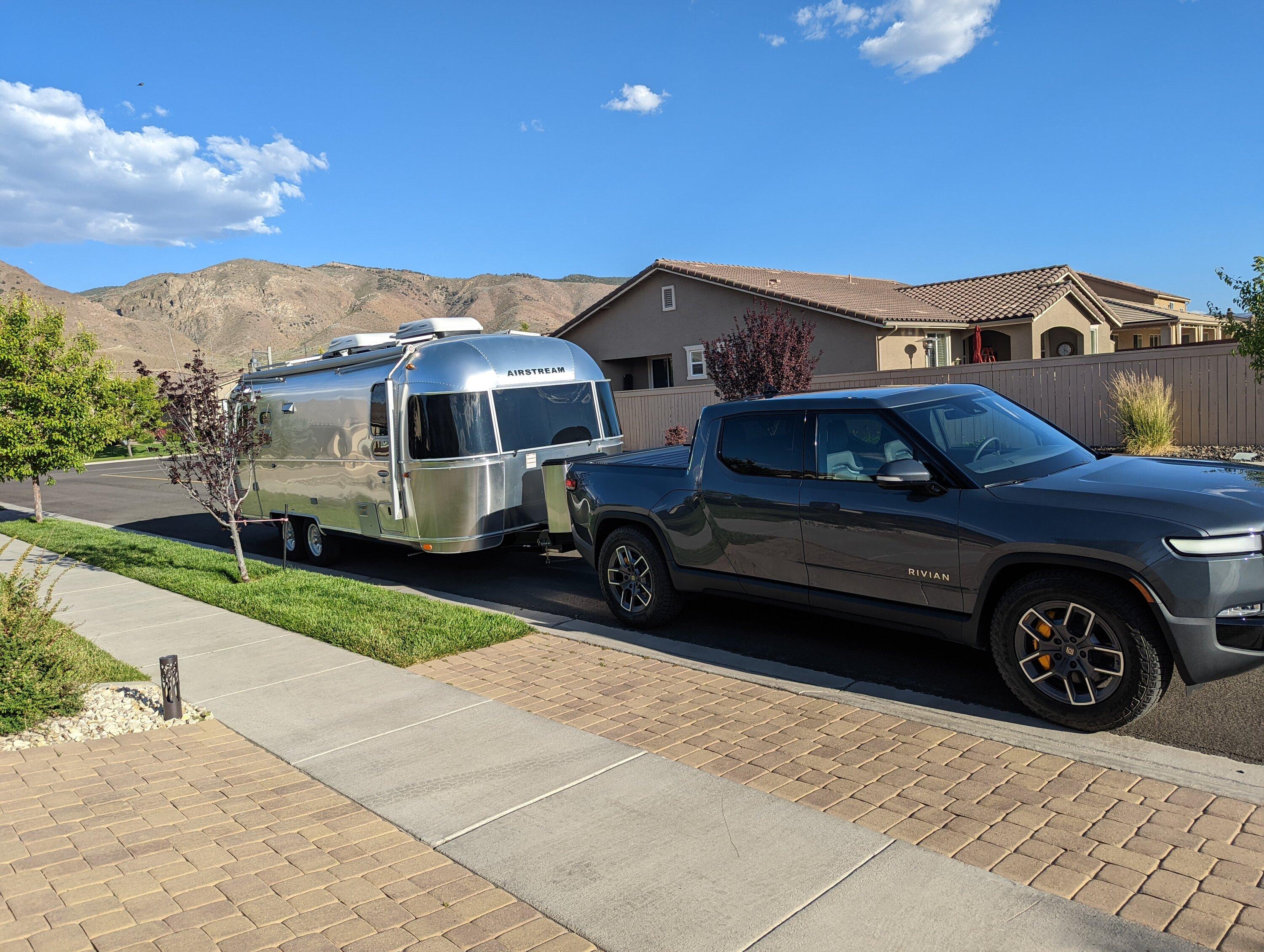

Dropped the trailer at the campground and then made a few trips to Grass Valley about 16 miles away. We tried charging at a Charge Point charger but only got about 30 kW on the 62 kW charger. We went back on Sunday and used the other charger and got the full 62 kW charge up to 70%, taking about 45 minutes while we ate lunch. Picked up the trailer and headed back over Donner rolled in to Truckee with about 29% charge. The EA chargers were open and was able to park the trailer without blocking too much of the road and not any of the other chargers. We charged at 150 kW for 20 minutes to get to 62% charge, plenty to get us home to Reno. Rolled into the driveway with about 40% charge left.
Rivian R1T R1S Trip Report - towing 6000 lbs 25' Airstream trailer from NV over Donner Pass to Grass Valley, CA PXL_20220626_020300011
Rivian R1T R1S Trip Report - towing 6000 lbs 25' Airstream trailer from NV over Donner Pass to Grass Valley, CA Screenshot_20220627-124923
Overall, very happy with the towing experience. I was surprised the range wasn't impacted as much as I thought going up hill. The only issue I thought was weird was having the regen restricted going down some of the longer-steeper roads.
