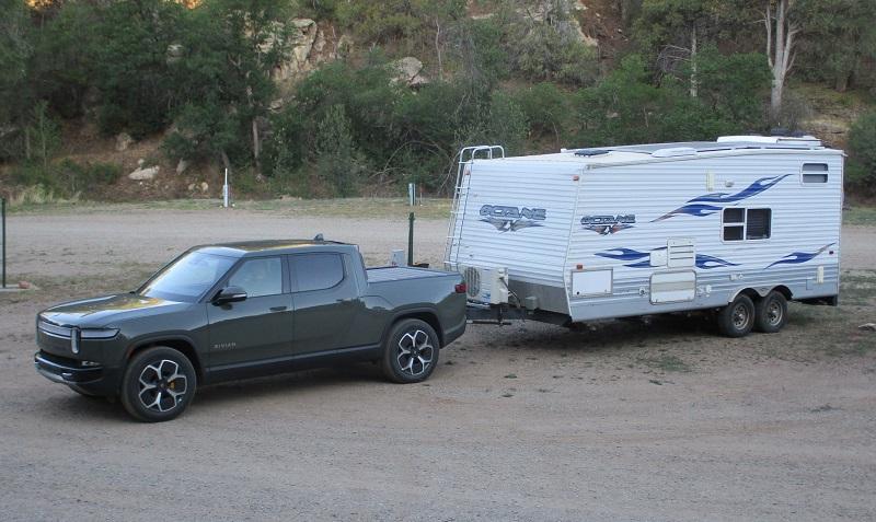

We picked up our R1T back in June, drove it from the IL factory to NM, and immediately hooked up our house (a Jayco toy hauler) and set off on a driving tour. Through CO, WY, MT, UT, and back to CO. We had a great experience and learned a lot along the way. Very happy with the truck and its towing ability! Obviously with a 7000+ pound travel trailer in tow, we see a drop in range - it's doable but you kind of have to want to (we're committed to electrifying as much of our life as possible), and we are adapting as we go.
Some photos and stories:
https://marcy-twss.blogspot.com/2022/09/rivian-towing-first-experiences.html
Rivian R1T R1S Towing our home with our R1T - trip report 2022-09-16 First Rivian tow photo.JPG
Marcy, thank you for the beautifully-written blog post and the great pictures which add to the story!
