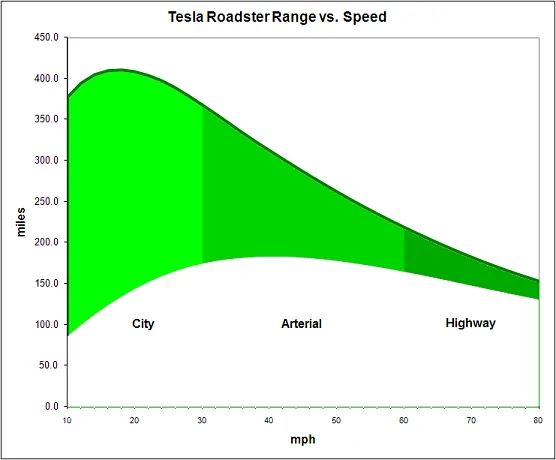

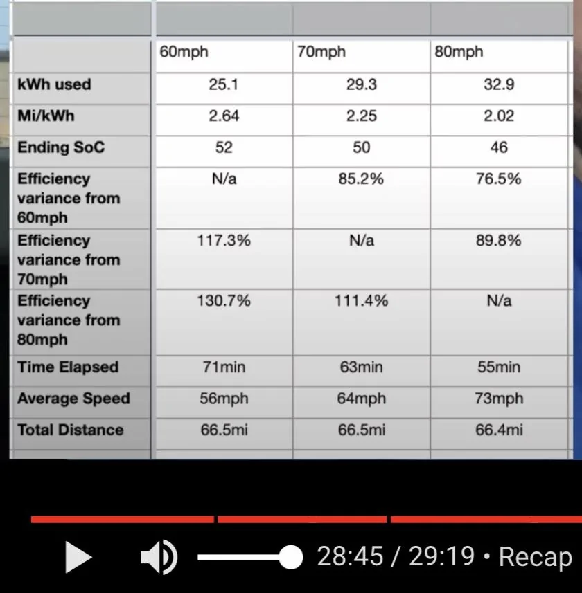

Thanks for the real-world info! So, compared to 60mph, the R1T loses 15% at 70mph, and 24% at 80mph.
The numbers are pretty close to what I'd expect from experience with past EVs. In 2010 I made this chart on Tesla Roadster range-versus-speed (with HVAC thrown in). It shows that the Roadster lost 18% at 70mph and 30% at 80mph. It probably (?) lost a higher percentage to aero than the R1T because it was more efficient to start with.
Rivian R1T R1S How Much Does Speed Impact Range? Testing Rivian R1T at 60MPH, 70MPH and 80MPH teslarang
(The top, dark-green line is expected range at the given speed with no HVAC. The shaded area below it shows how much range can be reduced at that speed given various levels of HVAC - the HVAC's relative effect grows smaller at higher speeds as the aero hit grows and the time spent running HVAC shrinks. Note that the Roadster had a resistive heater and an option to take the top off - so it could use a lot of HVAC energy).

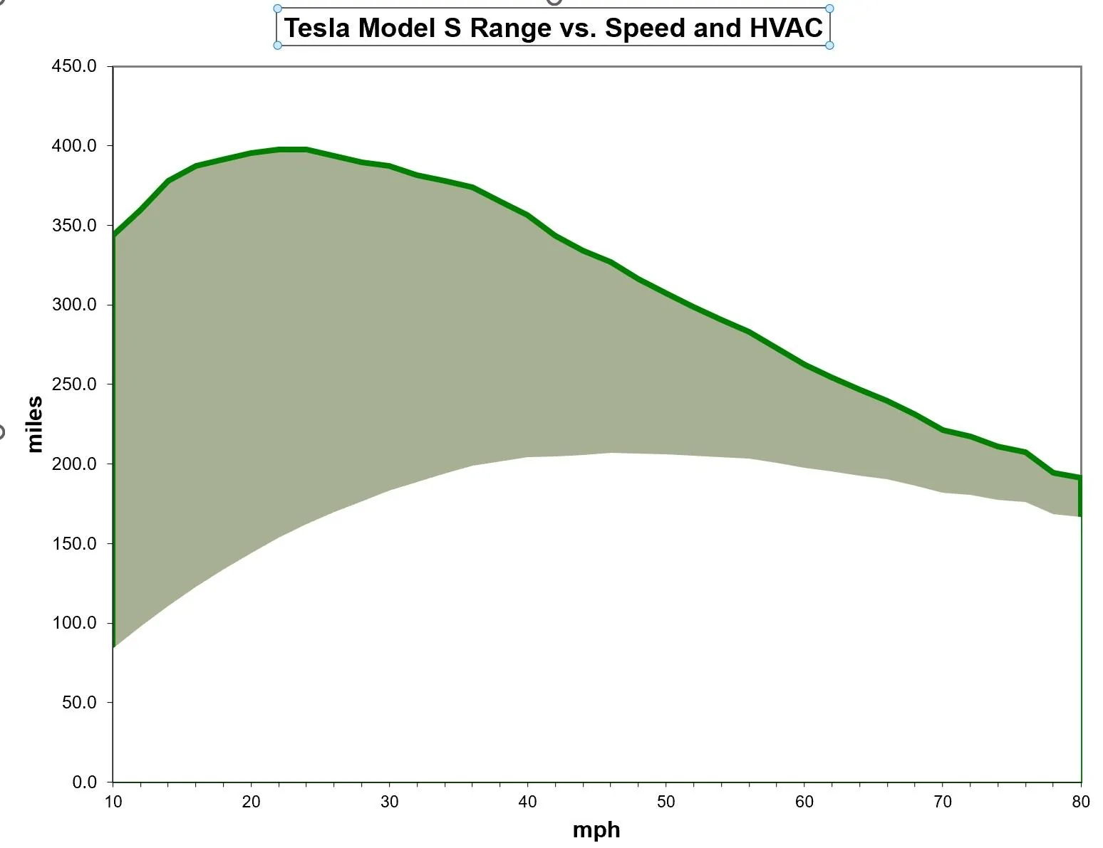

In 2012 I did something similar for the Tesla Model S. It lost 15% at 70mph and 27% at 80mph.
Rivian R1T R1S How Much Does Speed Impact Range? Testing Rivian R1T at 60MPH, 70MPH and 80MPH modelsgraph

So another way to look at this is 16 min faster to travel the same distance at 80 mph and 7.8 kWh difference. Real-world, you'll take on 7.8 kWh in a shade over 3 minutes at 150 kW. So unless you're really range-constrained on a particular route, you'll still save time by traveling faster. Thanks for doing this, @branden!
I actually added charging and total trip time to the spreadsheet I have linked in the pinned comment of the video
