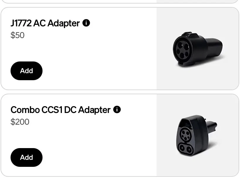

What is the difference between these 2??
Top one is for AC charging, bottom one is for DC charging.
AC is what you'll typically find at a home or hotel. It's slower to charge-several hours until full. DC are the really high speed chargers you typically find along the highway (think Ionna, Electrify America, etc). DC charge the whole battery in roughly an hour (well, not if you are trying to go to 100%)
The $50 one is for level2 charging, like what you will install at your house or some hotels, it is J1772-J3400.
The $200 one is what you would use for DCFC like at Electrify America locations. I have the link there for A2Z CCS1 to NACS as well, less expensive than the Rivian option but still a solid choice.

CCS1 is a combination of J1772 and the 2-pin oblong. NACS is the only format that does AC and DC with one plug/receptacle.
You can pretty much ignore CHAdeMo. Japanese invention and used by older Nissan LEAF. Soon to be phased out in the US.

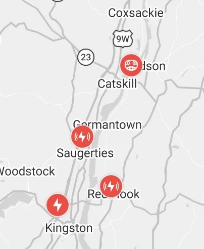

Tesla still has quite a few Magic Dock stations, some of their V4 stations are Magic Dock as well.
You can look at the Tesla Supercharger map and filter on the 3 types of chargers.
1) Lightening bolt is Tesla only
2) NACS image is open to others with required adapter
3) Lightening bolt inside double parenthesis is Magic Dock locations
Here is a sample of all 3 locations.
