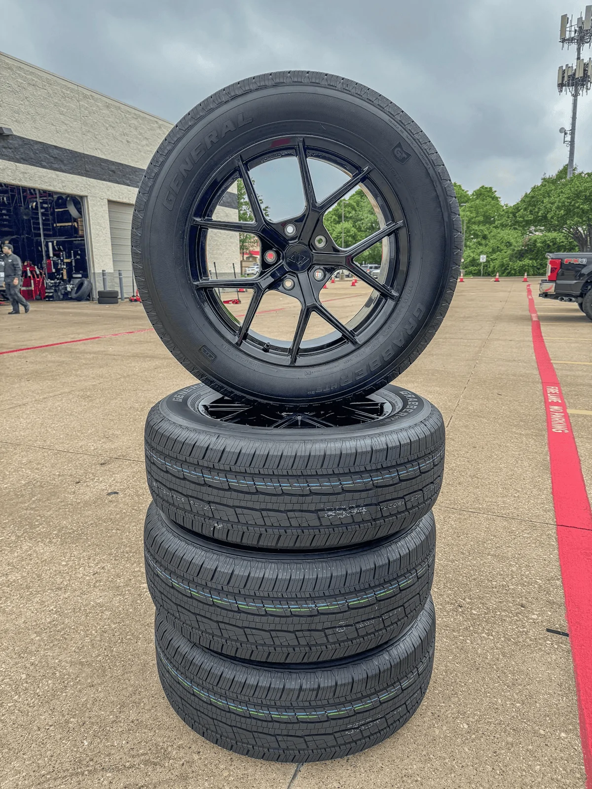

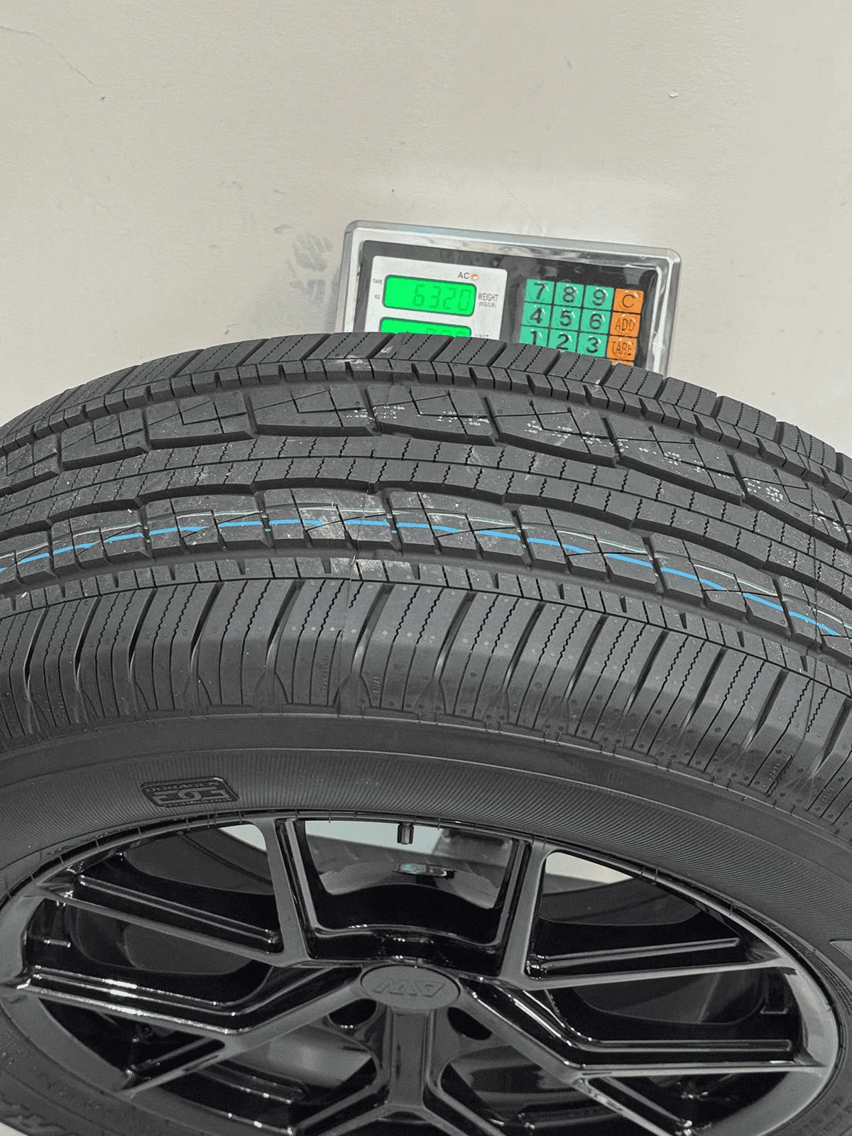

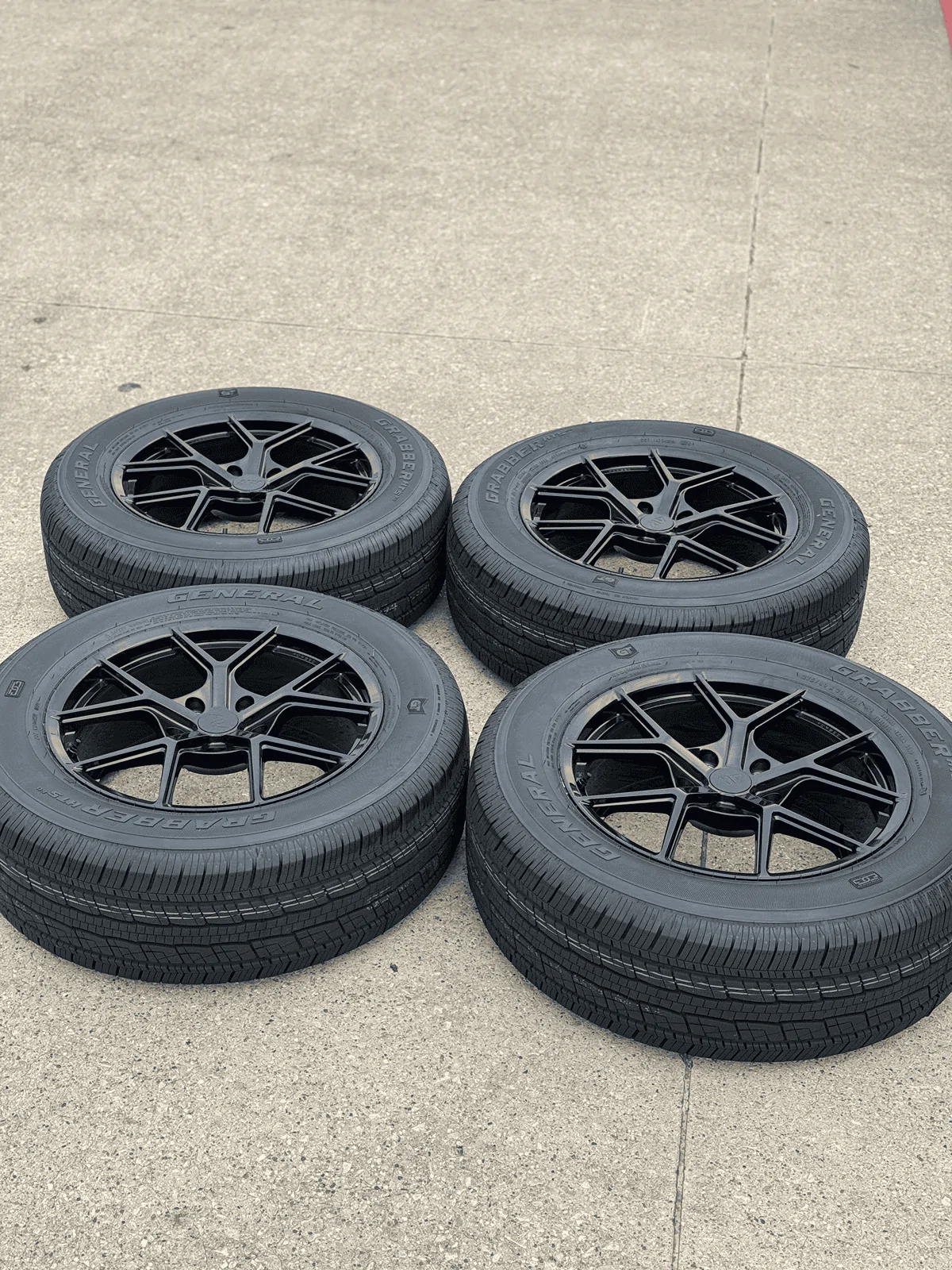

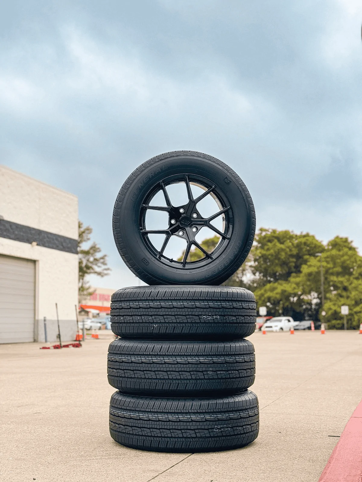

After reviewing the thread, we decided to make tire package with a combo of lightest rims we have and the most efficient tire.
We have assembled the most weight-efficient combo of [AW01] 20x8.5, General HTS60 275/60 R20 116T, & TPMS. The weight is only 63.2 LBS per wheel!
The door-to-door price of the set is $3950.
This product has not yet been listed on our website.
Please contact us for more details or to express interest.
