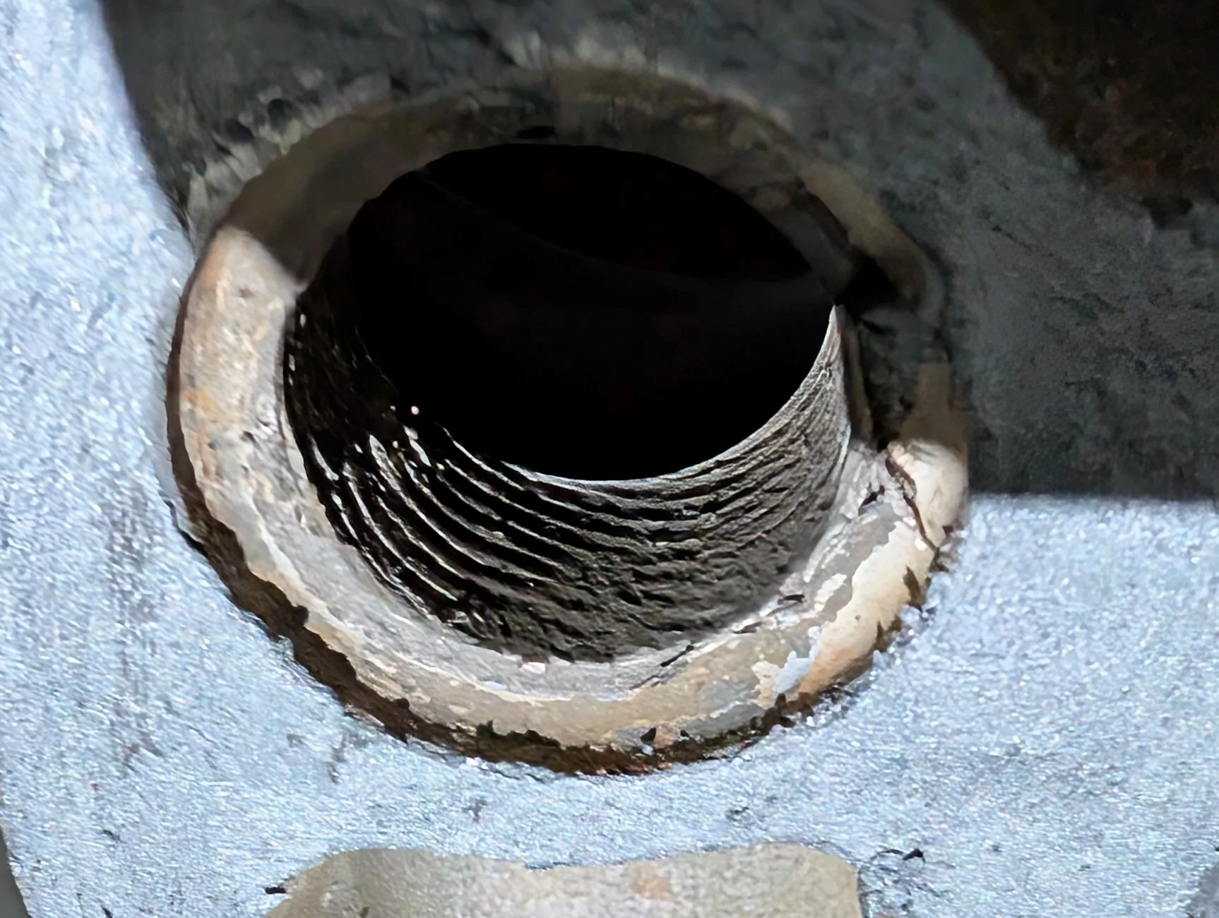

Should I be worried that I may have put some thread marks in my dodge wheels last winter...? Its possible I'm just not remembering that damage from my purchase but looks fairly new and mine were pretty beat up inside so the hub rings don't fit them snugly.
Where is this? On the inside of the bolt hole?

How strange, I've never noticed on mine, which I've switched on and off a few times. I'll take a look at my AS set in the garage tomorrow, but I suspect this was there before you mounted.
You didn't have yours sandblasted or powdercoated, right? That's one pro to doing that, a lot of surface damage got smoothed and sealed.

No, I was going for the cheapest of cheap temporary setup. (my set was pretty clean on the outside too)
I like my MSW wheels so I'm tempted to get another set of those and swap out to reduce poke and increase range/cleanliness. These fling a whole lot of slush out of the wheel well when I turn.
Ram's have been a happy solution while the aftermarket companies caught up to the fitment so I'm glad you were able to spearhead this option.
I assume the threading was old damage I never noticed since I gave them a very good once over for cracks and cleaned them up but surprised I never noticed.
I also antiseize the heck out of all the wheels I change after having a couple bad roadside spare situations where I couldn't break them free many years ago. So between that and the loose hub ring I was worried there was maybe too much slop to handle the torque. But hasn't been loose when torqued checked so not stressing much after 4k miles without a wheel falling off.

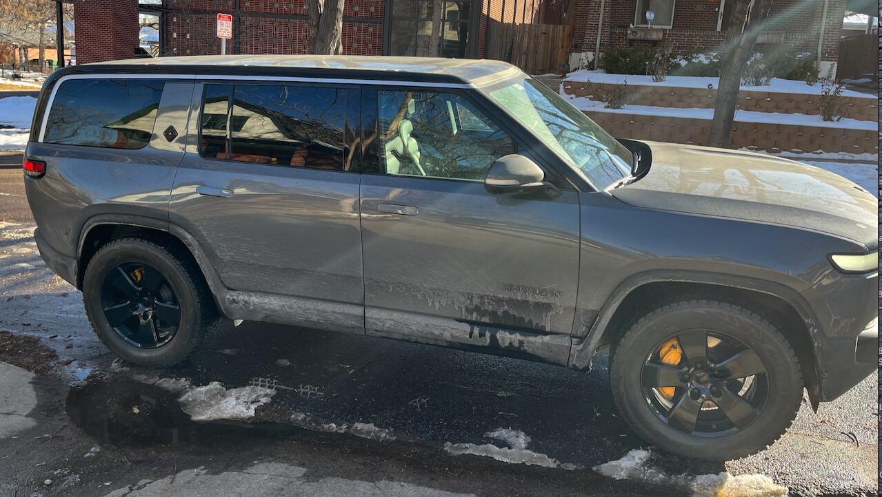

Completed my 2363 winter setup yesterday:
Wheels: $500 (craigslist, freshly powder coated by previous Rivian owner)
TPMS: $157 (RDE232V26 off eBay)
Center cap: $25
Hub centric rings: $15
Bridgestone Blizzak DM-V2 275/60R20: $1162
Mount/Balance: $120
TOTAL: $1979
No issues so far, TPMS sensors automatically synced to vehicle within 1hr. Speedo is off by 3-4mph at highway speeds because my summers are 275/65R20 Nokians, but I'm not going to pay Rivian to reprogram twice per year. I can finally stop with regen without sliding all over the place!
