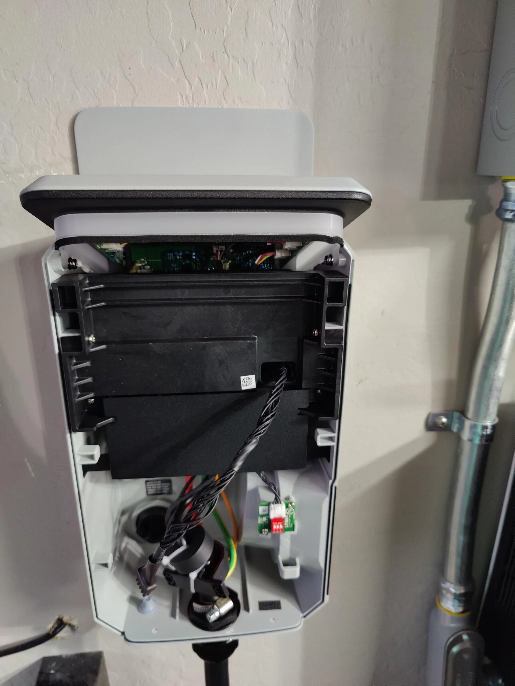

Some progress....this showed up today.....48A install......
Out of curiosity, does this have to be hard-wired? I have an existing 220 in my garage and was told by my Guide that I could just mount it to the wall and plug it in rather than a traditional hard-wire. This doesn’t seem to be the case based on the picture.
Depends on your local electrical codes. You could, in theory, attach a NEMA 15-50P pigtail to it and plug it in. This generally requires a GFCI if it isn't hardwired or above a certain amperage.
This is the most accurate response. Wiring in a NEMA-50 pigtail is simple, which coupled with a 50A breaker will allow for a 40A configuration on the wall mount charger. GFI will be local code dependent (not required in my municipality).

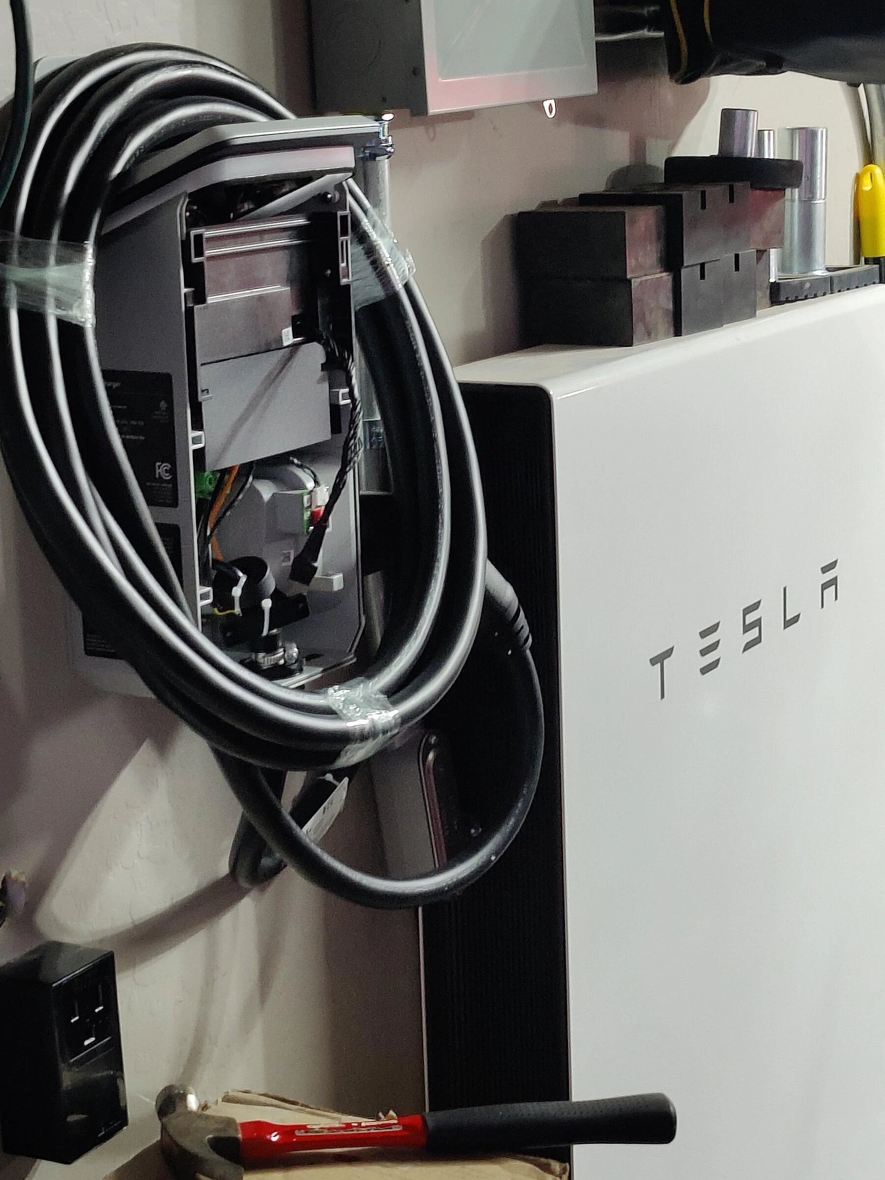

If you want the max charging rate then you'll need to direct wire and utilize a 60A breaker, which will allow for the max charge rate of 48A. I swapped out my Siemens L2 for the Rivian to gain a much higher charge rate, so I had to upgrade breaker from 50A to 60A and run 6AWG thhn (a whopping 6ft run).
Rivian R1T R1S Any "March-April" delivery people contacted? IMG_20220322_184940
Rivian R1T R1S Any "March-April" delivery people contacted? IMG_20220322_184429

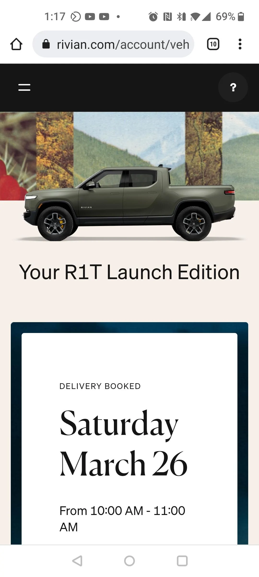

Houston we have lift off!! Delivery scheduled for Saturday 3/26 @ 10:00AM......the last week was more challenging than the first 39 months!
Rivian R1T R1S Any "March-April" delivery people contacted? Screenshot_20220323-131727
