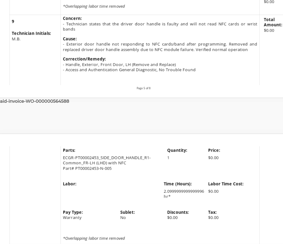

I bought my R1T used and ordered key cards (as it only came with a fob). When the service center went to program them they found they wouldn't work so replaced the handle. Has worked fine since.

Mine worked fine for 6 months. One day it stopped working. Mobile service came out and replaced handle and it has worked great since then.

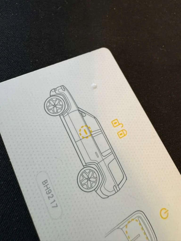

Ended up being a bad key card. Wife drive the body shop today with her key card and that worked fine. Even the wristband worked without issue.
Is their any kind of warranty on these cards?

One of mine died this week. Left wife stuck and yelling down the phone at me until I was able to set up access on her phone... Looking online seems it's common with various car brands that use these cards - BMW, Volvo etc. The microcell battery in the card gets too hot or bent and ruptures - you can see the bubble top right here. Car is only a few months old so seeing if there's any warranty on the cards now...
