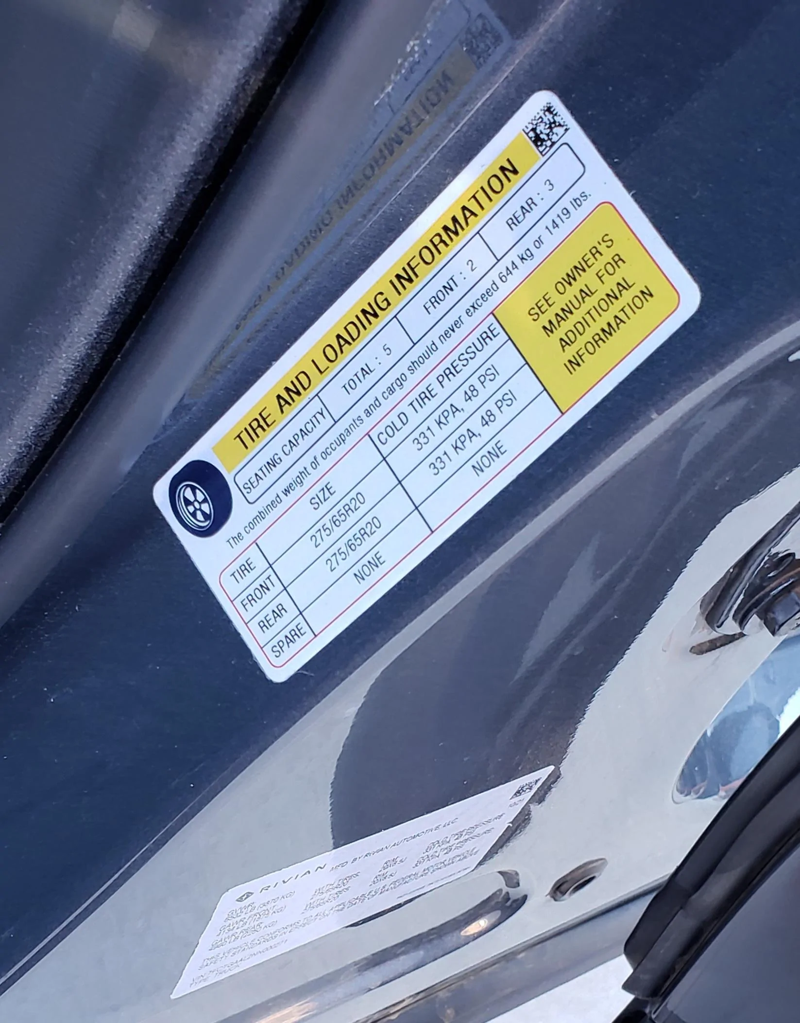

I've asked Rivian to clarify on multiple occasions...all they will state is 1,760 lb. That I'm guessing is for the Explore trim, 21" wheels, and no off-road.
What we do know on the numbers:
Motor Trend weighed a R1T with 21" wheels and off-road package = 7,150 lbs - 8532 lbs GVWR = 1,382 lbs left for payload.
Someone was kind enough to take a picture of one of the R1T's out in the Sonoma First Mile event. This was an R1T, LE with 20" AT's and Off-road package. Weight difference in the 20's & 21" is minimal, maybe 24 lbs, so most of this off-road package. The manufactures label is 1,419 lbs.
Rivian R1T R1S Anyone else completely disappointed that MaxPack battery not available until 2023? Rivian sticker

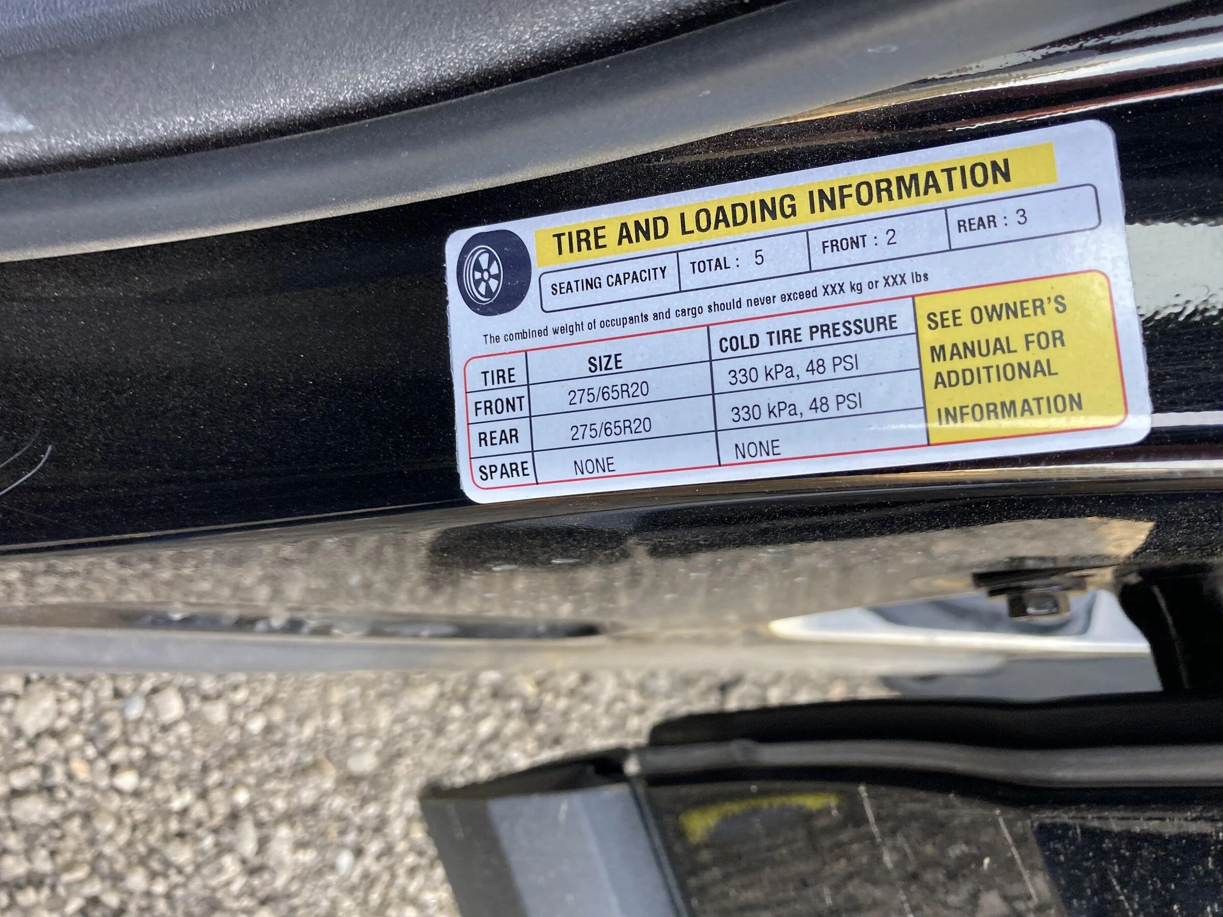

Ha. That's interesting. I took a photo of the R1T I drove in Sonoma and look at what I got:
Rivian R1T R1S Anyone else completely disappointed that MaxPack battery not available until 2023? IMG_1531

I'll note that wheels and tires typically do not impact max payload due to what they weigh because they are unsprung weight (suspension, body etc. don't hold up that weight). Wheels and tires typically only impact max payload due to the wheel and/or tire having a lower capacity. Rivian uses passenger vehicle tires, like all 1/2 pickup trucks do nowadays, to provide a less harsh ride. Most people that haul max payload, tow max, or drive on rocky trails will swap them out for LT (Light Truck) tires which are Load range E rated (rather than Load range C like a passenger rated tire) and more plies and puncture resistant and have the LT designator in the tire size.
All pickup manufacturers advertise the highest max payload that one specific model gets and then most trims are much lower. Rivian seems to be the same with their advertised 1,760 being the max but many trucks will be less depending on options. The only confusing part there is there are not many options for the Rivian that add weight. If the advertised max payload is 1,760, that means that the truck with the 1,416 lbs max payload sticker has either 341 lbs of optional accessories or it has a tire and wheel package that won't support the GVWR (weight of the truck plus the max payload), so it is de-rated only due to tire and wheel capacity.
In the image with the max payload sticker (copied below), the second white sticker further below and on a different plane is the sticker with the really interesting info. If one opens that image and double clicks to expand it to it's largest, I can see it lists GVWR (Gross Vehicle Weight Rating), Gross Axle Weight Rating (GAWR) Front, GAWR rear, etc. but can't make out the numbers. That is the sticker I'd like to see. Missed opportunity! Ha.
