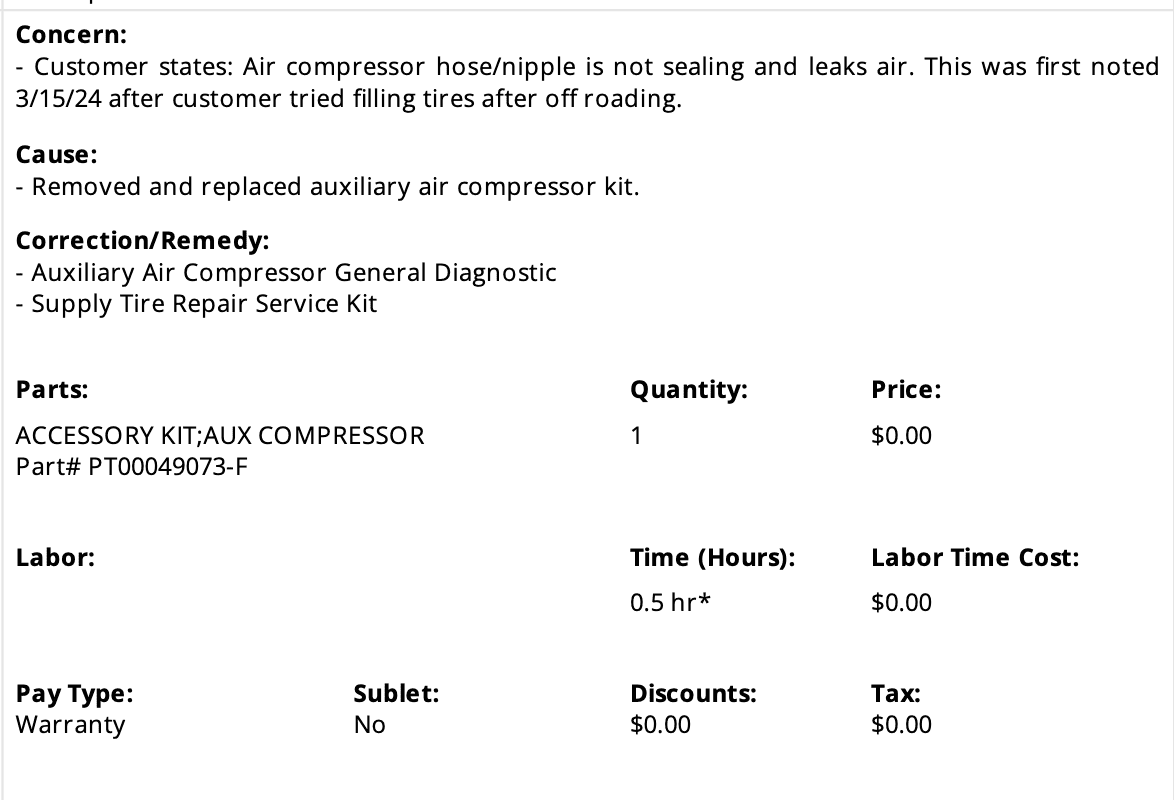

Anyone have issues connecting air compressor hose?

I still have this issue. Had to schedule service and when I drove it in the tech said this could be fixed by a mobile tech. Gee, if only the Rivian app offered that option! He’ll be here next Tuesday and told me via phone that was “not uncommon.” Has to add a part to extend the connection further away from the body. Of all the things that could go wrong this is small potatoes. Still, I don’t see why I should have to buy aftermarket hoses. I’d like to get what I paid for.
