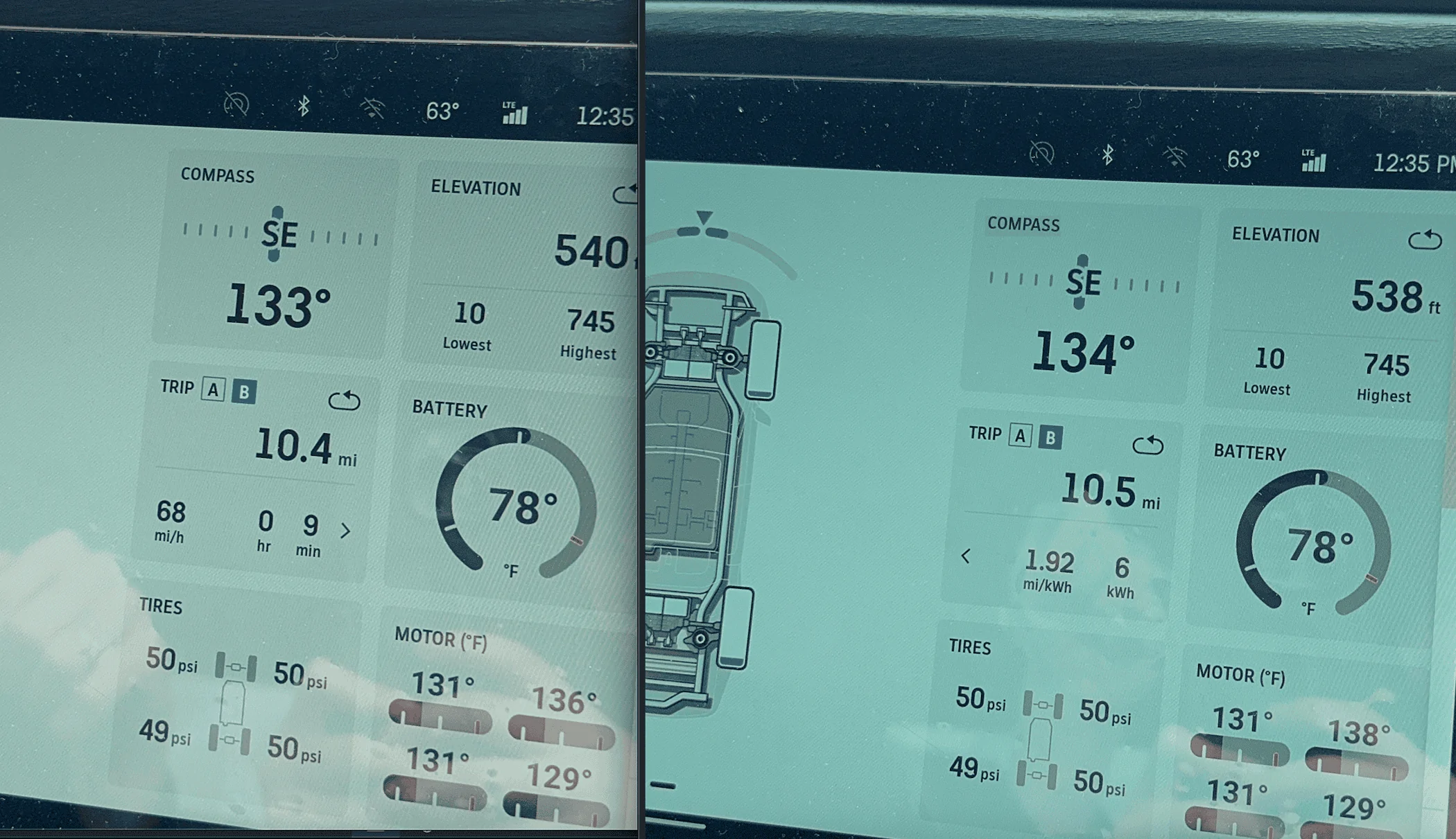

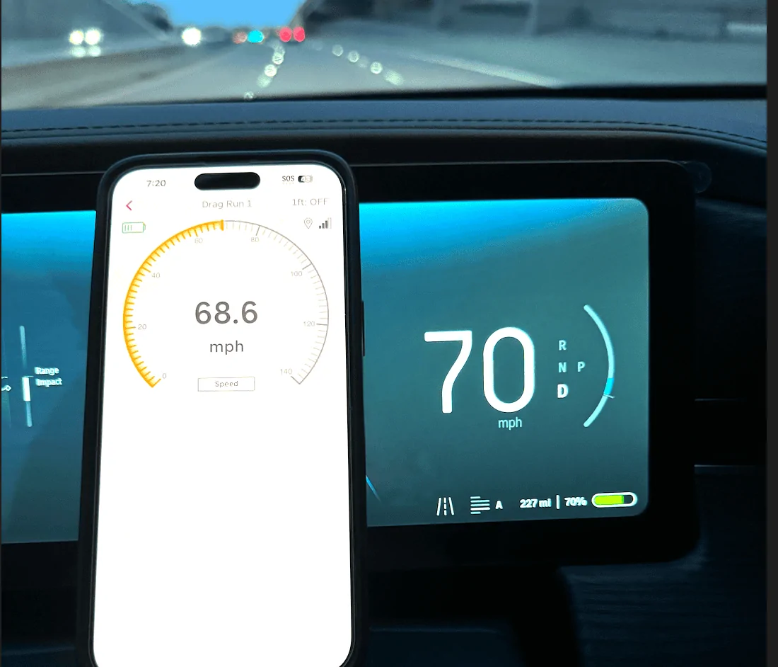

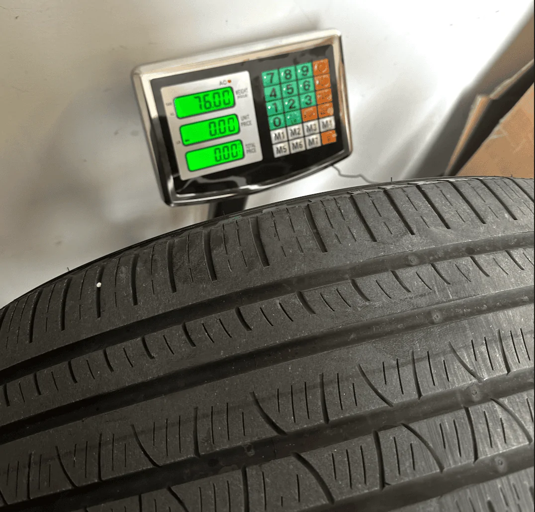

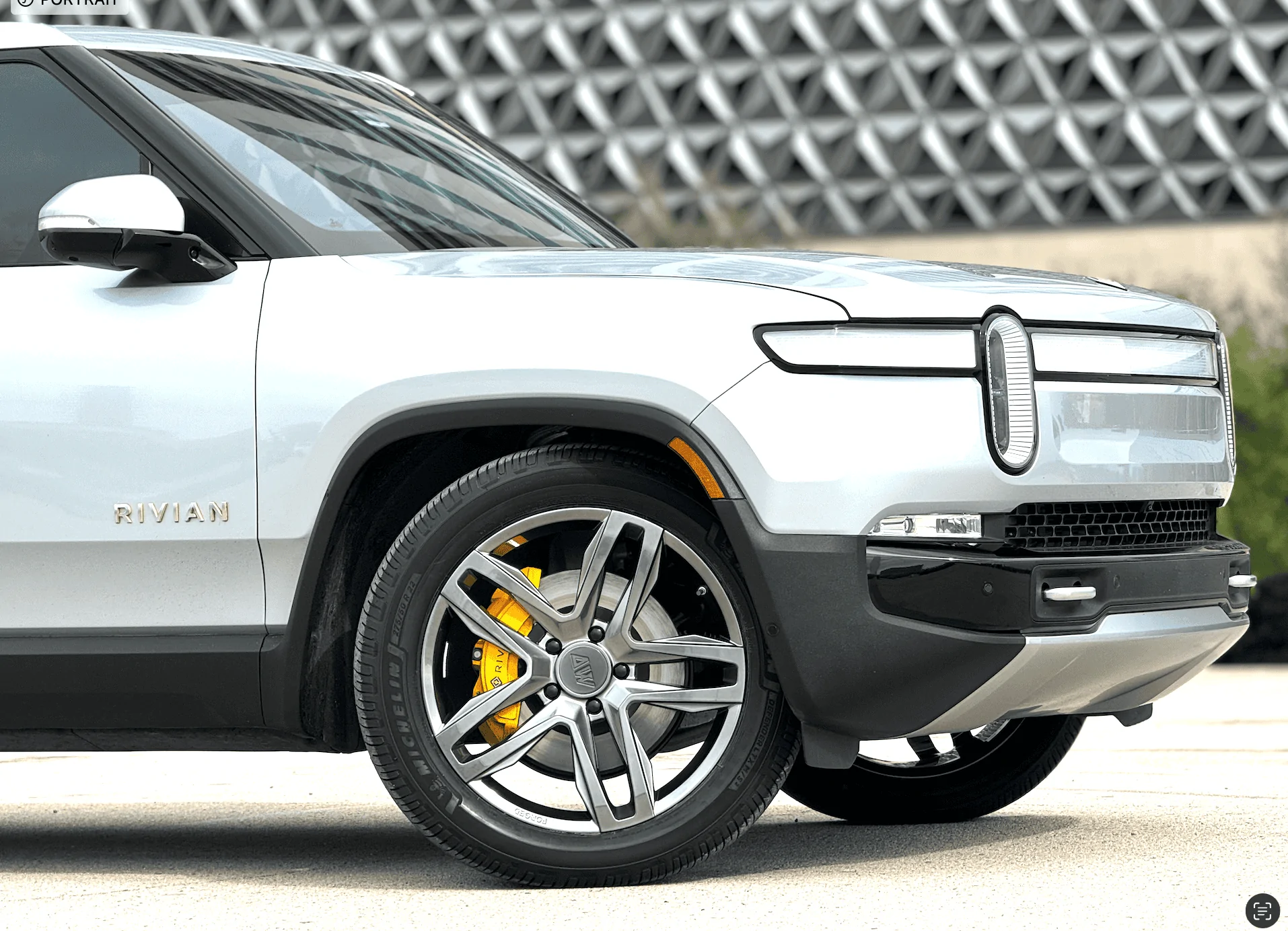

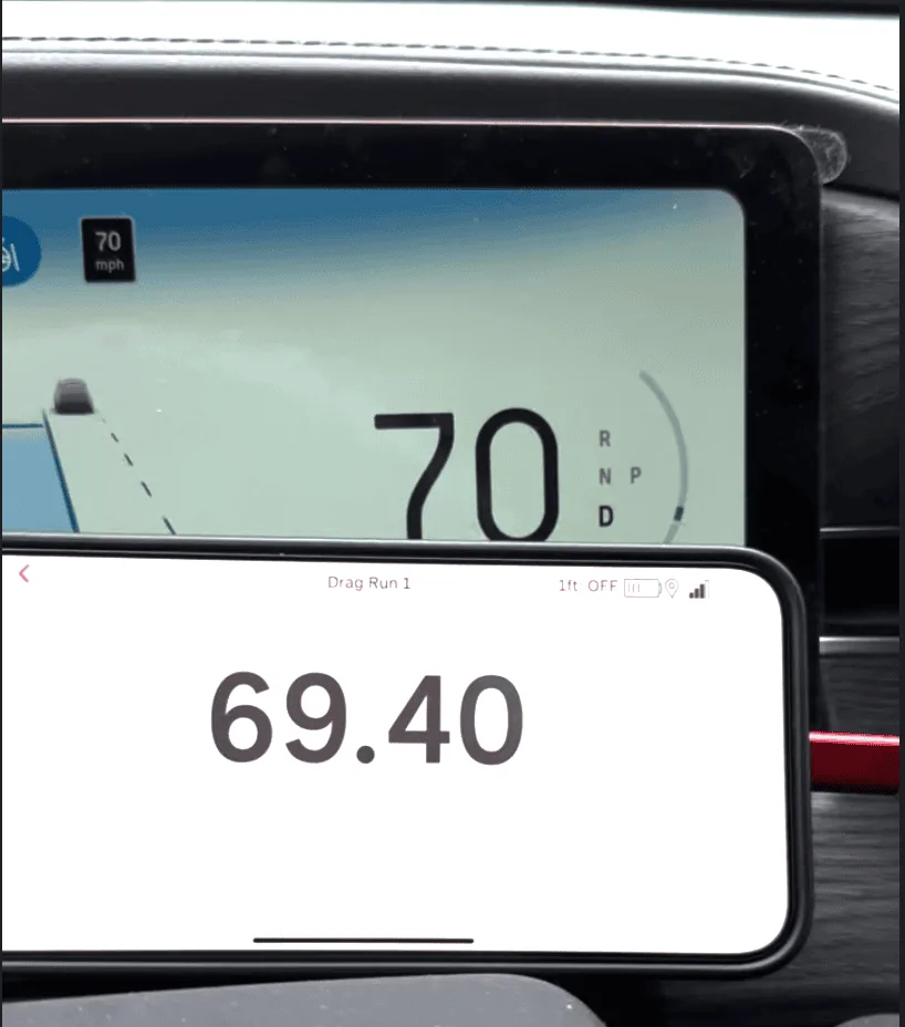

Hello all,

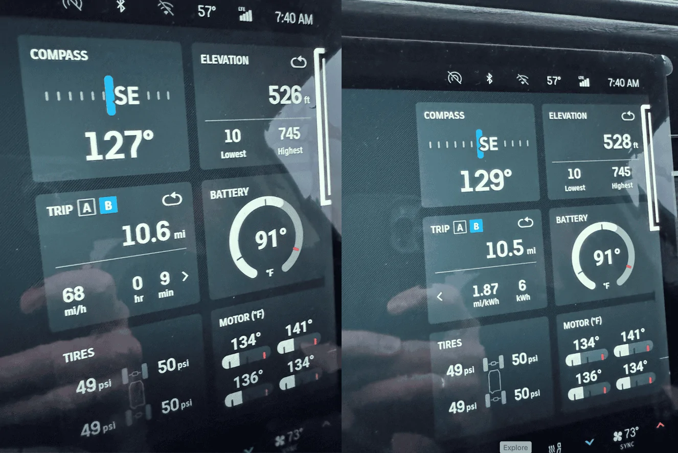

We conducted another test recently. This time we compared OEM 21" on Pirelli Scorpion Verde 275/55/21 vs our client’s AW10 22" with Michelin Defender LTX M/S2 275/50/22. It's worth mentioning that the Pirelli had a mileage of around 11,000 miles.

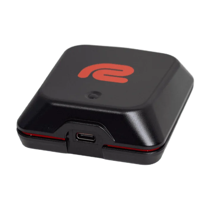

We used Racebox to adjust and calculate real efficiency for every set to make it as precise as
possible.
It helped us to see that the speed with AW10 22” on Michelin is 1.166% more than OEM 21” with Pirelli.
  • Vehicle: Rivian R1T 2023 Adventure
  • Distance: Each run was a consistent 10.5 miles at the same spot and direction.
  • Autopilot: Set and steady at 70 mph, hands-free all the way
  • Traffic and Control: No interference, didn’t touch the gas or brakes.
  • Cabin Temperature: Held a comfy 73°F throughout.
  • Tire Pressure: A steady 49-50 psi for both sets of tires.
  • Passengers: Two in the vehicle for each spin.
OEM 21” + OEM Pirelli Scorpion Verde 275/55/21
Atomic Wheels AW10 22x8.5 & Michelin Defender LTX M/S2 275/50/22
The weight of OEM 21” wheel 76 lbs.
The weight of AW10 22x8.5 with Michelin - 71.4 lbs
Real speed vs displayed on OEM 21”
Real speed vs displayed on AW10 22”
Here's the Scoop:
AspectOEM 21” & Pirelli Scorpion VerdeAtomic Wheels AW10 22x8.5 & Michelin Defender LTX M/S2
Tire Size275/55/21275/50/22
Wheel Weight76 lbs71.4 lbs
Distance Driven10.5 miles10.5 miles
Speed displayed70 mi/h70 mi/h
Temperature57°63°
Battery temperature91°78°
Real Speed (verified by Racebox)68.6 mi/h69.4 mi/h
Energy Efficiency displayed1.87 mi/kWh1.92 mi/kWh
Real efficiency1.8326 mi/kWh1.903 mi/kWh
Efficiency Improvement-+3.84%
Even the outside temperature was 6° different , we believe it didn’t affect the result noticeably. It’s good to know, that it’s possible to switch to a bigger rims and still don’t lose any range.
It would be interesting to compare wheels using the same tires, to calculate the impact of the weight only. More test will be coming in the future.

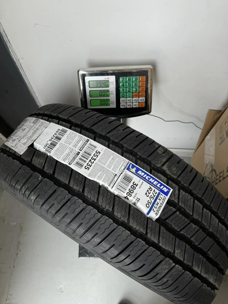

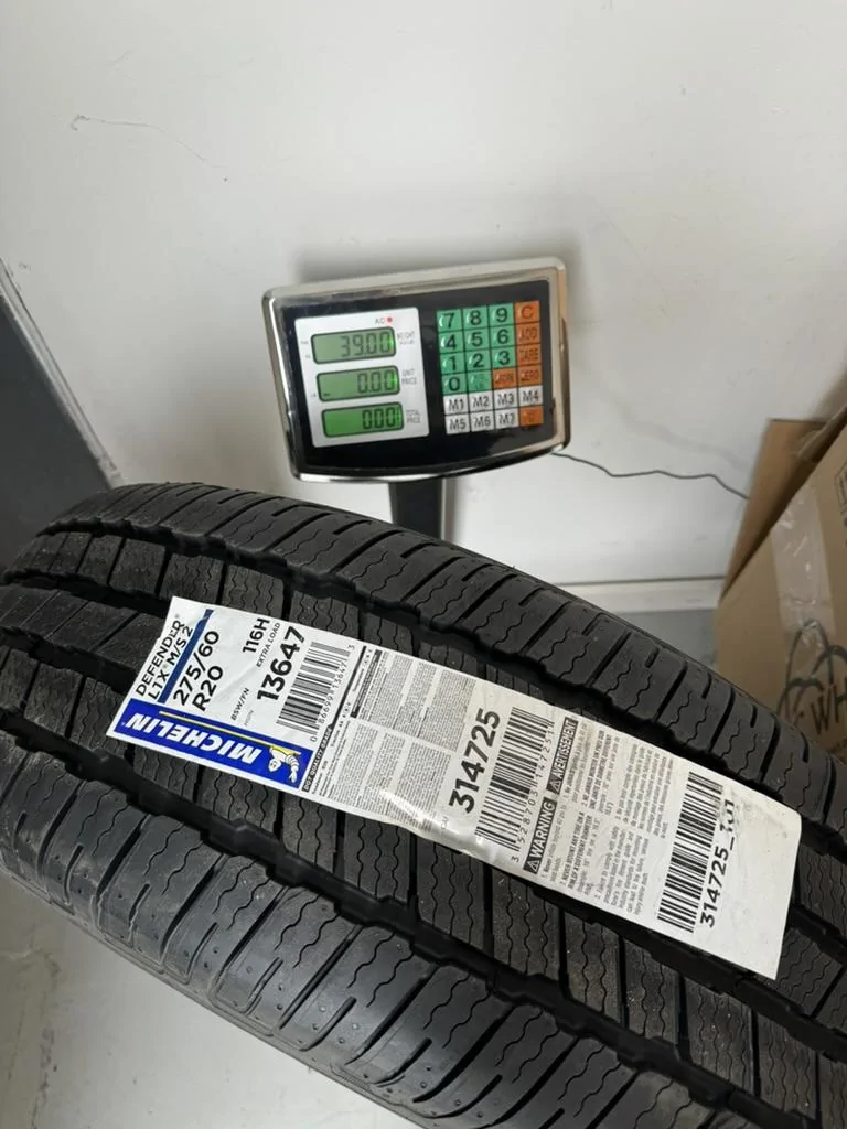

That’s great data, thank you for sharing!

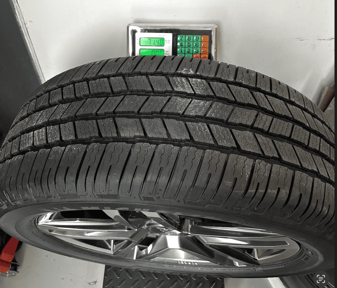

From what I can gather, the MS2 in 22” spec is an E-rated tire, and according to Tiresize.com, is pretty porky (52lbs). Your wheels look great and are very light, so that helps compensate for the extra tire weight if it’s the same spec.
So now I’m looking at your 20” wheels with the MS2 in in 275/60 (which is 14lbs lighter than the 275/50/22) ... these are not ideas I need in my head right now. :)
Atomic Wheels
Atomic Wheels
Oct 7, 2023
1,583
568
Dallas, TX
Rivian
Surprisingly, both the MS2 20" and 22" tires weigh almost the same.
But even [AW10] 20x9 inch rims and [AW10] 22x8.5 inch rims weigh roughly the same, and the tire weights for both are almost identical, choosing 20" wheels will save more energy. This is because having the weight closer to the wheel's center makes it easier for a vehicle to accelerate and decelerate the wheels. With 22" wheels, the larger tires distribute more weight further from the center, increasing the moment of inertia. This means a vehicle has to exert more effort to speed up and slow down those wheels, which can negatively impact the range. Therefore, despite the similar weights, 20-inch wheels are more battery-efficient due to how the weight is distributed.
Thanks! There appears to be an error on tiresize.com as they state the 22” tire is an LT and weighs way, way more. This makes a lot more sense.

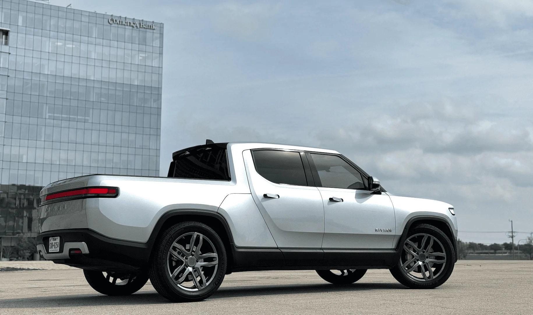

Hey everyone! Just wanted to share the real-world look at our popular [AW10] for Rivian R1T/R1S.
For a full 360-degree view, check out our video on YouTube thru this link:
These are 20x9.0" wheels in a sleek Transparent Black finish.
Don't forget, the free shipping offer wraps up in a week.

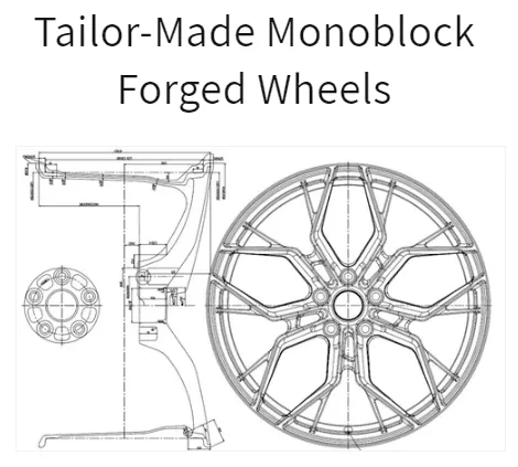

Hey there! We've got some news for you. Our custom forged wheel service helps create wheels that reflect your style and add a unique touch to your ride.
All you need to do is share an image or description of your desired design, and we'll bring it to life, whether it's a specific pattern, color scheme, or something unique.
Plus, we're offering significant discounts for custom orders:
  • 18" wheels: from $535 to $495 per wheel, saving $160 per set.
  • 19" wheels: from $570 to $525 per wheel, saving $180 per set.
  • 20" wheels: from $645 to $555 per wheel, saving $360 per set.
  • 21" wheels: from $705 to $595 per wheel, saving $440 per set.
  • 22" wheels: from $795 to $655 per wheel, saving $560 per set.
If this sounds like what you're looking for, check out website or send us an email at [email protected] and let's get started on designing wheels that reflect your style.
Take advantage of these discounts, as they will only last until May 31.
