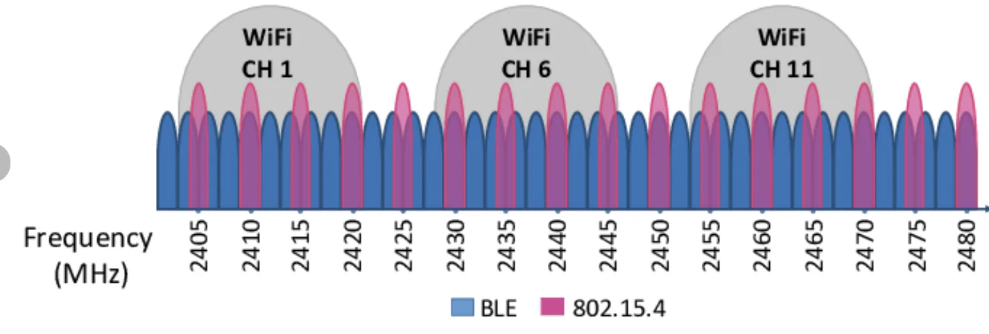

WiFi and Bluetooth share the same unlicensed frequency band (ISM) as well as other random devices. It could be a high power WIFI signal in the area that is overloading the Bluetooth receiver causing the drop outs. Think of it like staring into the sun. Bluetooth will try to hop around to find a quieter frequency but that can't stop extreme interference.

I'm not going to engage in any arguments about this. There are a multitude of scientifically controlled experiments that well document these issues. The design of the receiver front end is a major factor in how interference manifests itself. Here's just one controlled study. There are many. You can choose to believe it is nearly impossible it but it does not change the facts that it happens.
"This report extensively examines the coexistence of three wireless technologies, Wi-Fi, ZigBee, and BLE, operating within the 2.4 GHz ISM band. The study thoroughly investigates all potential interactions, encompassing variables such as transmission power, distances, data rates, and the utilization 25 of co-channel or adjacent channels. In summary, the evaluation of performance metrics (specifically throughput and PER) for each of these technologies indicates that the operation of both ZigBee and BLE is noticeably compromised when coexisting with Wi-Fi within the same frequency spectrum. ZigBee registered a high throughput drop of 65.5% and PER between 4.3 and 27.1%, while BLE showed a throughput drop of 41.29% and PER between 2 and 9% in the presence of Wi-Fi. Though effective in an interference-free environment, the FHSS or AFH technique BLE uses is inefficient when multiple Wi-Fi channels coexist. As seen in our experiment, the performance of BLE was not impaired by ZigBee unless external interference from Wi-Fi existed, which is typical in home, office, or industrial spaces. Furthermore, when these transceivers operate on short distances, within 2 to 10 feet, there is a slight variation in performance. In addition, the presence of ZigBee and BLE has a negligible impact on the performance of Wi-Fi. Our intended future work will be to expand on the obtained results and conduct more test scenarios under different environments and provide a solution for the coexistence of all three technologies in the same vicinity."
