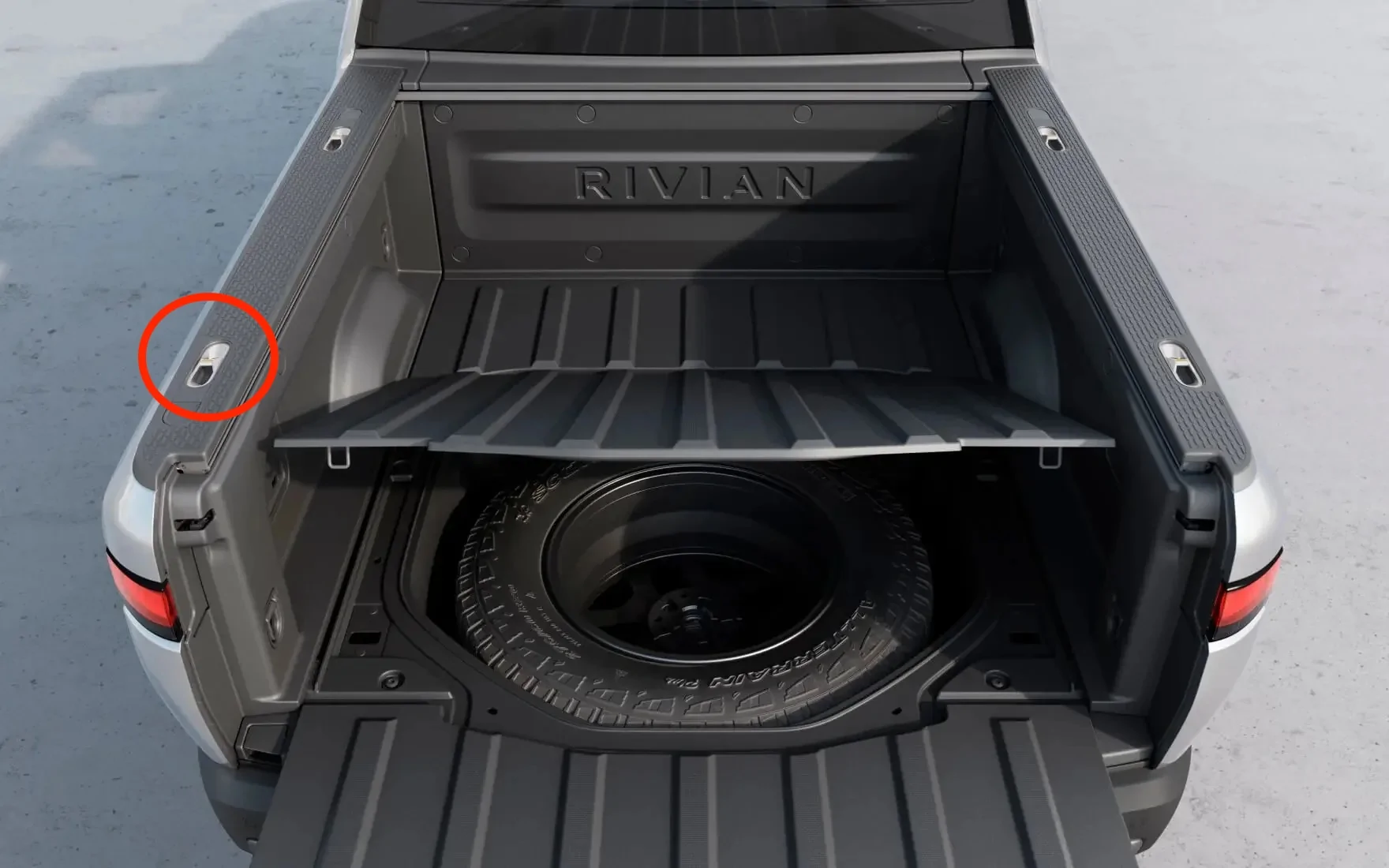

I've been looking into a mobile GMRS setup, and finding a decent place to mount an antenna is tough, especially with the all-glass roof.
This got me wondering, are there accessory mounts that can be locked into the cargo crossbar holes on the bed/roof (dunno what they're called, eyelets?)?
Rivian R1T R1S Cargo crossbar mount? bed
This could make for a secure antenna mount that could also hold a ground plane or counterpoise or whatever, and would be relocatable to the roof mount location in a pinch if I ever need to use the cargo crossbars on the bed.
Has anyone done this, or is there a product that clips into these mounts and lets you attach accessories?

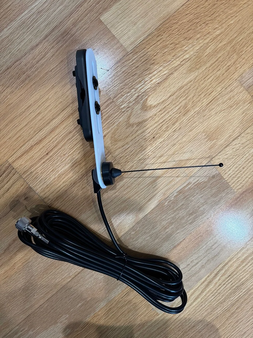

And the accessory port adapters, $100 would be reasonable for a set of 4.
Yep, I couldn't do $100 for a single mount.The ultimate cheap method could be a small u-bolt with nut fasteners over a drilled plate. I split the difference with the Megawatt adapters, which are solid steel and $80 for 2...
Right now prototyping what I'm going to try to do with them:
