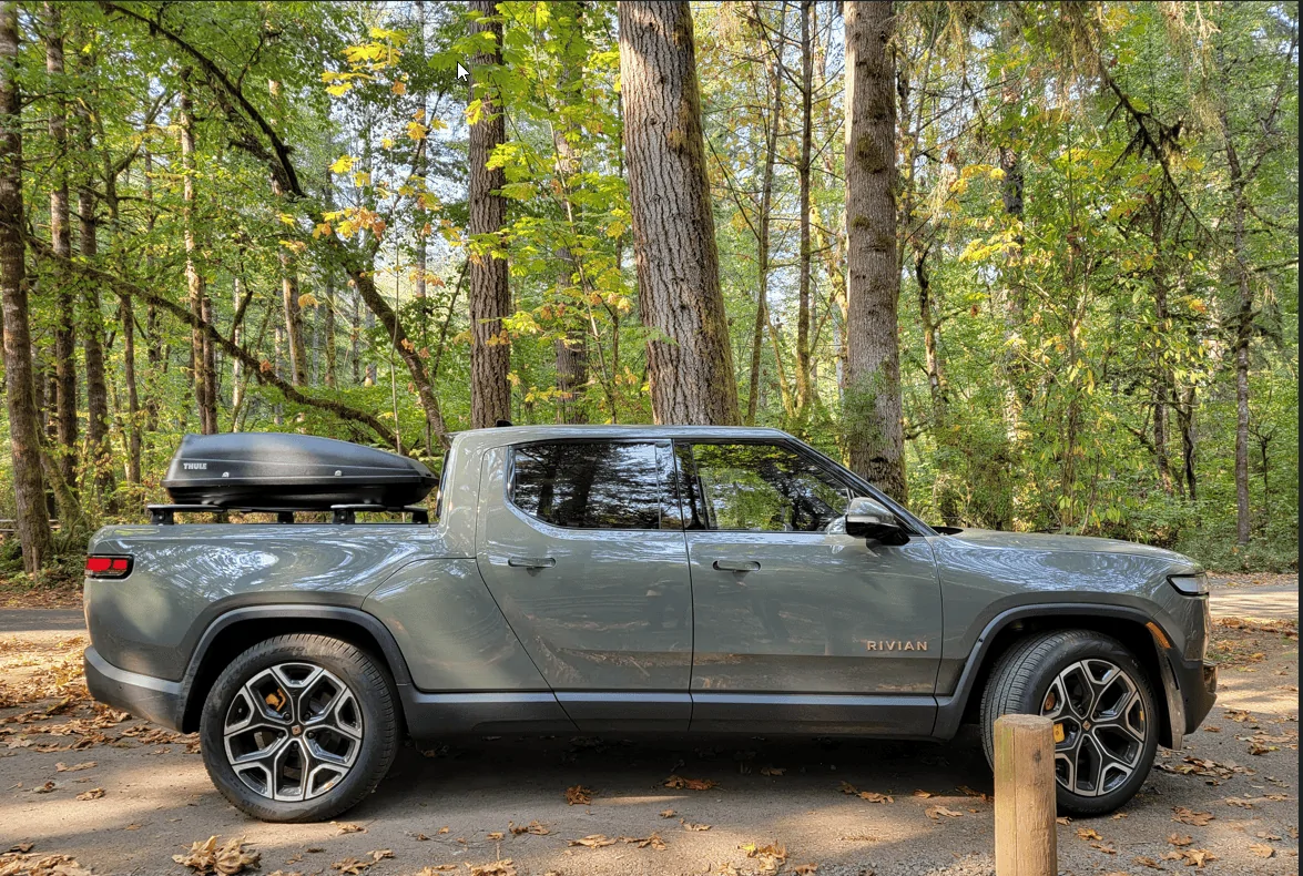

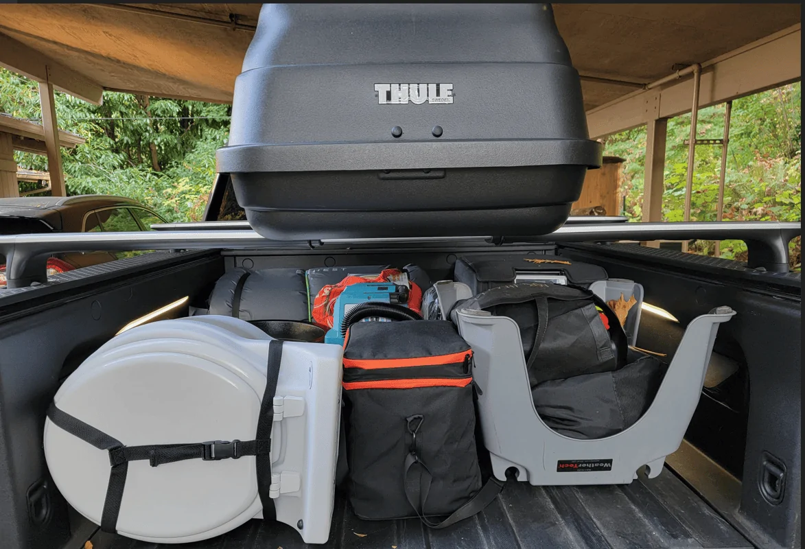

Yep...got the Sidekick Model number 682100 to have a little more space for our glamping:
Rivian R1T R1S Are Thule accessories compatible with the Rivian crossbars? 1671128884518
Fits perfectly over the bed.
Rivian R1T R1S Are Thule accessories compatible with the Rivian crossbars? 1671128968259
Good idea! I may want to do this, esp. with the tonneau issues (I have my switch turned off, it’s gotten stuck a couple times).
