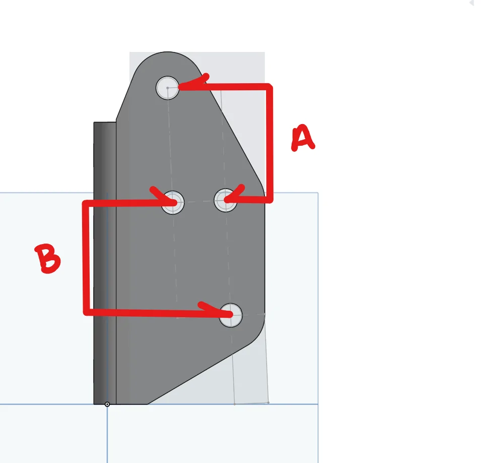

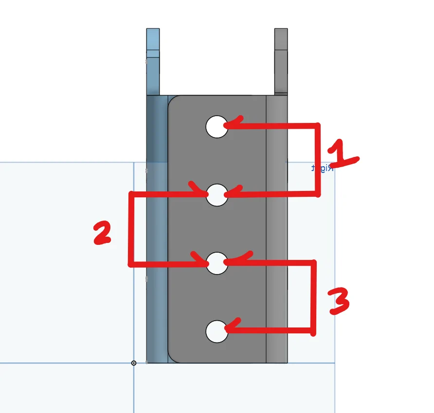

More info on the brackets, the above post was long enough already.
The adapter bracket has a bit more available adjustment than the original Kammok. The side holes and the face holes on the Kammok are in a way that you can adjust up and down 20mm between each combo. The adapters can do ~15mm between combos. The diagrams and table below show all the height available, my pictured setup is at A2 "Default"

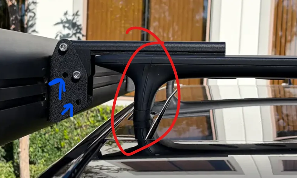

For crossbar whistling I've had them on 3 different sets of crossbars, goto fix for each that worked for me was electric tape on leading edge of risers can be seen circled in red below.

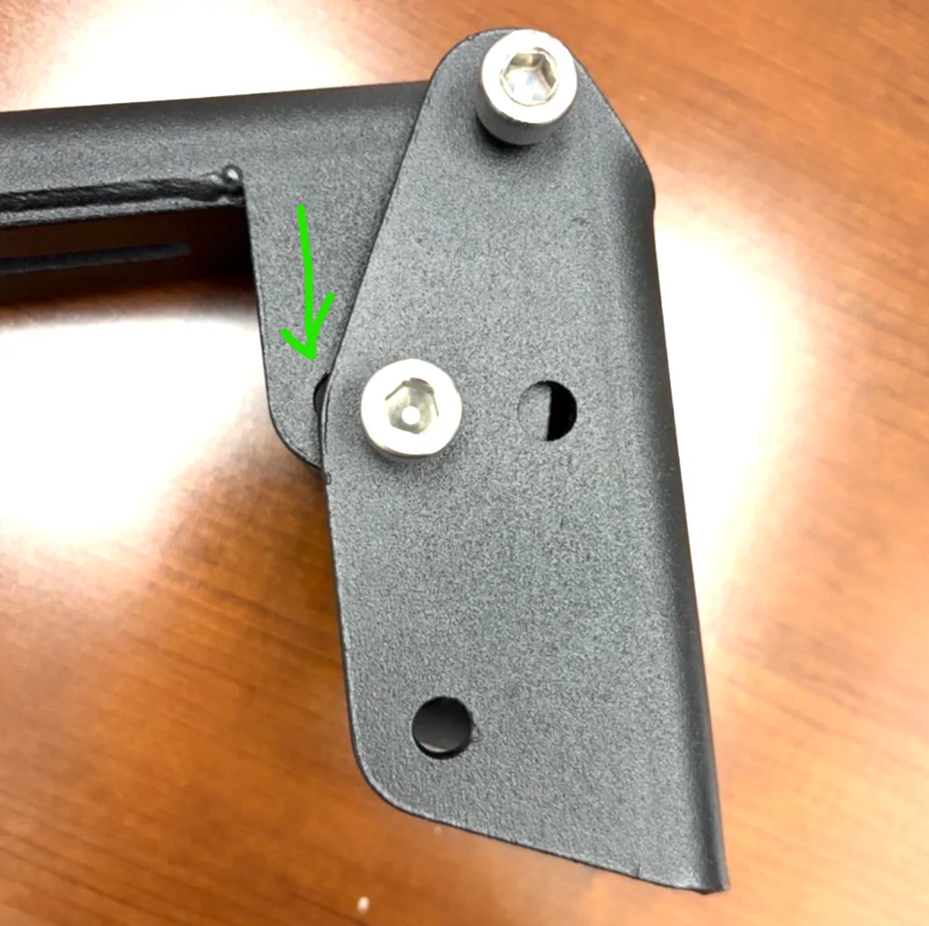

For awning whistling, I had a whistling i heard when no music is playing, low volume somewhat deeper tone whistle at 33mph +/- 1mph consistent last week, havent been able to replicate this week. I am thinking its the holes pointed in blue. The top hole has a 2/3 overlap with the other bracket and may be a cause for whistling. I have since covered it with electric tape and no whistling so far. Going to take the tape off and see if i can get it to come back. The overlap is present regardless of adapter bracket or Kammok bracket.
Rivian R1T R1S Rivian x Kammok + Side Mount Kit Solution. 1768932675658-60
Rivian R1T R1S Rivian x Kammok + Side Mount Kit Solution. 1768932871747-6
Pictured above is the kammok bracket I have with me. I also just noticed when I CAD'd the new brackets I made the sides longer, as an unexpected result, it does cover the slightly exposed hole pointed in green. The new brackets were not a copy and paste with adjustment. I CAD'd it from scratch with measurements i took for holes and clearances so differences like this was expected. in this case i believe it's a positive if the cause of whistling is these small gaps.

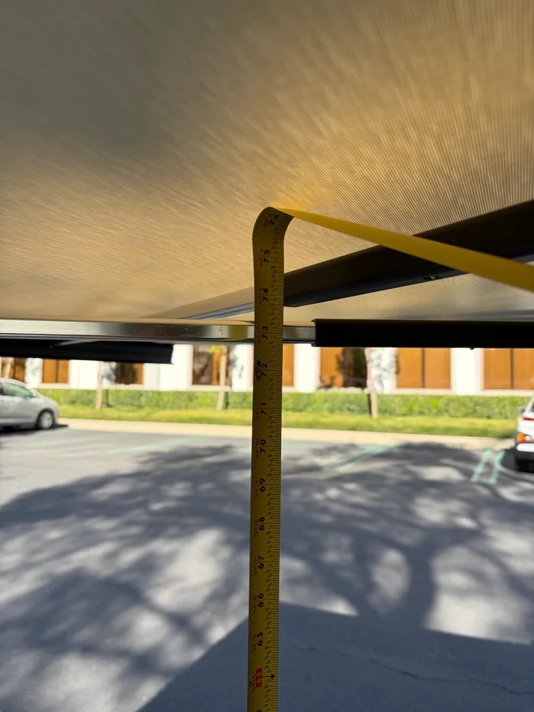

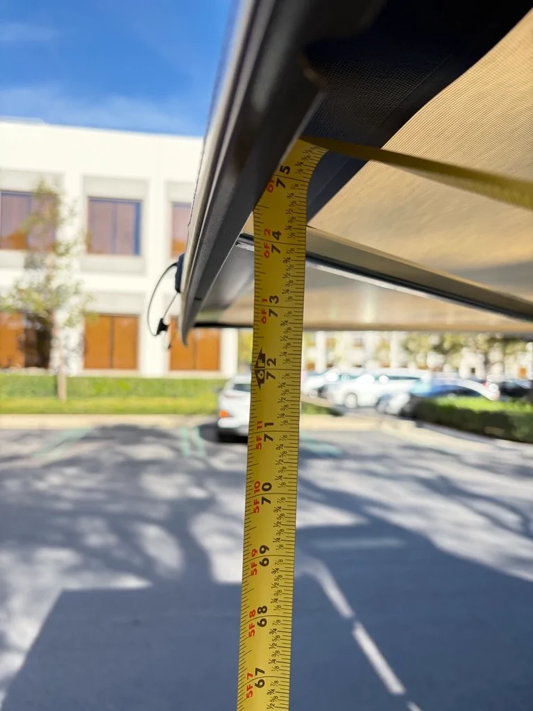

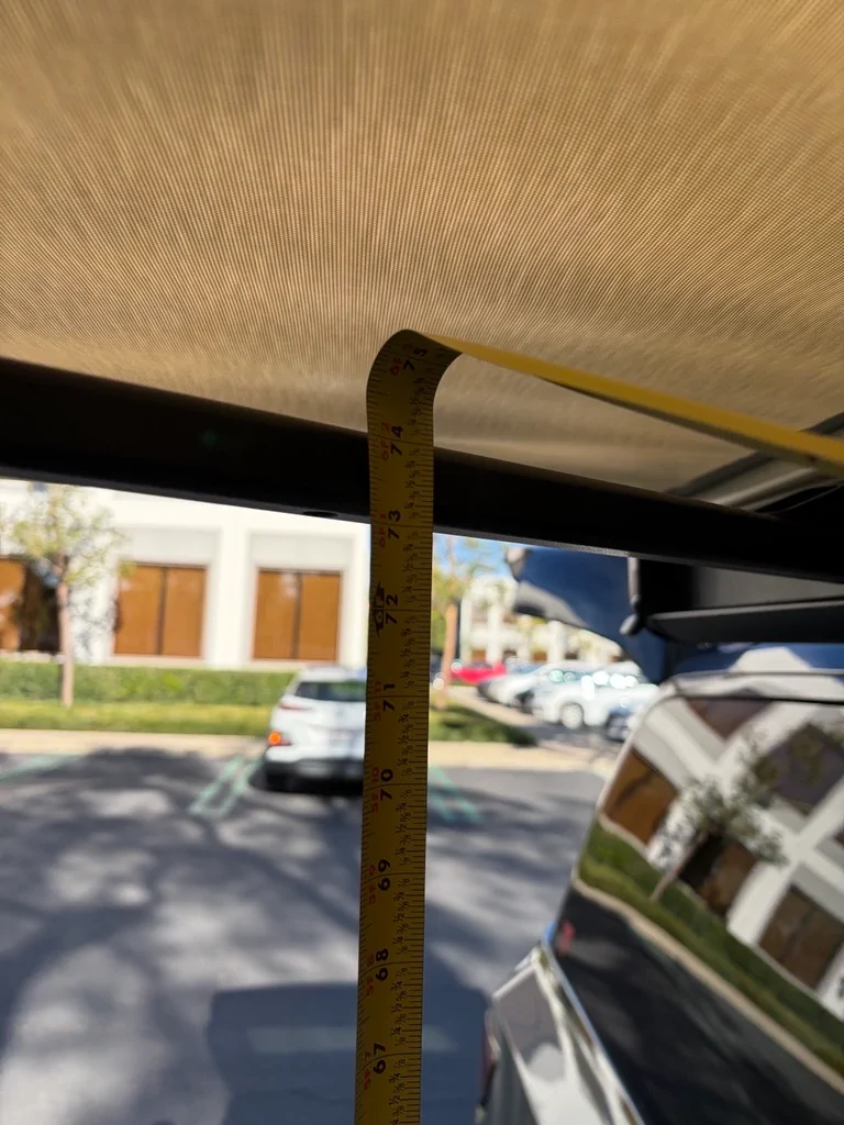

See table for clearances
Rivian R1T R1S Rivian x Kammok + Side Mount Kit Solution. 1768945380238-1
Here are some heights under the canopy lowest point and canopy itself at highest ride height.
