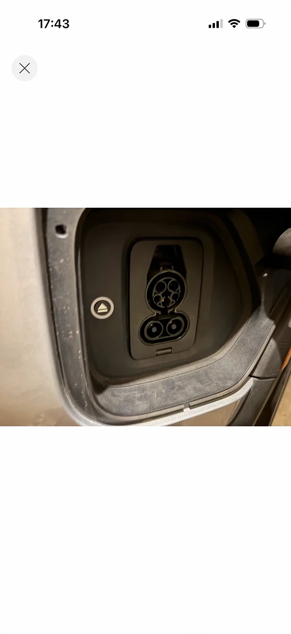

2025 R1s here. With the recent head lamp recalls, does anyone know if the ccs port area is removed to make these recall repairs?
i can’t prove that it wasn’t gone before going to the SC, but now my ccs port is missing that rectangular cover. I wondered if it could have been snapped off during those repairs.

Looks like it got pinned behind the fascia/port valence when they removed it.

The outer cover just pops out, if it is hiding in there it should be easy to find it.

Thank you so much for pointing out the fascia can be popped off easily. Indeed I can see the cover in there.

Were you then able to pull it out to the front? Or is there not enough space to fit it through?
