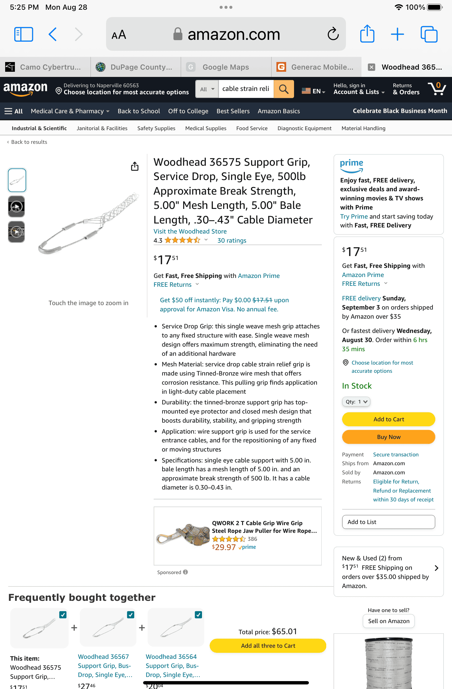

Actually the ceiling mounted unit looks great. I would add a strain relief to the cable where the weight of the hanger no cable stress’s the conductors. Something like the attached ( Chinese finger style)
Thanks. The coil at the top from the original pics is still in place so that solves the main strain concern and the last ceiling hanger is actually pulling at about a 60 degree angle due to the cord strap attached to it and offset mount rather than trying to let it drop at a 90 degree, so that helps a little too. The weight of the cable and connector is less than would think so no real concern with the vertical weight when hanging or connected to vehicle. Any strain relieve efforts are good though.
