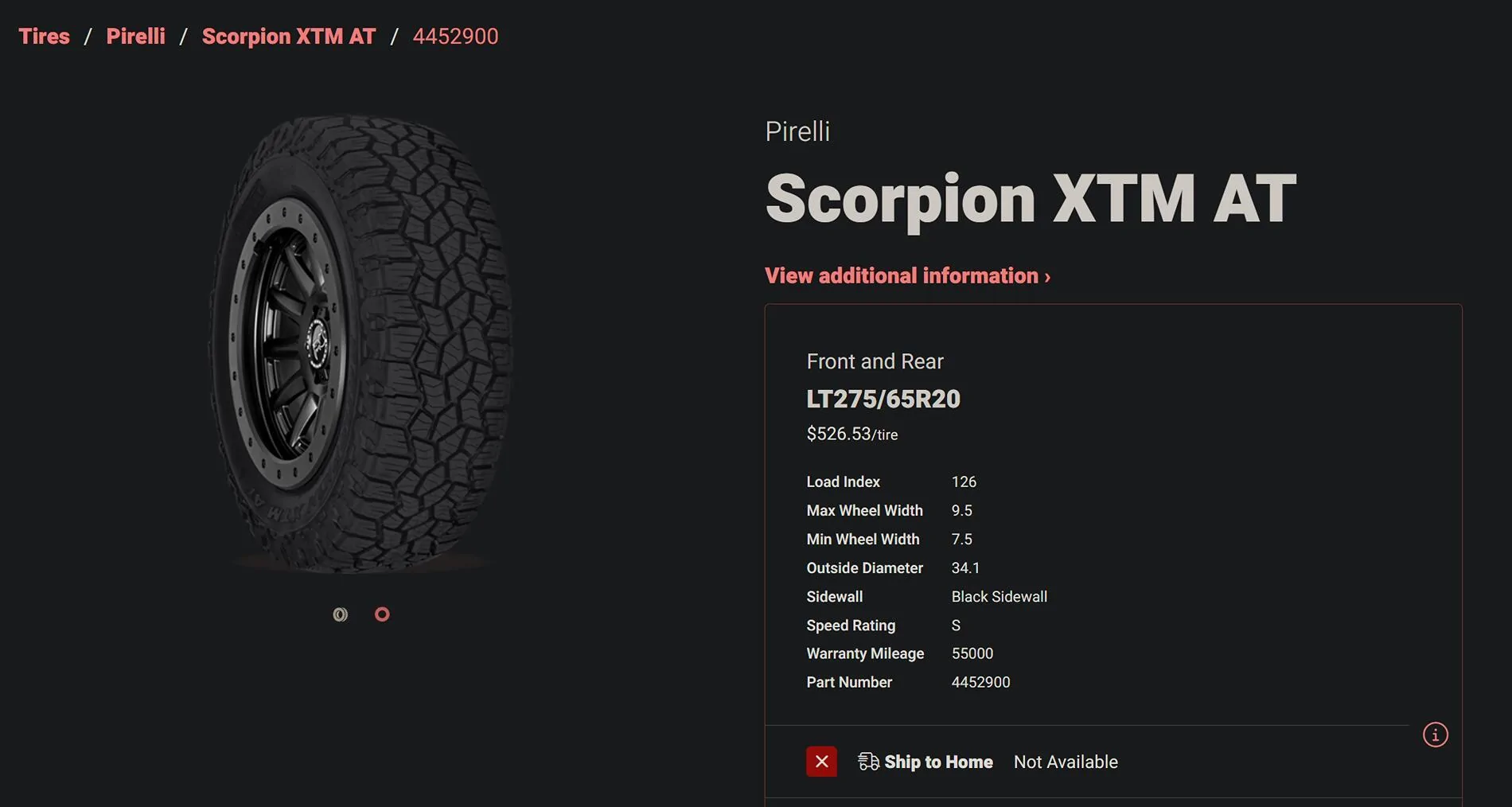

I also noticed a discrepancy. Discount tire site says max psi of 36 but the print on the tire shows 44

wow . Max PSi at 36? and this is supposed to be the replacement of the OEM 20"?
May not be true. Thought I read somewhere last month that the intent of Pirelli making these was to replace the AT plus. I’ve reread everything I can find on the XTMs over the last 24hrs and can’t find that mentioned anywhere.

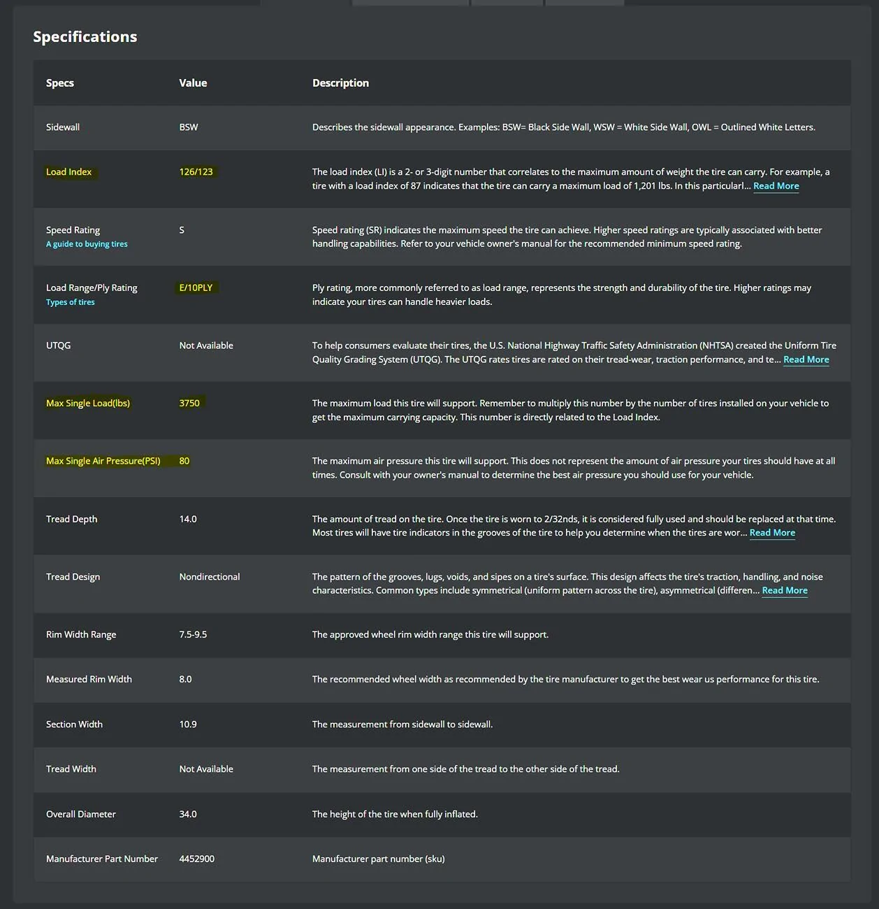

It isn’t. People jumped to conclusions without seeing specs. Pirelli’s own product page has specs missing. LT version would have been better choice, regarding psi, since most LTs are 80 max. But Pirelli has not disclosed that detail or tire weight. This is similar to how the Nitto Recon Grappler got hyped until others dug deeper into specs. That long thread still exists with misleading title. Newcomers wouldn’t know it’s not an ideal tire unless they read a few pages.

I think the right answer is if someone wants to use the Pirelli XTM AT tire they need to wait for the LT version so it can hold higher tire pressure Rivian has on the door jamb. Keep in mind the lower speed rating.

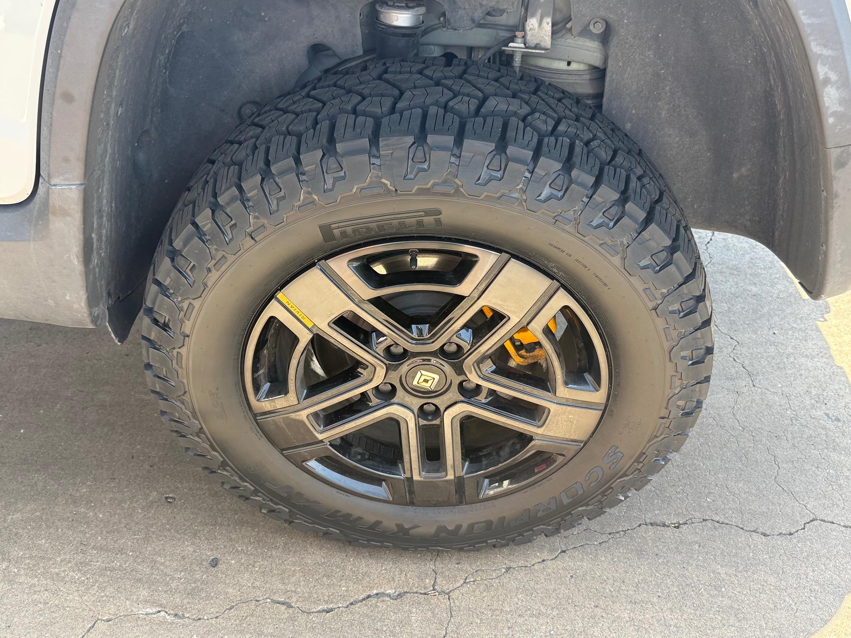

I went ahead and lowered mine down on my SL Pirelli XTM AT for now and plan to change to tires that can hold 51 - 60 psi.
Pirelli XTM AT LT 275 65 20
