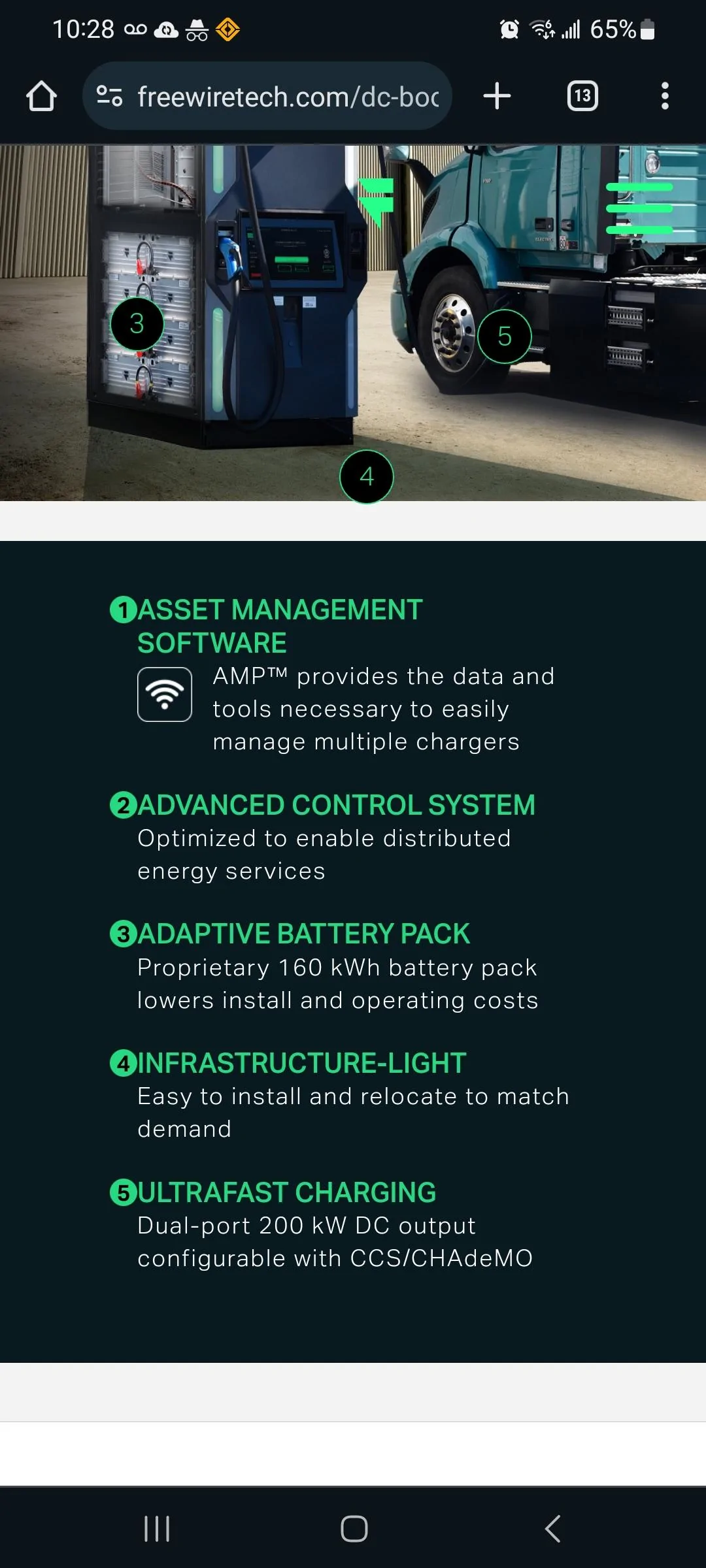

I was told by the technician's that they had a 200kwh pack but either way its a less than ideal design. I guess it is easier on the grid. I have had less issues in the mornings.
I might send them a message to sort out this issue of slower Rivian charging.
Currently its this free 80kw/h charging is working out ok for my out of town trips but 120kw/r would be much better.
We were close... 160kWh battery pack
