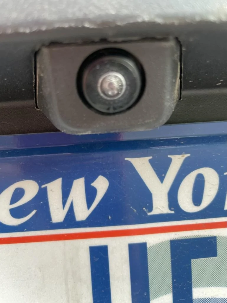

How did this work out for everyone? I have a blurry backup camera that I believe has water inside the len. Photo attached. I'm waiting for a late September SC appointment (very frustrating).
They should replace it, no issue.

I’m the original poster. I’ve had 2 cameras replaced now for water in the lens. It took longer than expected for both because water traveled up and rusted the wiring harness.
I asked them if there was a lack of sealant somewhere and they said no just bad batches of cameras.

Thanks for the update!
I am trying to accelerate my service center visit. Ugh!
