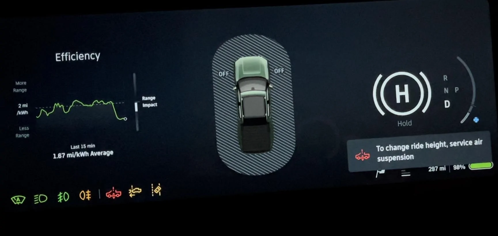

How’s everyone’s R1 this cold December day? Just took mine out for a drive and it wasn’t happy. Proximity sensors offline, air suspension offline, no cruise control. Otherwise did fine and will probably be fine after it sleeps or I’ll do a reset. But no issues when I parked in driveway yesterday night…. Charged it up to 100% last night in case we had any power issues today. I usually charge to 70%. Will check it out after it sleeps and try reset afterwards if issue still persists. Oh and I’m on 47.0.

A mobile tech who came out and worked on my truck suggested that when the truck is coming out of sleep, occasionally you'll get a lot of those faults if you put your foot on the brake or into drive too quickly while the computers are waking up. I'm sure it's exacerbated by colder temps as well.

@kurtlikevonnegut thanks for the info. I’ve seen a few one off errors before. Pretty sure it will correct itself. @boardthatpowder I was referring to our temp drop today. It was still plugged in all day so not sure of drain. I’ll see how mine holds up tonight. About to go check it again and reset if needed. I’ll get a screenshot of levels to see what I lose overnight in the cold. I hope you have something left when you get back.

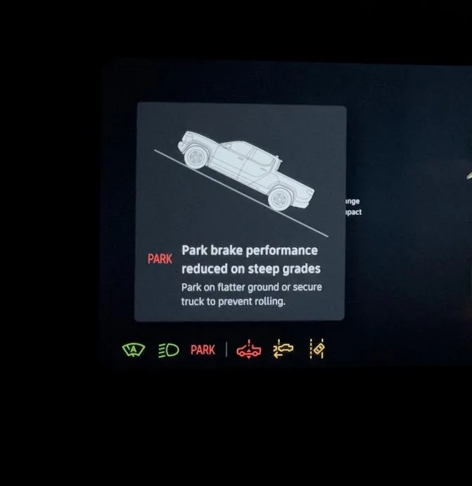

Well after sleep, soft, and hard reset, no change. Guess I’ll call service tomorrow. Something is up. No proximity warnings, no cross traffic alerts, no air suspension (stuck at lowest stiff), no cruise, auto high beams not working, and it cautions me that my driveway is now too steep for the parking brake.

Well the truck is back to normal. I called service yesterday and while I was waiting for them to review diagnostics and call back, I tried the air compressor in the bed just to see if it worked. It turned on fine. Got back in the truck and air suspension decided to work. Support called me back and asked if I could put the truck in my garage to warm up. I said no and told them about the suspension working again. They confirmed they had done nothing other than look at diagnostics report and asked that I go test drive. About a minute into my test drive the errors for no proximity sensors cleared and all is back to normal. She said some trucks have exhibited issues in the cold which is why she asked if I could park in the garage to warm the truck up. That’s a little concerning if it’s true.

I had exact same symptoms yesterday in 5F temps. Mine corrected itself while running errands and now is working fine. We will see if it is a lingering problem or cold anomaly. I’m also curious if this has anything to do with recent software update.
