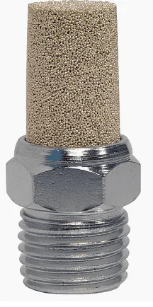

Industrial pneumatic systems have a muffler on the exhaust port(s). That sounds EXACTLY like an industrial pneumatic system with no muffler.
