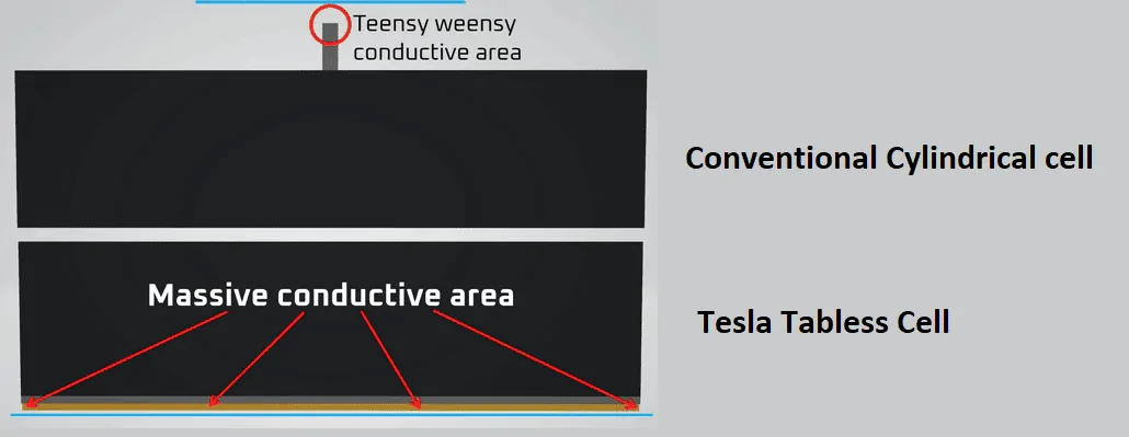

Look at the "tabless cell" design, lots of good video's on YT. It's being called "revolutionary" (and not just in the usual YT clickbate titles) for a good reason.
It seems simple enough in theory, but actually manufacturing it has been quite problematic. When you have current going in and out of the full cathode width vs a 3mm wide "tab" that makes a enormous difference in how much current you can quickly pull from or push into that cell.

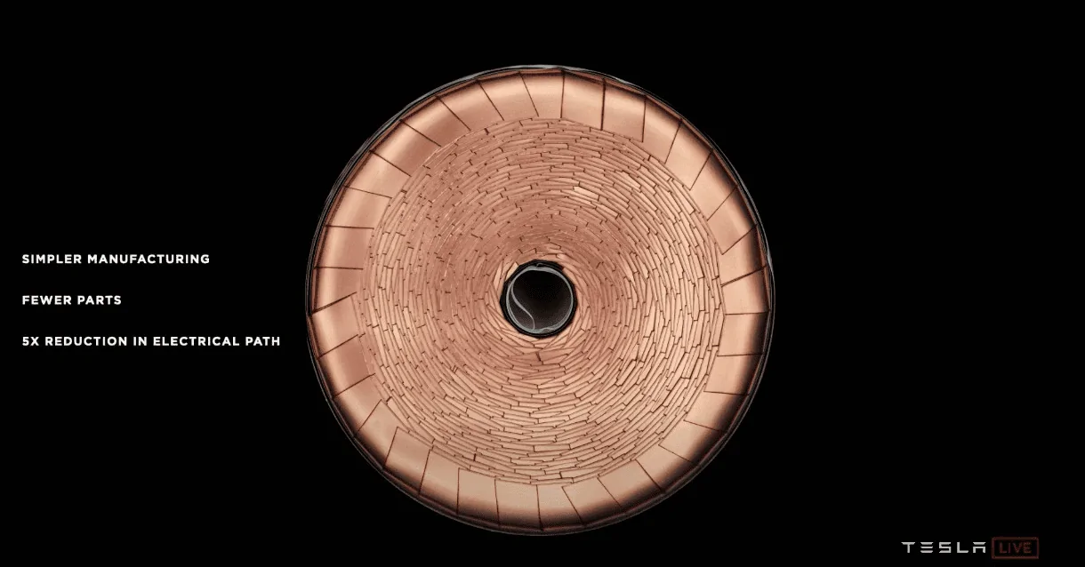

Tesla Tabless cell below..
Rivian R1T R1S Cybertruck photo leaked! ? 1649349009076

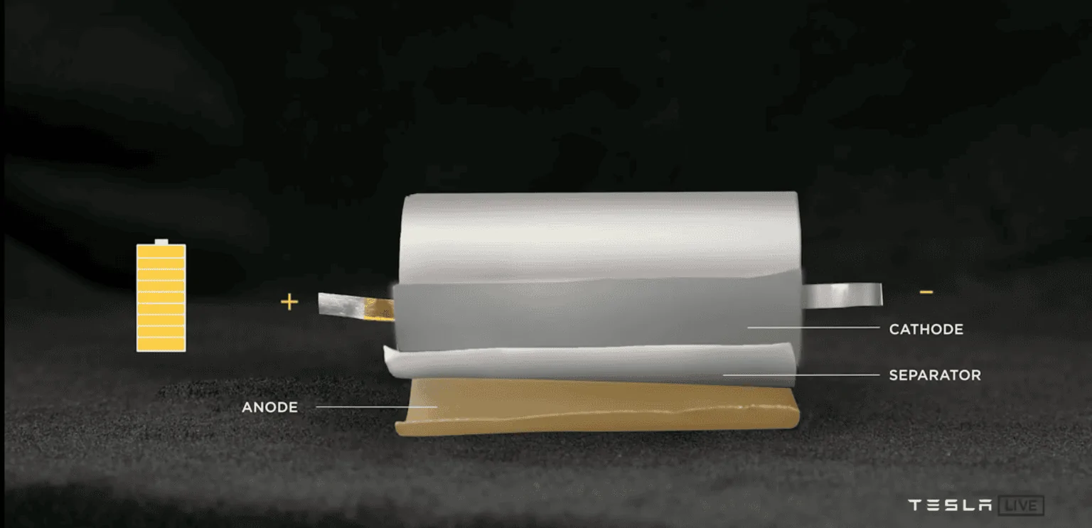

Conventional Tab cell below..
Rivian R1T R1S Cybertruck photo leaked! ? 1649349064340
I haven't seen any published information if Tesla is still using the fuse wire to each individual cell for the new batteries. You're still pushing all that current through a "Teensy weensy conductive area" if they are.
That fuse can be made much larger/higher value now as it's set a a low value to protect from melting the tiny tab and overheating the conventional cell. Tabless design solves both of those issues.
You're still beholden to the chemical limitations of the cell. I don't think it's as big of a gamechanger as you say it is.
Which far exceed the limitations of the old "tab" cathode design. It's not myth but fact that tab connector heating is a limiting factor of current cylindrical Li-ion cells. People are always complaining/wanting faster charging or "the same time it takes to fill up my gas vehicle", well the tabless cell might be the first commercially viable Lithium chemistry cell to get very close to that. Right now the cathode tab is a huge limiting factor, Tesla got rid of that, now on to even better chemistry maybe?
