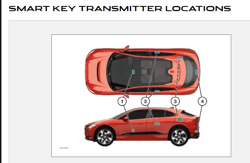

It has no way of knowing which phone is in the driver seat if multiple phones are in the car.
It feels like it gets it wrong nearly 100% of the time , but that's probably just because you only notice it when it guesses wrong.
It is probably whichever phone/key it sees first.

My seat and mirror settings are linked to my profile, and adjust for whoever unlocked the car. You can always switch profiles from the screen if the Rivian picks the wrong one. This is how it was designed to work, and this is how it does work for me. We don't use our phones as keys.
Using a phone as a key adds a complication because a phone can unlock the Rivian from a variable distance, depending on type of phone, orientation of phone, direction of approach, etc. So even if you're the only person getting into the car while your wife is still in the house, it could be her phone unlocking the vehicle. Likewise when you're both walking up to the car.
If this doesn't work for you contact Customer Support and they can talk you through a reset. I would try disabling the Paak feature first to see if that's the real problem.
