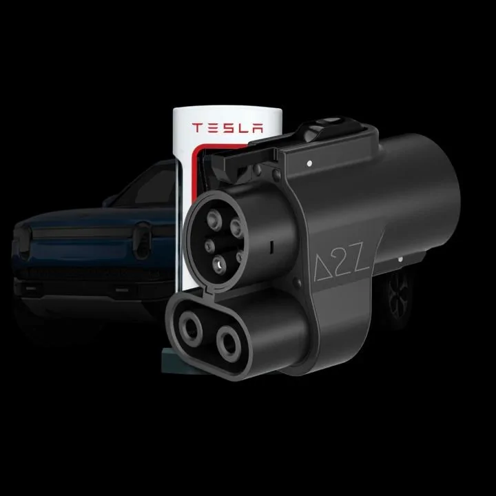

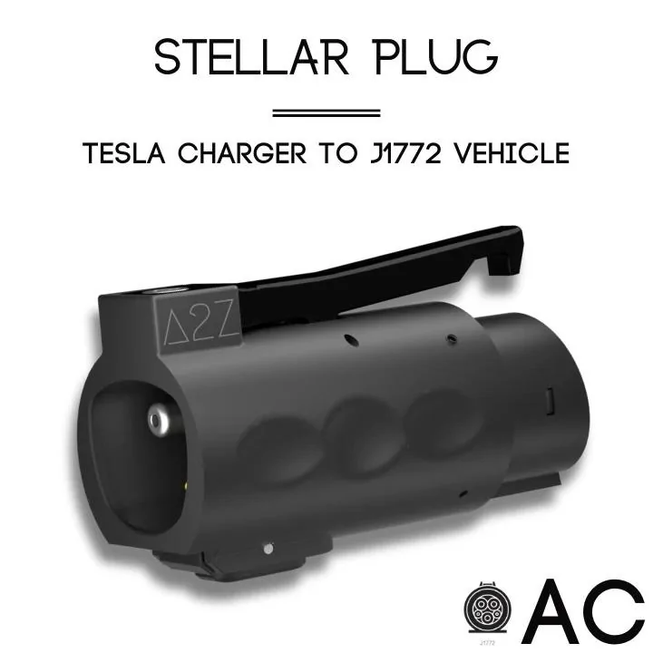

I'm about to purchase the Typhoon A2Z adaptor and the web site has a bundle offer for an AC adaptor as well. Is this AC adaptor what I would need to use at a hotel or friend's level 2 garage that only has Tesla (NACS) charger? Thanks!
Yes you can tell if an adapter is for DC fast charging (supercharger) because it has the 2 large pins at the bottom that make it CCS (you have to open the rectangular flap on your Rivian).
Rivian R1T R1S DELETED ccs
The J1772 adapter does not have the 2 large pins under the round connector and is used for AC charging (the charger built into your Rivian). You use this adapter on Tesla destination, home and mobile chargers.
Rivian R1T R1S DELETED j1772
AC on Left DC on right
Rivian R1T R1S DELETED chargers
Yes.
NACS to CCS is what you'd use at a supercharger. NACS to J1772 is what you'd use at any level 2 charger with a Tesla/NACS plug.

I don't have a "RIVIAN APPROVED NACS ADAPTER" to let you use but it sounds like an awesome trip, please post a trip report with pics!
(and I would recommend A2Z's, hundreds of people are using them, thousands and thousands of successful charges at this point with no reported issues, I'd go for that)

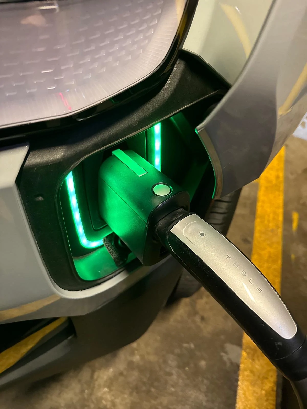

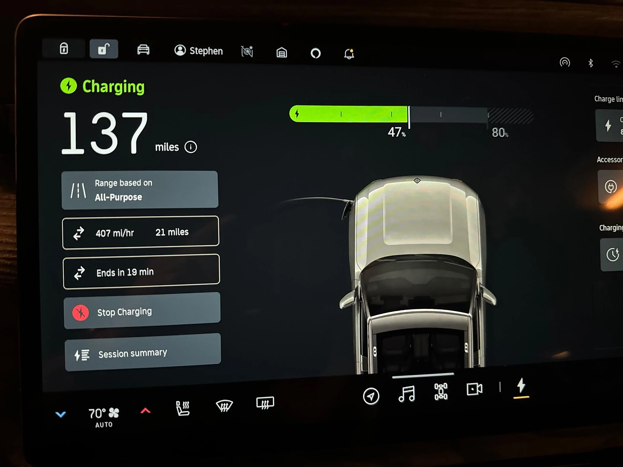

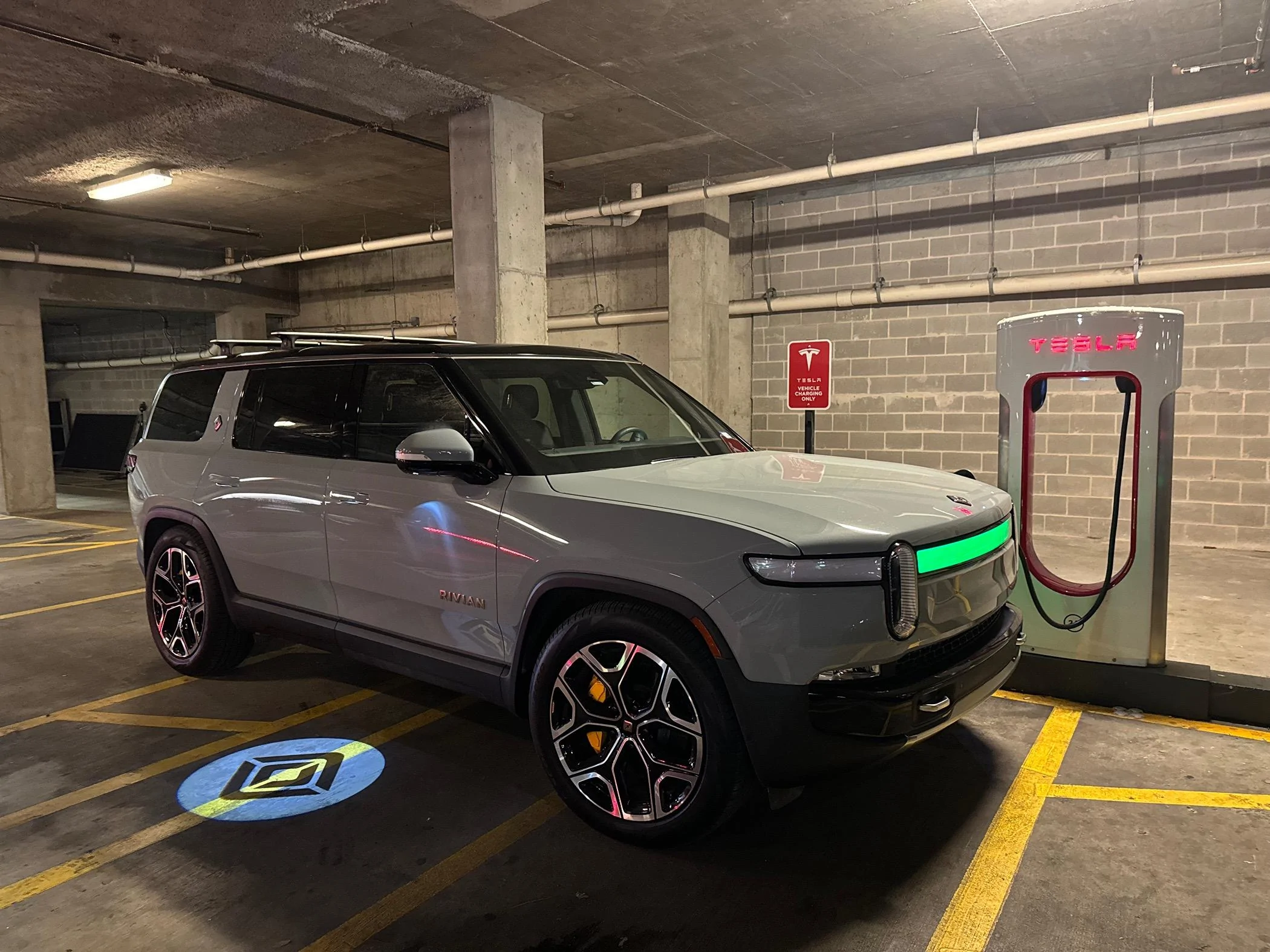

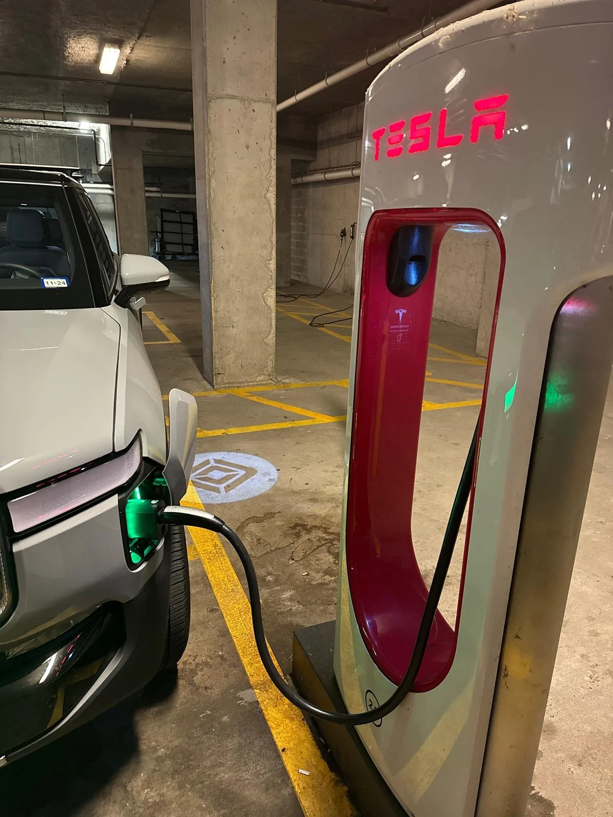

I got my first loaner RIVIAN-APPROVED NACS Tesla Adapter today and tested it out. It worked flawlessly. It attaches quickly and securely to the Tesla charger. It was pug-n-play with billing automatically with my Rivian account. I plan to test the Tesla membership on my trips, so I'm unsure how that changes the connection process. Parking is a challenge. You need room on either the side of the far left or the far right charge stations to avoid taking two Tesla spots. Pulling a trailer will add another level of complexity. Thanks again to a couple of generous forum members for loaning me their chargers! ??

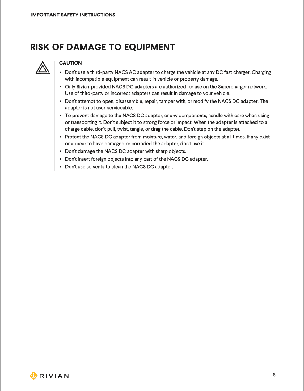

Thanks so much, you are free to do whatever you want with your Rivian...but with two brand-new vehicles I am choosing to follow the recommendation included with the Rivian adapter:
The connection process is really easy with the Tesla membership and app. You can set your Rivian vehicle in the app and it will filter out the Tesla only stations. Roll up to the compatible station, open the app and select the location. Then select "Charge Here" and choose the post number that you are at. Then it will instruct you to connect the adapter and plug in. It does the handshake with the vehicle and starts charging.
