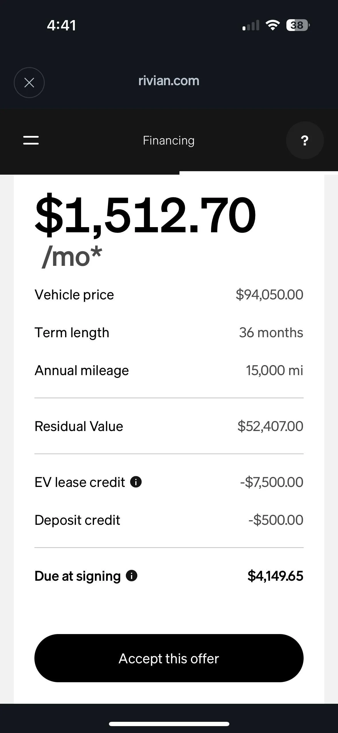

I received these numbers when I applied for a lease from Rivian/Chase. The monthly payment seems crazy high. How can I determine what the money factor is? (My sales tax rate is 7.75% in CA)

I played around with the following site and when I used a factor of .00340 I got your payment to within $2. That yields an APR of about 8.16% (see below). Here's the link to the calculator site so you can plug things in yourself to double check things. Hope this helps.

Monthly Depreciation
$934.53​
Monthly Interest
$470.75​
Monthly Tax
$108.91​
Money Factor Equivalent APR
8.16%​
Down Payment
$8,000.00​
Upfront Tax
$620.00​
Total 36 Lease Payments
$54,510.87​
Total Cost to Own After Lease Ends
$119,599.41​
If purchased under the same conditions
Monthly Payment
$2,702.85​
Sale Tax
$7,288.88​
Upfront Payment
$15,288.88​
Total Loan Amount
$86,050.00​
Total of 36 Loan Payments
$97,302.61​
Total Loan Interest
$11,252.61​
Total Cost to Own
$112,591.48​

I had used an online calculator on it the other day but wasn't sure if I did it right. Thanks for running this.
