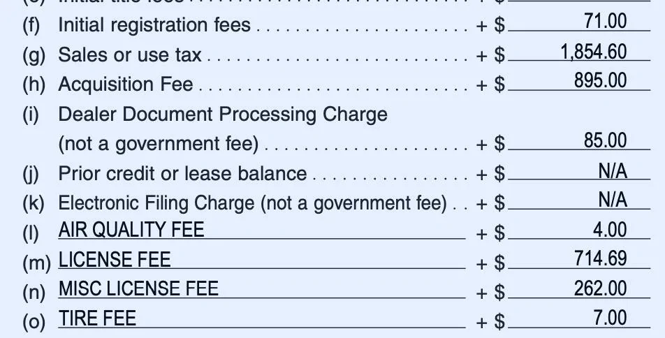

Since there is a lot of false information in this thread, will provide real numbers for a R1S purchased in March 2024 that was bought out in July 2024 with the $7500 EV credit applied. Will simplify using only real money from my bank account and subtract out any fees that exists no matter what (registration, etc.)
MSRP / Purchase Price: $109,950
Cash at delivery: $18,354 (includes the following fees and taxes). Subtracting all except the acquisition fee because the rest of the taxes and fees would be paid on a purchase. This will make it apples to apples comparison) = $15357
4 months of lease payments: $3844 ($961 x 4)
Cash to buy out lease: $85,652
Total apples to apples cost vs. buying: $104,853 on a purchase price of $109,950.
Total savings from leasing to buy out vs. buying outright: $5097
(Note that the total of 36 months of payments + and buy out at the end of the lease is $114,387 so no rent charge is paid on the early buy out). Note that the earnings on the $85,652 in a high yield savings account is about equal to the savings here so not a huge advantage to early buy out but there definitely IS a huge advantage to leasing to take advantage of the $7,500 credit.
