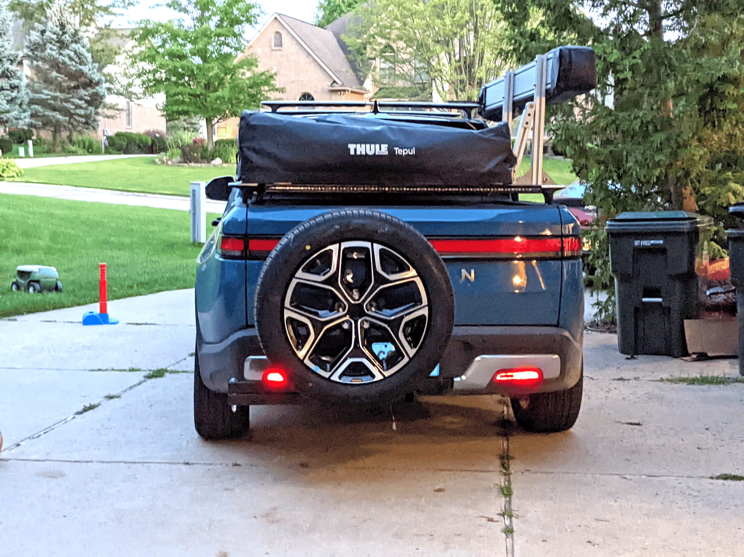

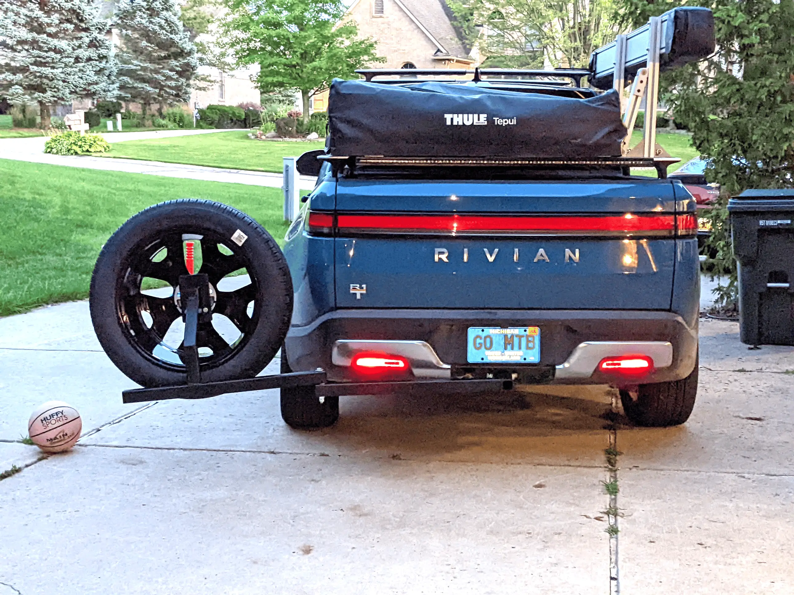

I decided to build one of these since I couldn't find anything on the market that really satisfied what I was looking for. I wanted the spare out of the bed so that semi-permanent camping setup wouldn't have to get dumped on the side of the trail/freeway if we ever get a flat while we're going somewhere to camp. It didn't turn out quite exactly how I envisioned it, but it's definitely serviceable. It sort of tucks in where there is dead space between the truck and the tent when it's open. Bed is fully accessible.

I've tightened everything up a bit further since these photos, but it's night time now, so hard to get a good photo of it. Trying to come up with a solution to relocate the license plate right now.
I'm debating setting it up so I'd be able to also have a hitch bike rack on the swing out part, but I don't think it would quite work the way I'd want it to with the tent.

Goodness that wheel/tire is huuuuuge.
Yeah, they always look bigger when they aren't where you expect them to be. It definitely complicated designing this thing in order to keep it from obscuring my light bar. I welded one thing backwards so it's about an inch lower than I really wanted it to be. Also have plans to try to bend the tubing on the end so the pivot is tucked closer to the truck. Sort of a trip hazard right now.

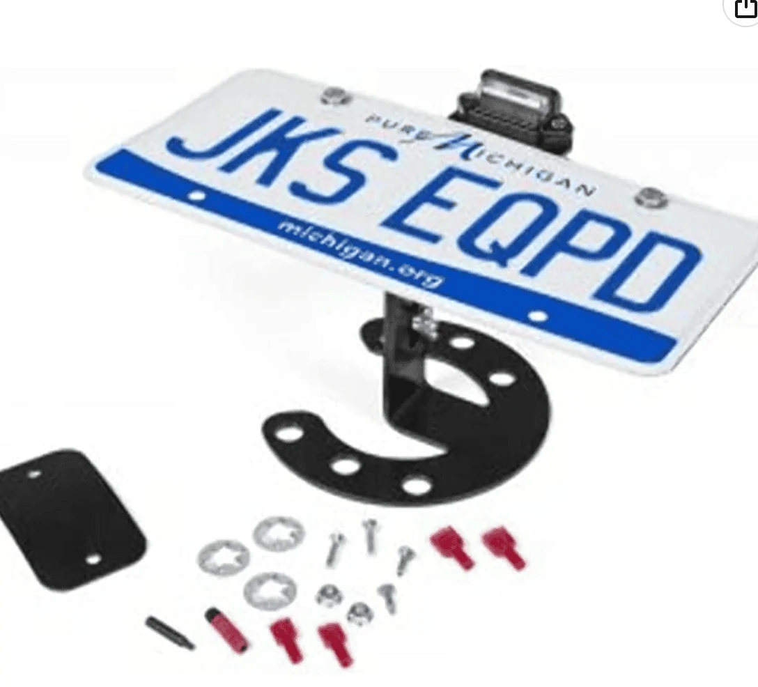

Police some areas will pull you over due to the obstruction of the license plate
Michigan has an exception for "sports equipment" One could argue that off-roading is a sport.

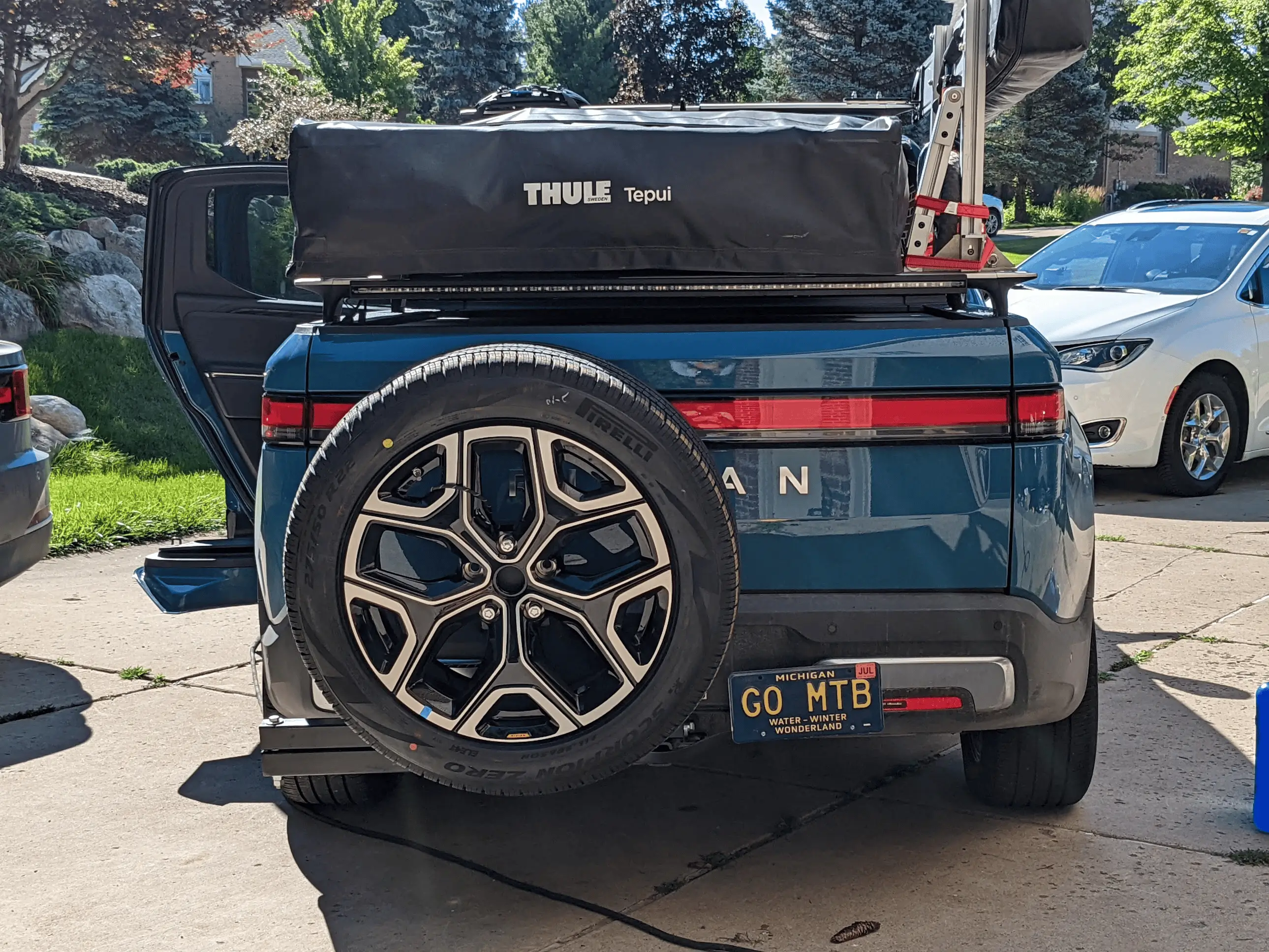

I just took a strap of metal and screwed it into the carrier to hang my plate off. Should be legal now in states that don't have a loophole.
Rivian R1T R1S DIY Hitch mounted spare tire swing-out carrier for R1T 1660228074450
Zip-tied to one of the horizontal bars on the left side?
I had a buddy that took a photo of his plate, printed it on a good printer in real size, laminated it and mounted it on the back wheel. Looked good and he never had any problems with it (left the original plate where it was)
Kit with light to mount the license plate on the spare - Amazon $54. I've seen this on some Jeeps.
Rivian R1T R1S DIY Hitch mounted spare tire swing-out carrier for R1T 1660231543063
Blueassassin
Allen
Apr 5, 2021
1,439
2,649
il
Equipment Manager
Did you add a third brake light as well on the cross bar?
