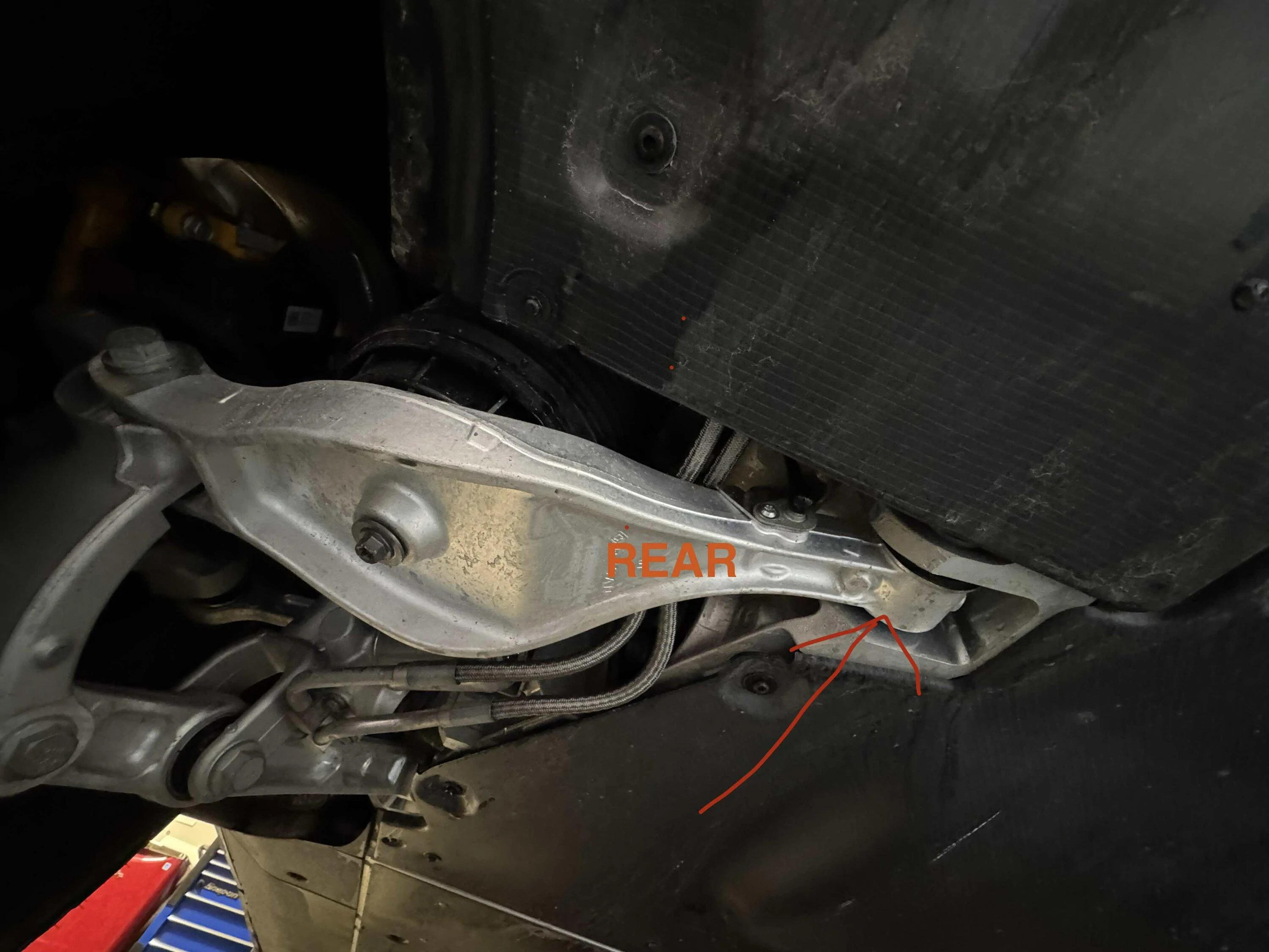

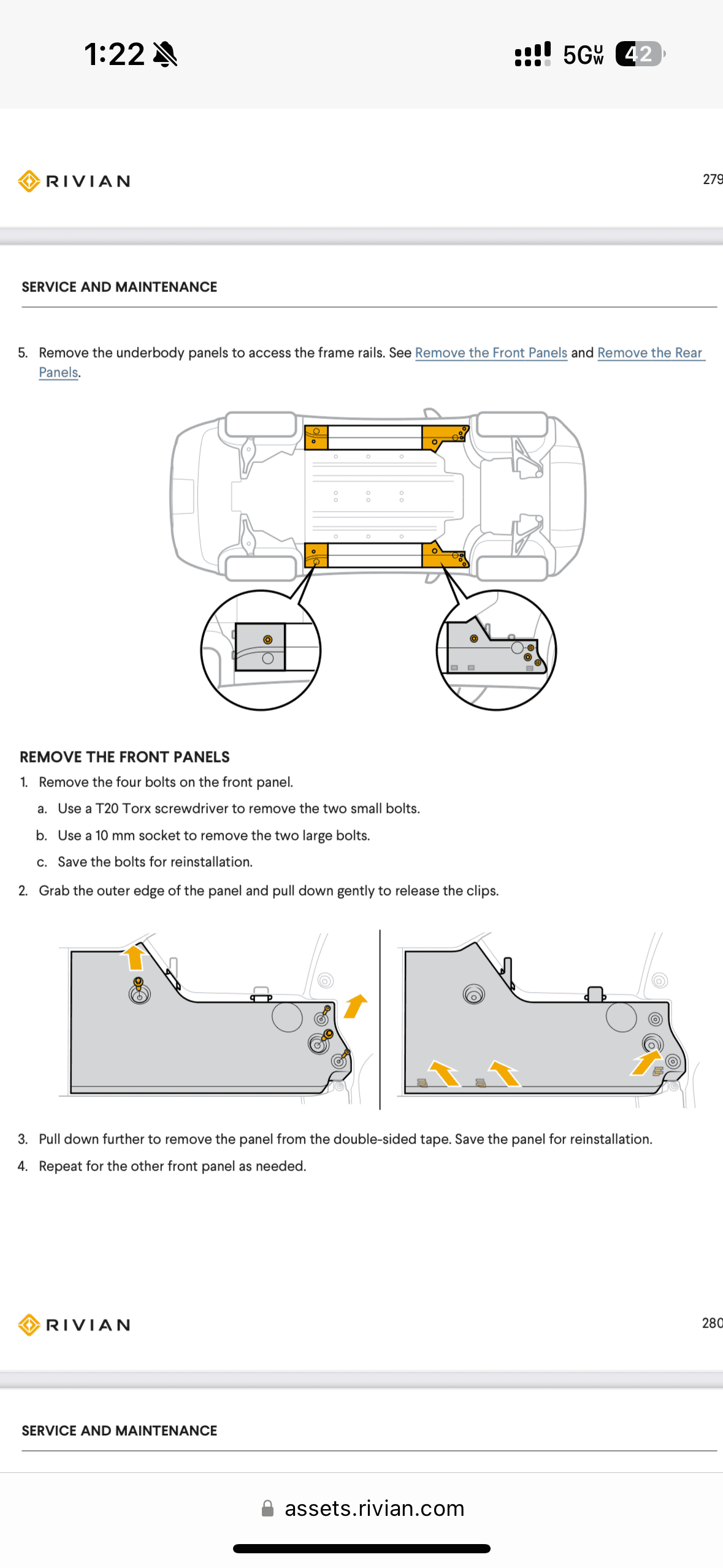

Check my 20 inch wheels. No suggestion at all that they are directional. I know I can remove parts of the underbody cover to expose the frame and use part of the frame for a jack stand.
What about the where the control arm attaches to the frame?

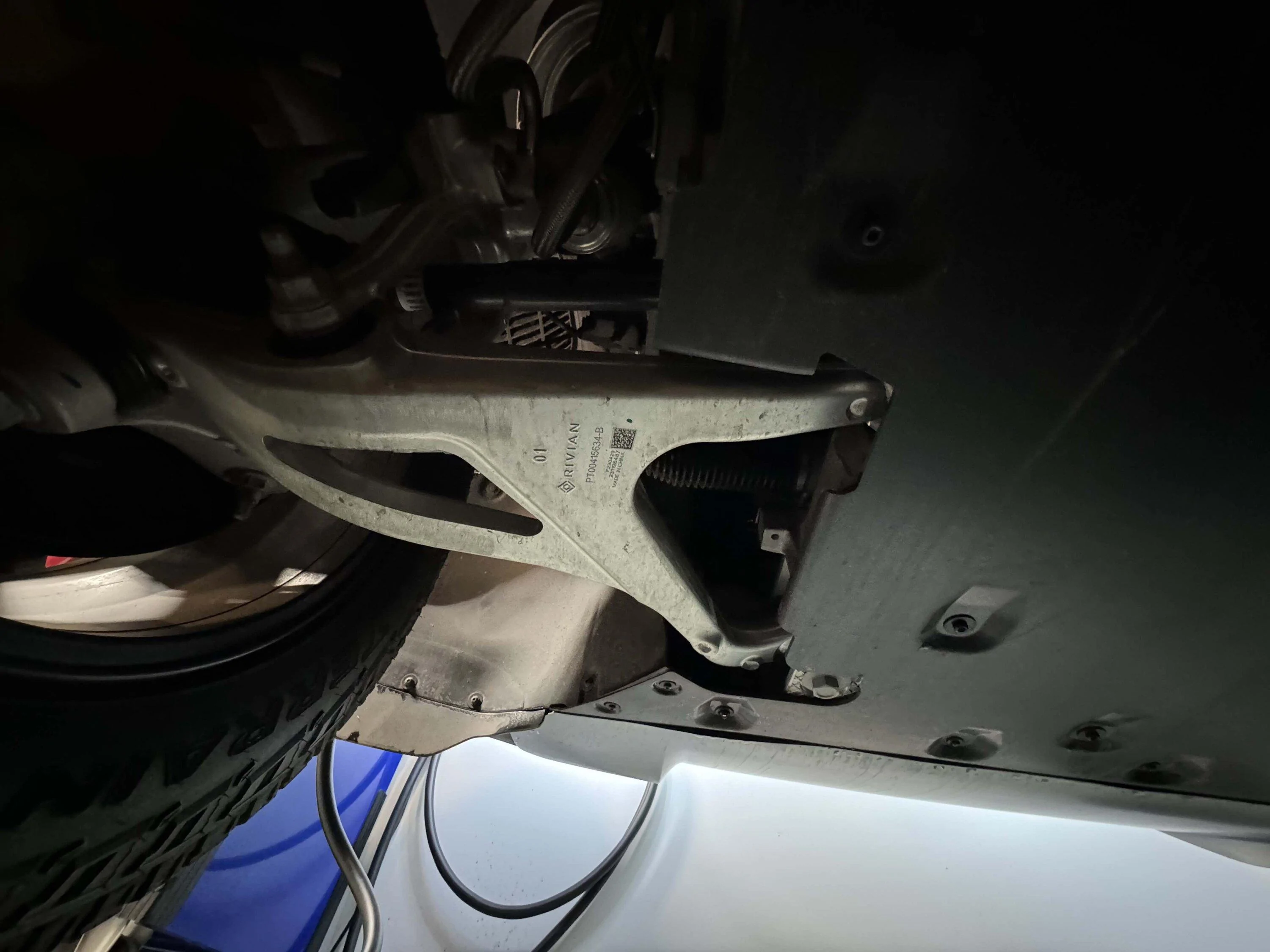

I have decided to just remove 4 panels under the car and use one floor jack and four jack stands.

So, I finally did do my own tire rotation on my R1S. I did it a little different that I have seen it being done using one floor jack and two jack stands. Here is my video.
